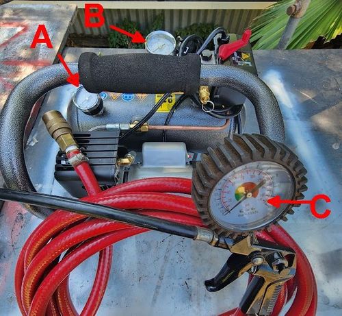

G'day @ALimestoneWall
"Is the "regulated pressure gauge" equivalent to the pressure of the tyre when it's connected to the hose?"
The regulated pressure gauge is measuring the pressure at the hose outlet - this is set by you. The advantage of this is, for example, you want a really low pressure to clean out a computer tower - the pressure is set by you with the regulator dial. The other gauge seen on the AEG on the left, is the tank pressure gauge.
The tyre pressure will be read with the inflator dial, which you need to buy - seen in @MitchellMc 's post above.
A smaller Senco air-compressor.
A = Tank pressure.
B = Your regulated pressure.
C = Will be the tyre pressure.
