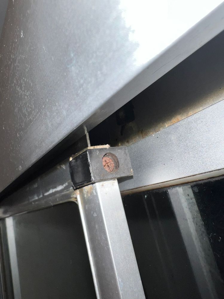

Looking for help please on a product at bunnings to buy to replace this rusted metal piece, clips onto the sliding door it’s all rusted up

Hi @RenoFun,
That metal piece is likely a proprietary part of the sliding door system, so the best chance of getting an exact replacement would be to contact the manufacturer of the door kit directly and ask if they offer spare parts.
That said, from the photo it looks like the rust is reasonably extensive, but it may not have compromised the structural integrity of the bracket. If it's still solid, you might be able to remove it, clean off the rust with a wire brush or sandpaper, treat the surface with a rust converter, and then finish it with a few coats of spray paint. If it's structurally sound, that should restore its function and freshen up the look as well.
Thanks Mitch! i took it out and will give it a go with your instructions
Sorry, @RenoFun.
That looks more deteriorated than I thought, given that it's missing that section. I would suggest that it likely doesn't have much life left in it. What purpose does it have on the door, and is it still fulfilling it? If you are not able to obtain one from the manufacturer, you might need to have one custom-made.
ah yes it has deteriorated quite a bit, it’s just used to clip onto the second sliding door to completely close the shower (the shower has 3 small sliding doors that clips on together.

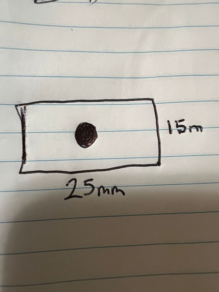

Hi @Noyade , Thanks for reaching out... the black square rubber is underneath the small piece of metal (below is the same piece behind from the other slide door.
Hope you recover from covid !! take care !
The depth of the piece of metal looks just 2-3mm
Thank you !
Yep - getting better thank you.
I didn't appreciate how small this is based on your photos above.

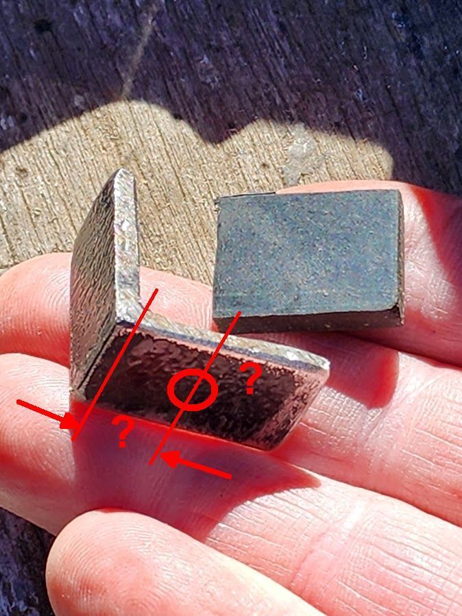

Here's the first prototype.
I went with angle iron - that's what your photo appears to be. I was thinking aluminium but maybe there would be little strength left with the size.
It is 25 mm X 15 mm each side. Outside dimensions - not inner.
3 mm thick.
The rubber is 5 mm. Is there rubber on both sides?
What is the thickness of your aluminium door moulding?
What size hole?
Cheers!
oh wow !! thank you the hole size is just a normal screw, i measured the screw length and it was 40mm long so need to get an untrusted one, no rubber on both sides just one and aluminium door moulding: the screw goes in around 2-3cm deep

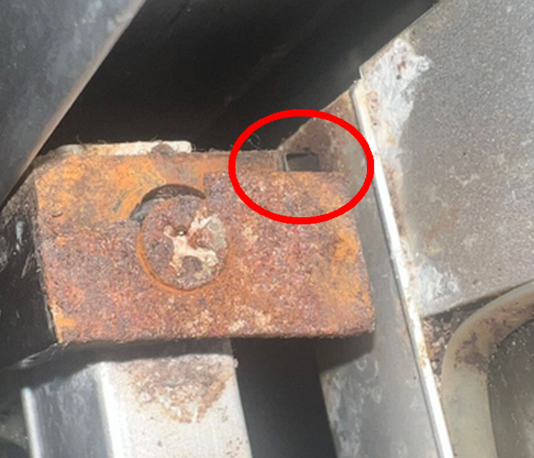

hi @Noyade glad you are feeling better, the last photo i took shows the second sliding door without issues, the first sliding door has a small plate that sits over that “L” shaped rubber which isn’t broken, so just needed a small piece of metal, sorry for the confusion

I made another cut just now. This time 5 mm thick steel - so I can make a good countersink.
If I drill (5mm dia?) 10 mm from the edge - dead centre - this leaves a 5 mm 'lip' on the other side to catch the door?
Is this correct?
Below is 25 mm X 16 mm X 5mm...
