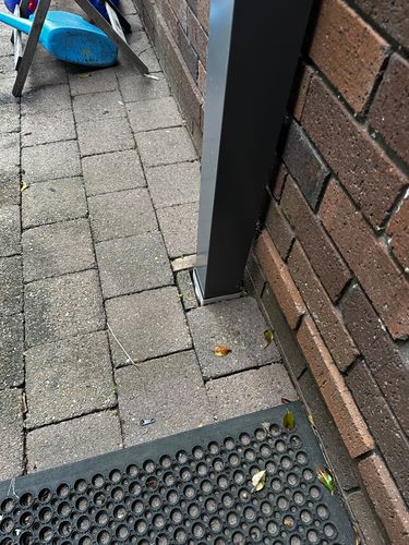

looking for some advice regarding a stormwater issue around the house. First, when it rains heavy like it has recently, the downpipe at the connection to the in ground pvc backs up and pours out around the fitting. There is another pit in the middle of the paved area nearby but don't like the idea of water backing up against the exterior wall.. Is this the correct way to connect the downpipe or would a grated pitt work better? I think the ground pipe is clear and flowing ok I checked at the inspection cap.

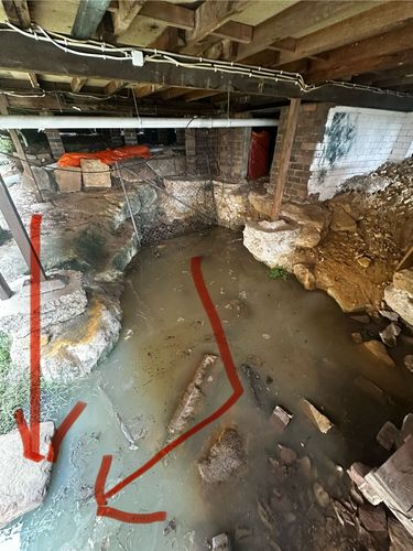

The bigger issue is under the house, the previous owner dug out a hole in the sandstone bedrock. During heavy rains the hole fills with water that comes through pourous areas in the sandstone up slope. It does drain quickly within 24 hrs after. I want to level it out and add pavers how do I divert the water away from under the house? I believe its a bit lower then at the front corner of house where I can connect to a stormpipe running down the side of property. Is it worth contacting an Engineer to find a solution and leaving this to the pros? Thanks in advance.
