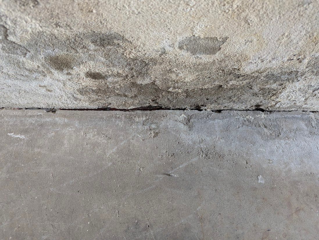

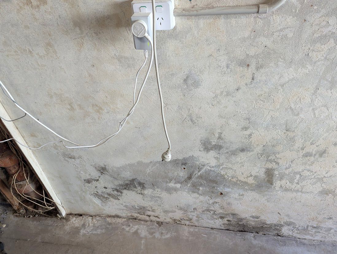

Backstory - 1970s townhouse that has suffered water ingress between the common wall due to roof leaks. Common wall is rendered brick. Most recently the garage floor flooded due to blocked stormwater drain under the common wall, resulting in water entering from the gap between the wall and the floor. These have now been rectified (touch wood). The water damage has caused the pipe boxing to degrade, mold on the paint and the render to flake, which I have stripped back.
A few questions I would greatly appreciate some advice and suggestions on:
1. Fixing the gap between the wall and the floor? Shelleys no more gaps for brick and mortar? Gripset Betta Concrete Crack Filler? Something else?

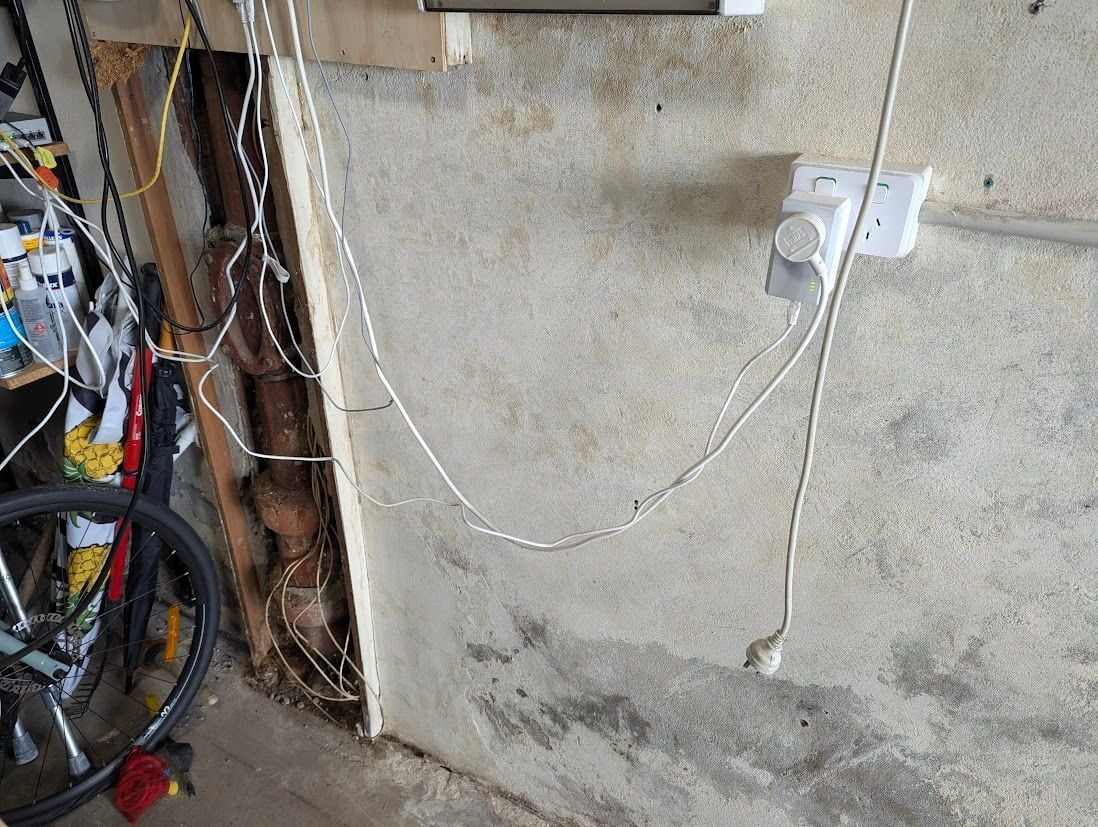

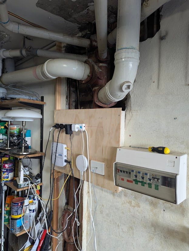

2. Repairing/boxing the unsightly pipes. Expanding foam to try and fill it in then plaster? Just box it in? One option I was considering was incorporating the boxing into the shelving.

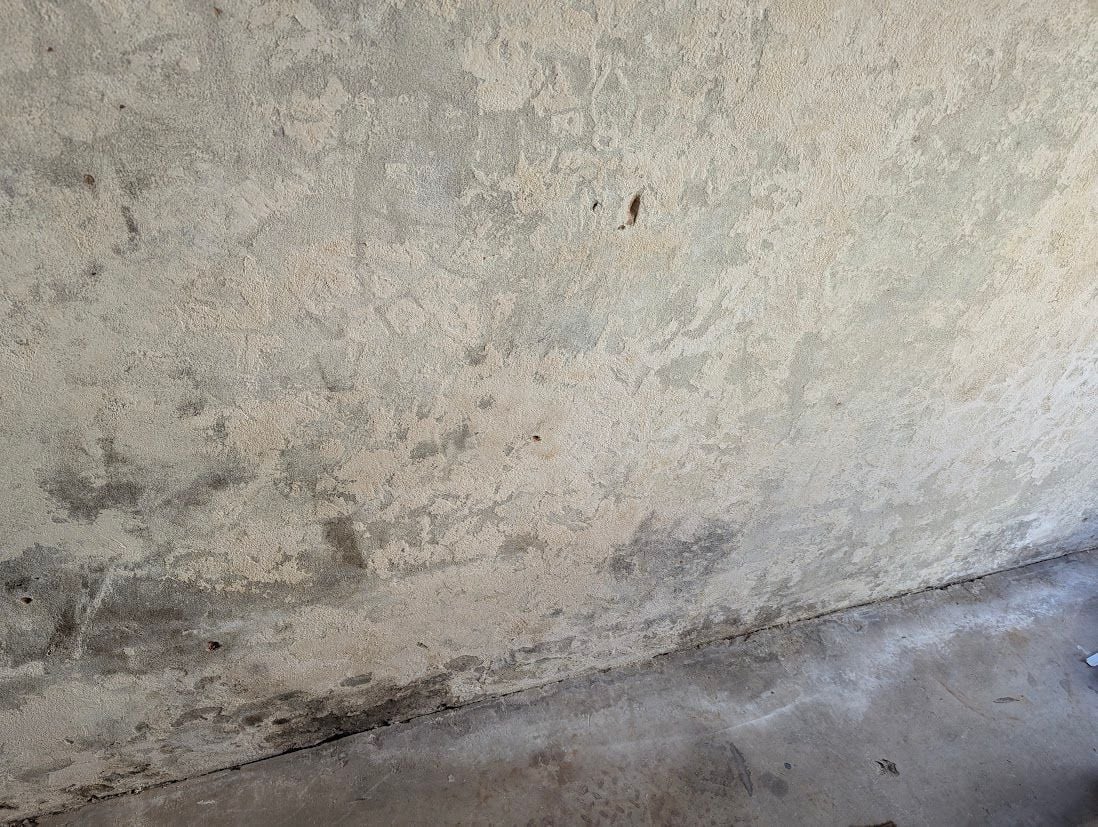

3. My plan is to install a desk and shelving on this wall. Plaster it myself, or just get someone in to put plasterboard up?
