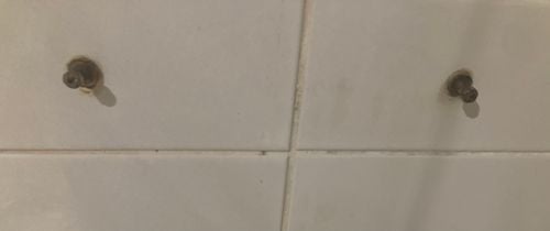

How can I remove these screws (possibly wall anchors) from the tiled wall?
This is in a shower and there was previously a soap holder there which broke.
I cannot make them budge with a screw driver. I have tried using a drill but it also doesn’t move them - when I drill one of them, the other one also moves and the drill slips/skips. As it is a wet area I assume it has rusted/corroded behind the tiles.
any ideas on how to can get these out without damaging the tiles?
