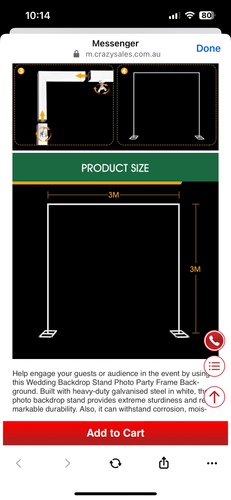

I have part of a sign stand where the metal is not stable on the bottom and is bending/ detaching. What could I use to secure it?

I can’t do that because the other piece has to slide on top. Could I use a no weld glue or araldite?
