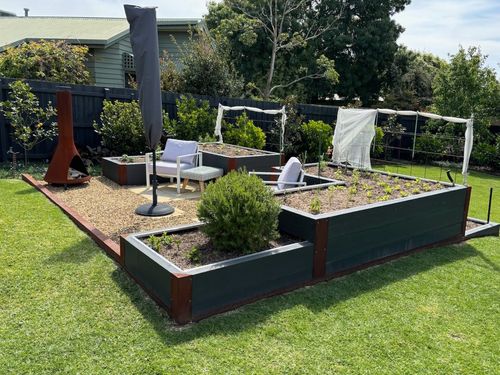

as long at the actual chimena os off the ground, standard 40mm pavers of what ever you choose will be fine. My steel one gets regular use and is about 3yrs old with no sign of any damage to my 40mm pavers it sits on surrounded by river pebbles.

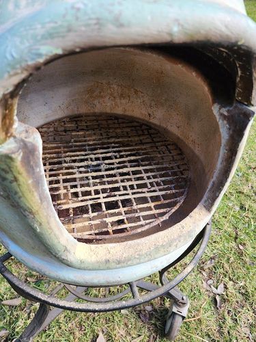

I just got some scrap metal, which included the top of an old gas cylinder and welded them together.
Placed at the bottom.
On top of it - old Weber grills.
I only use barbecue briquettes @David12 - what I found is/was as the debris of the briquettes built up to around 75 mm - there was no need for the supporting structure - there is enough protective insulation with the 'dirt.'
My neighbour bought the same chiminea but fired it with wood - and it shattered into pieces.
Cheers.

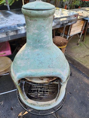

G'day Eric @EricL and @David12
We both bought our chimineas from a dying Masters on clearance. They were supposed to be pizza makers.
I cannot remember the instruction sheet but vaguely remember the boxing had a photo (CGI?) of wood being burned.
My neighbours shattered - mostly the top component - using wood. I think he put house bricks on the bottom.
I learnt from that and have just been using briquettes since. My experience is with the 'dirt' barrier in place, it's not the extreme external bottom that gets hot - it's the sides and funnel area. Remembering this was meant for pizzas - with the lid kept insitu.
These days I sometimes cook with the top removed with a very large pan above the heat.
I also installed wheels on the frame.
For warmth on an extremely cold night - useless.
Cooking pizza - even more useless.
If it's for warmth - I'd be looking at metal - something like @Nailbag has above.

That looks a great pickup @Noyade. Love the option to cook wood-fire pizza's. Much better than my stone in the weber for flavour. My fireplace @David12 definitely gives off great heat as mentioned being coreten steel. Plus the chimney design which I particularly wanted keeps the smoke away once up and running.
Regards Nailbag
