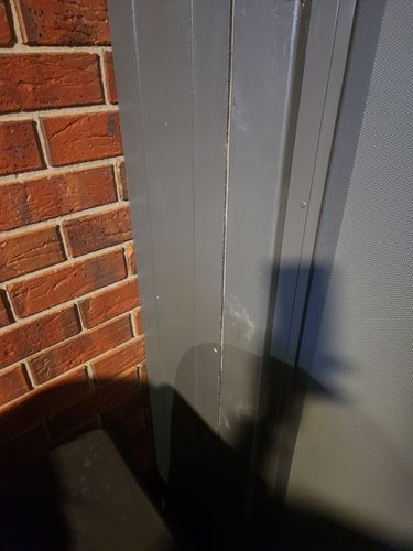

Hi guys, just looking for some ideas to help with making the exhaust pipe not as hot, it will be going outside under an outdoor blind and just dont want the kids touching either either

Hi guys please see photos. We ideally dont want to have the outdoor blind up...could we some how get the exhaust pipe out of this wooden wall to the outside?
@EricL @AlanM52
Thank you for posting those extra pictures. I propose using an Exhaust Wrap 2" X 15', Fibreglass Black W/Stainless Ties - CAL-H1011BK. Built for automotive use it should provide excellent insulation and lower the outside temperature of the exhaust pipe.

Your scenario isn't ideal as the only real way to protect the wooden wall is more distance between the exhaust. But that mean lifting the blind which opens up its full width.
The Exhaust Wrap 2" X 15', Fibreglass Black W/Stainless Ties - CAL-H1011BK @EricL suggests will significantly reduce the radiant heat and definite;y something you should apply. Then its a matter of closely observing the surrounding area for heat damage.
For an alternative solution, you could combine the wrap and lift the lid a little more. Then fill the gap with a few door snakes. Just keep its distance well clear of the pipe.
