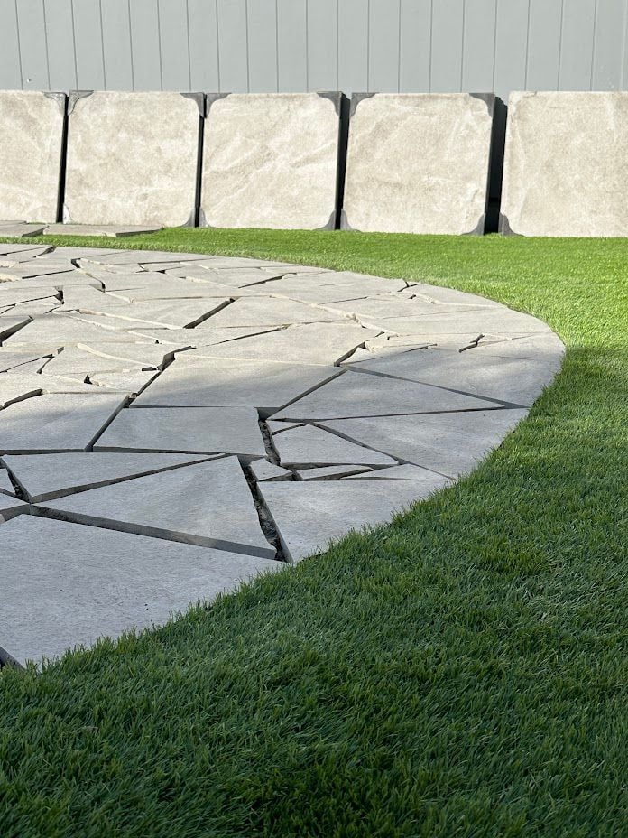

If like me you have a circular space that you are paving, work around the external and slowly fill the internal as shown.

Now this part is controversial to a degree; some like to wet grout the pavers, however I wanted to try dry grouting, so I used a mix of three parts white cement to one part sand. This enabled the pavers to remain intact but gave them a very rustic look. To complete this process, mix your ratios in a wheelbarrow and then tip it onto the pavers, broom the dry mix all around from side-to-side, in a circular motion, back and forth. Repeat this process until you can see that every little gap has been filled.
