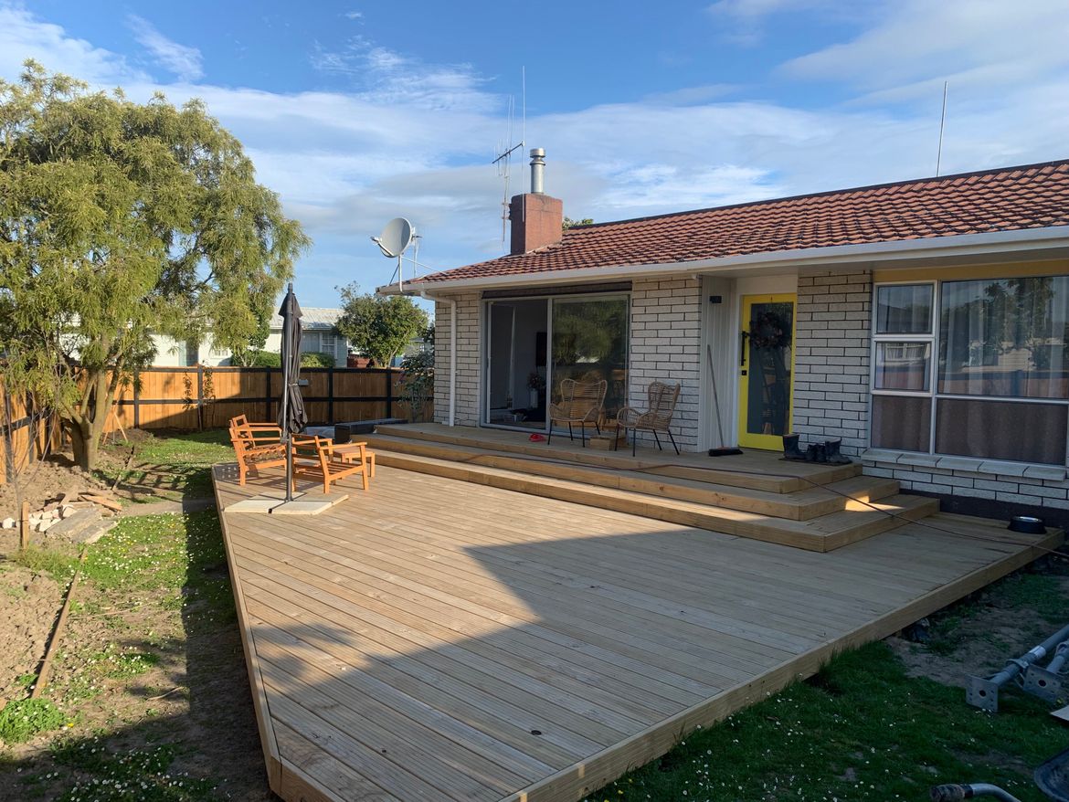

A front yard makeover creating an outdoor entertaining area with a large 7m x 9m low-level timber deck and steps to the home's front entrance.
From lawn to an entertainers paradise large deck
The project
A massive undertaking we decided to turn our mundane front yard into a 7 x 9m low-level deck, with full length steps up to the house. Amazing for entertaining in the summer.

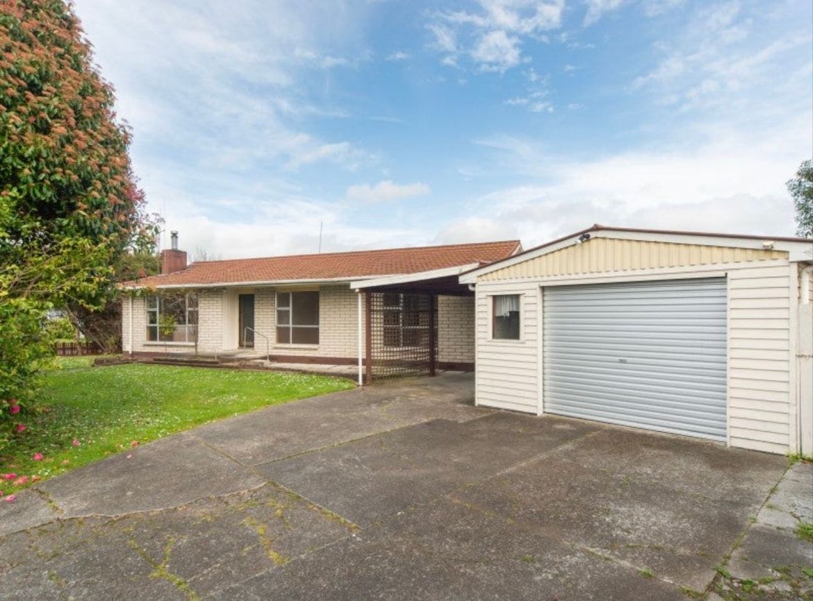

Before shots:
Steps

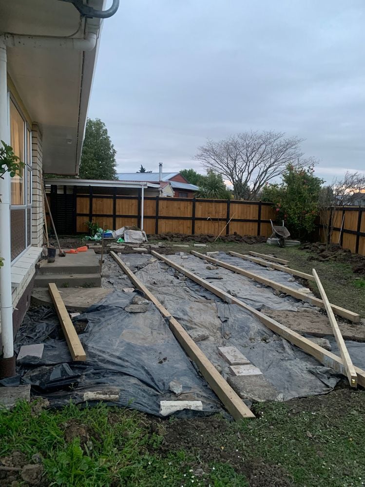

Measure out the area and distance between holes. Dig holes and put in piles, making sure they are straight and level. Fill with concrete and leave to harden - best done when no rain forecast. Cut and secure bearers to the piles.
Step 2

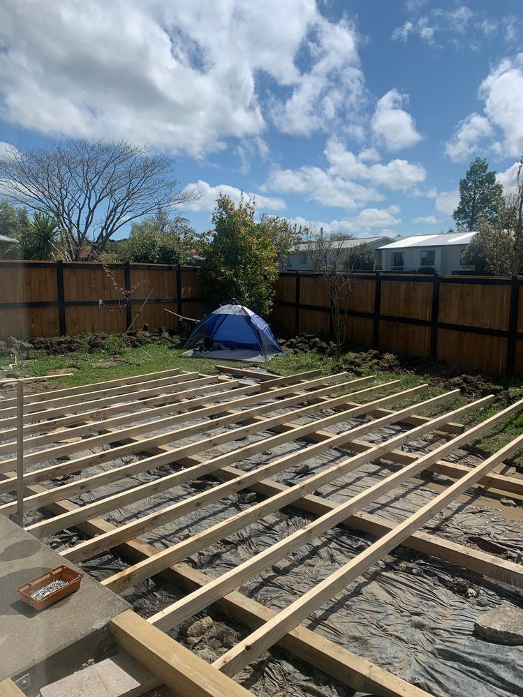

Secure joists to bearers - 400mm spaces between joists.
