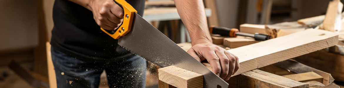

Hand saw
The classic hand saw has a broad blade with large teeth and a handle at one end. It’s usually about 45cm to 55cm long and comes in different tooth sizes, which affect how smooth or rough the cut will be.
A hand saw’s larger teeth cut quickly but leave a rougher edge. Because it doesn’t need a power source, it’s reliable and always ready to go.
A hand saw is perfect for cutting framing timber, plywood, decking boards or fence palings. It’s also great for general carpentry and D.I.Y. projects where speed and practicality are more important than fine detail.
Use a hand saw when you need to make long, straight cuts in large timber and don’t require high precision. Compared to a tenon saw, it’s faster and can cut deeper, but is less accurate. If you’re building a deck or framing a wall, a hand saw is your go-to. For fine woodworking or joinery, switch to a tenon saw.
