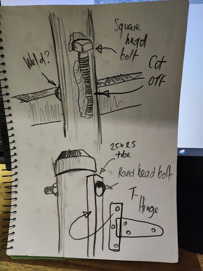

Hi @jzb02
Looking closer at the photo you posted - there appears to be a bolt welded to the pole? Any idea why?
I was thinking of cutting this off and bolting something like 25mm square tube to hold the T-hinge.

The round post is quute heavy metal and secured in concrete. The previous gate was seem like welded with screw on this post. I am thinking probably a flat post secured to rpund post and then attach the gate to flat post with screw in hinges.
Yes.. a light weight galavnised flat tube frame gate.
I think the old screw is from previous welded gate. Its very heavy round post tho. I like your idea and i think this will be more straight forward and long lasting too. Thank you so much. Yes the fence flat post is welded onto round post but enough space to screw a bolt.
Must say : you drawing skills are great. Thanks
