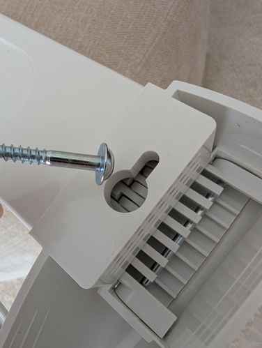

I'm hanging a Leifheit Telegant wall-mounted dryer (https://www.amazon.com.au/dp/B000JG1KP4/ref=cm_cr_arp_mb_bdcrb_top?ie=UTF8) It comes with two screws fixing into brick or tile. I am going to be fixing to a fibre cement laundry wall. Hoping for a stud but not guaranteed. The screws have an unthreaded bit at the top like a wood screw and then like a Truss head. They need to sit about 2cm out of the wall when fixed because the dryer has a key hole type mount. So the question is, what type of drywall anchor might be suitable in this scenario?
