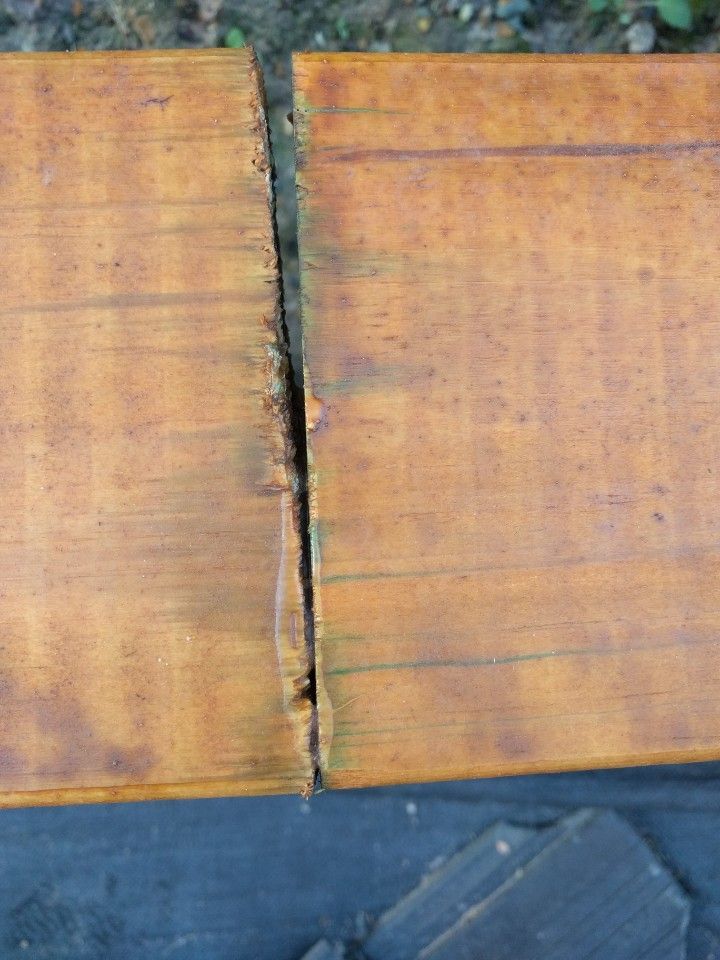

It was my first to make a retaining wall with caps on.
I am just wondering if there is any way to fill up the gab between caps and paint it over.

Hi @dogbural , issue you'll have is expansion & contraction of materials (both the cap & the wall).Any sealant will need to be flexible and you'll need to fill at a time when the materials aren't too beyond average (i.e. - not on a really hot or cold day or after timber has been in sun for hours).
It's not ideal as the paint will likely crack and there will be either bulging or stretching of the sealant.Personally... I'd just aim for nice clean joins, leave them a couple of mm apart as expansion is the bigger problem and live with it.

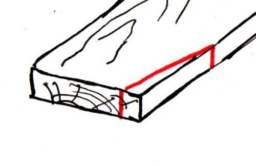

Could you slice off a 'wedge' shaped piece of hardwood the same thickness and insert it into the gap with a flexible glue/sealant?
