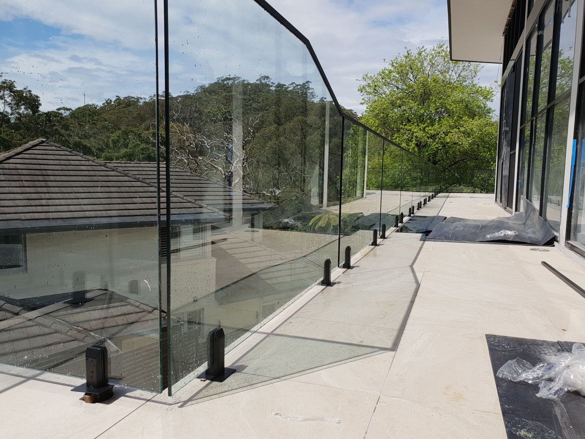

Hi @longonly This post is a bit old but I thought maybe I should add this for anyone else browsing this thread.The key things you need to consider are:1. Do you need toprail? In NSW you are legally required to have toprail or hand rail for any balustrade that has a fall of over 1m2. What sort of surface are you installing on?If the surface is concrete, then you have the option to core drill your spigots in using core drill spigots. You will also need a 76mm core drill to make this work, along with a kwixset type grout.If you are installing on decking, then you can use deck mount spigots which are easily installed using stainless steel bugles.Balustrade glass is generally 1000mm or 970mm high depending on where you source the materials from. Basically the balustrade will need to be over 1m tall. I believe the panels at Bunnings are 970mm high. This is fine as the spigots are generally over 30mm above the ground level, thus the overall height of the glass will be greater than 1m.Other than this, you have some options on the type of finish you are going for. The common types are Chrome/Polish, Brush/Satin or more recently the matte black type of hardware.(C) Avant-Garde Glass**The usual disclaimer, this post is for information purposes only and not to be taken as specific advise for your job. Please research further the specific balustrade regulations for your location/project
