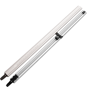

Dowel Jointer - Mafell is the gold standard while the Triton is affordable.
Triton 600W Dowel Jointer Duo TRI-TDJ600
Pro-
Will work with the notched Mafell rail.
Nice repeatability of drilling holes that will line up.
Easy end and edge drilling.
Cons-
Price of Mafell rail if you can find a place willing to ship down under.
T-joins take some setting up.
8mm standard drill size, in 16mm board that is just 4mm meat each side.
But wait there is more, minimum drill hight is 9mm so 2mm one side and 6mm the other along with needing to be more carefull with alignment.
Fix is shim the top plate so you can get 8mm height.
So while your fixing things why not get a drill that would let you use 6mm dowel and you could drill shelf pins as well... Only Mafel make a 6mm drill and you guessed it they are expensive, in fact Triton have just 8, 10 and 12mm drills available and if you stuff up one your back to importing again.
There has to be an easier way!
