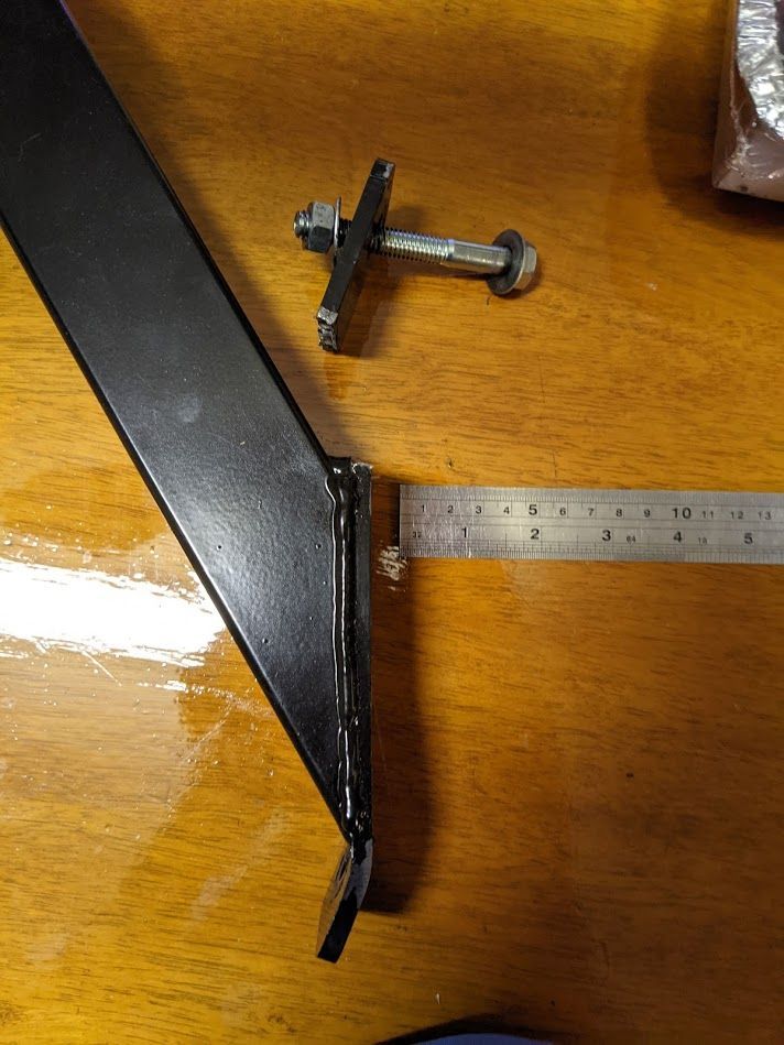

My boxing punching bag stand broke. The metal snapped off and another part of it bent. It's quite thick, is this something a beginner can repair weld? Or should I just bin the whole thing?The part that broke/bent, is the bottom part of the diagonal tube (that holds the punching bag).The bottom part of the tube connects to the rest of the frame with two bolts.

A beginner welder could repair this, and it is potentially an excellent project to start with if you were interested in welding. Is there any chance you could borrow a welder, or perhaps someone you knew could assist you with the project? If not, I'd recommend having a look at our welder range. Even the base model Ozito 140 Amp Fan Cooled Arc Welder would be sufficient.
I'm not proficient at welding by any means, but I would presume welding that arm directly to the upright would be the most secure way of repairing it. Alternatively, you'd need to weld the top tab back in place and then try to straighten out the lower tab. Since this has broken once, it would be advisable to add additional welding beads or bracing to ensure it doesn't happen again.

"welding that arm directly to the upright would be the most secure way of repairing it."
I'm with you Mitchell - I personally would forget about welding that tab back on and instead weld the angled arm directly onto the upright, at least on three sides as I've illustrated below. Clearly there is a lotta stresses involved and metal fatigue has occurred so I was also thinking - remove that plastic end and weld a piece of plate that is then welded to the angled arm. Should then be able to beat the hell outta that bag with confidence and safety.
Drawbacks include having to repaint all the burnt surfaces and that "connection" is now permanent and I'm not sure if that is of a concern to you Mr Browser in the future with regards breaking down the components and transporting elsewhere?

Thank you Graeme and Mitchell!Great advice. The transportability isn't a concern for me so I think your solution will be ideal. I'm looking forward to getting into welding now. Kind regardsJohn

Hello.Just Letting you know how it turned out.Super messy but quite happy with it, seems quite strong. Some of the welds just made a hole but I just added 2 more side plates to keep it strong. Cheers guys
I'd rather see a decent messy weld bead than a neat bead that hasn't penetrated @Wheresmy10mm. The bead where you have connected the diagonal to the upright is very impressive for a first-time welder; in fact, I'd say it's exceptional! It doesn't actually matter how messy a weld is. That's just aesthetical. The important thing is that it has good penetration of the steel. In the future, if the job calls for it, you can neaten the finish up with a grinder. I believe the old saying goes: A grinder and paint makes me the welder I ain't!
