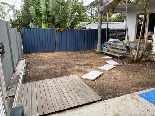

I’m currently in the research and planning stages to makeover my front yard area and wanted to cover the existing concrete porch with decking, extend it out and created a tiered decking to our gate area.
The new decking area is pretty straight forward, but it’s covering the existing porch that is the issue. It’s almost flush with the front door, about 25mil wiggle room at the moment but we could go another 15mm higher due to inward opening front doors that already has e a gap underneath (want to maintain the original hardwood doors that came with the house).
Wondering how I would go about attaching a frame to the concrete but also, is it even possible to do and still have room for drainage? We’re in SE Qld so we get our fair share of rain.
