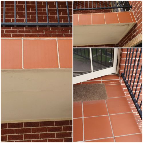

Not sure if anyone can help but all advice greatfully accepted. How do I lift/remove terracotta tiles of what I think is blue board/cement sheeting on an upstairs external small verandah. Will the timber frame be affected ??

It would be great to hear more about what your project entails and why you need to lift the tiles. We might offer some alternatives. I believe it is more likely that the balcony is some precast concrete structure and not clad in Blueboard. However, if it is, then there is a good chance you will damage the Blueboard whilst removing the tiles. You could either go about it with a hammer and masonry chisel or a rotary hammer drill.

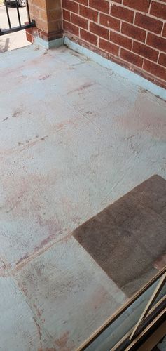

Thanks Mitchell I used a hammer drill and successfully lifted tiles without damage
That's very impressive, and I'm surprised you're not left with tile adhesive on the surface. Great job!
What do you plan on covering the surface with now?

I plan to paint on new waterproofing on what looks like existing waterproofing incase there are cracks. I then plan to refresh with new tiles.
Thoughts??
Hi @Arch3 - well done on getting those tiles up. They obviously weren’t laid very well. No disrespect to you, but they shouldn’t have come off that easy.
Looking at you pictures - are you sure that’s blue board? It seems to be a strange thing to use for a balcony. Anyway, you need to give that surface a good sand and clean before applying anymore products. Then investigate which tile adhesive is suitable for your new tiles - some adhesives are designed to go straight over waterproofing membranes - so make sure you choose one of these.THEN follow the instructions of the manufacturer of your tiling adhesive.
This will be the best way to achieve a good outcome for this project, cheers Deb 🙂

Yes tiles were very poorly laid (not by me I might add) both on our concrete slab causing tenting and on this small verandah. Thanks for the tips re preparation and adhesives.

Is the blue board secure and not vibrating? If it is it may need to be further secured to the current framing. Looking at your picture it seems like standard cement sheeting. But I could be wrong. I would definitely water proof the top before laying tiles. I would recommend Resaflex tile adhesive. It has the highest amount of polymers and allows for maximum amount of movement. So it should adhere well to the current surface. Please keep us updated as I'm sure other members are keen to see how your project progresses.

I've spoken to Crommelin technical to find out the correct method of applying a secondary membrane. I'd suggest you use Crommelin 15L PRO-300 WP Balcony and Deck Waterproof Membrane.
As @Mathy mentioned, cleaning that surface down would be the first step. I would then recommend you give the existing membrane a sanding to scuff up the surface with a medium 120 grit sandpaper.
You'll need to do a test section to determine if the new membrane is compatible with the old. Apply a 50mm x 50mm test section and wait for it to dry. Take some sticky tape and run it from the old membrane across the new and onto the old membrane. Rip the tape back off. If the test section pulls off on the tape, you must prime the old membrane first. Crommelin 2L Dampstop would be the correct primer to use.
You'll then be able to use a tile adhesive similar to the Dunlop 5kg Trade Resaflex Tile Adhesive @redracer01 mentioned.
Please let me know if you need further help or had questions. I'll be looking forward to seeing your results.
