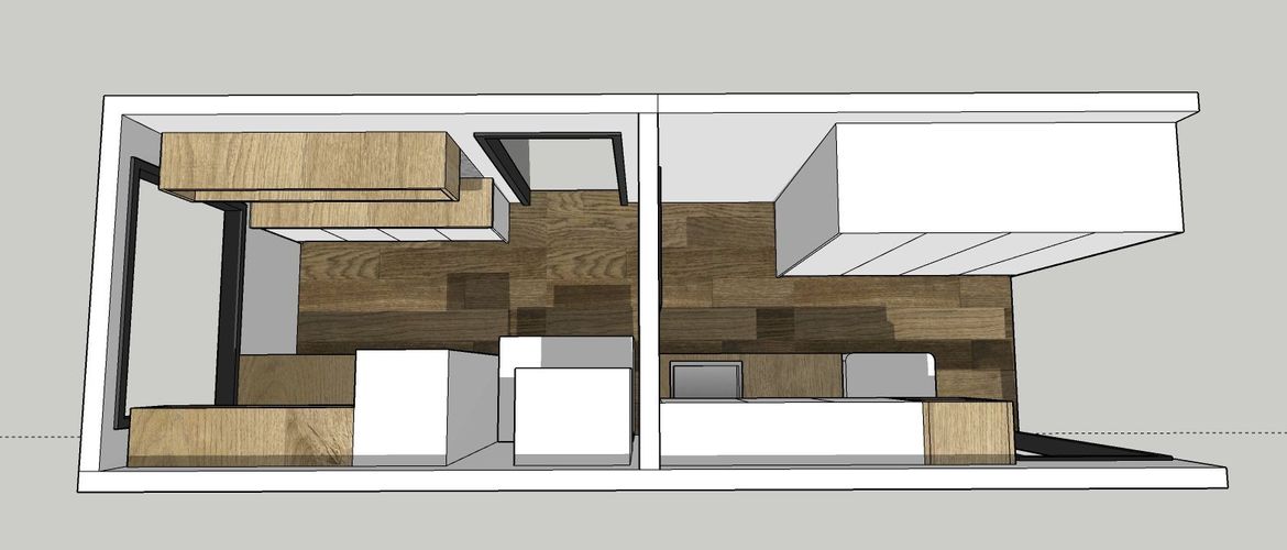

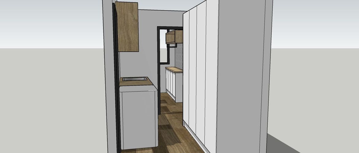

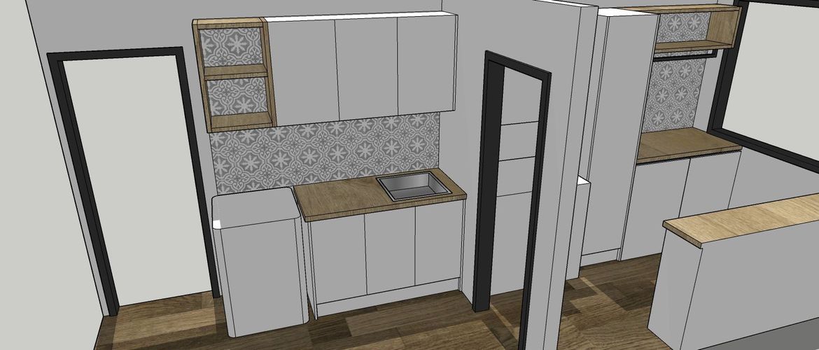

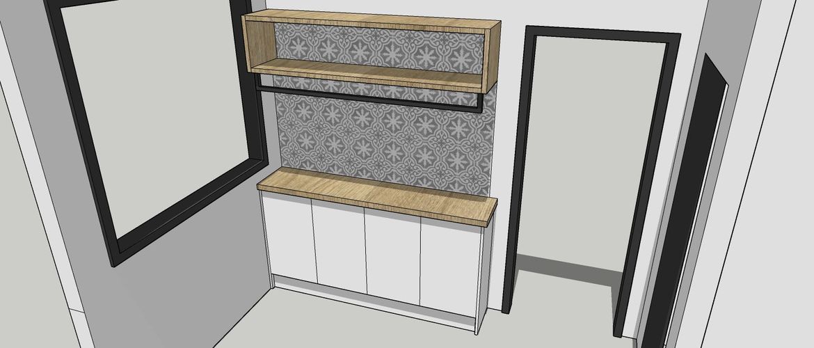

I'm sorry to hear that the Kaboodle software is proving difficult to use. But to save you from all that grief, I've drawn you up some basic designs that I hope will help you revamp your laundry.
- The first picture with the shallow cabinets are actually wall cabinets just moved down. This will still give you storage space and not take up so much room. I've converted your pull out drying rack in to an open shelf with a facility to place hangers. By using hangers you wont have that same problem of over loading compared to the pull out drying rack. The wall fan will have to be taken out and transferred someplace else.

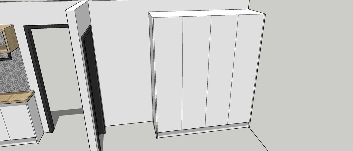

- The second picture shows full length pantry sets. Each pantry is 900 mm wide and is 2200 mm tall and 600 mm deep. These two cabinets should provide you with adequate linen and storage space. The gap I left near the pantry cabinets is for your brooms, mops and other cleaning items, the fold out drying must be stored here as well to create a clean straight look.
- The main laundry area has just been remade with the pantry near the laundry tub are gone to max out bench top space in the area.
- As requested the blue baskets are integrated in the design. Your portable ironing set will still fit in the middle of these cabinets but I would double check that there is enough space to make sure everything fits. Please have a good look at the layout, if you wish to move things around drop us a line here at workshop.

I have had a chance to have a good look, couple of things - the first room of the laundry has a slanted roof - the single pantry there now is 2 m high, a 2200 pantry isn’t going to fit there. The bench that exists in the ‘second room has to stay, it’s fixed in
