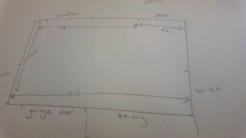

Hi there, completely new to all this, have been browsing all the posts with open eyes, super excited to have found this community. Have just bought a 2 bedroom duplex and looking to do some minor (I hope!), and budget (as plan to rent it out) renovations both to laundry and to living area (will post separately)
Will have a builder to assist but want to get a concrete plan down and potentially keep costs down by providing some of the materials etc.
My current issues/ideas are
1. open up room with more light by changing door to light colored oak or similar with glass that opens externally to deck as opposed to internally now
2. light colored timber or similar laminate bench top to encase sink and washing machine, possibly a waterfall over the edge
3. issue with washing machine plumbing is it's set rather high so do I a) look for brass fitting and leave exposed and drill holes in the bench top or b) pricier I imagine, plumber to move and set lower than bench top?
4. we have a top loader but would be happy to replace with front loader to accommodate a bench top - but if kept would need hinged door on benchtop? and if we do a bench top do we limit renters options for their washing machine size etc? Our washing machine seems really high which would make the bench top a bit too high? it's 103mm.
5. would love a ceramic white larger than current sink potentially spaced over to the right, to allow floating timber shelves.
But with the timber shelves they'd protrude over the window
6. we're limited with storage space so wanted shelves/cabinetry below the sink - like the Bunnings options but not sure if the sizing will fit. Could we do timber shelves next to the door or would it be too tight?
7. our pantry is a whole other re do which I think i'll leave until we've planned the laundry …
Any suggestions, advice, ideas, products etc would be most appreciated, please let me know if you need more information
Ta very much

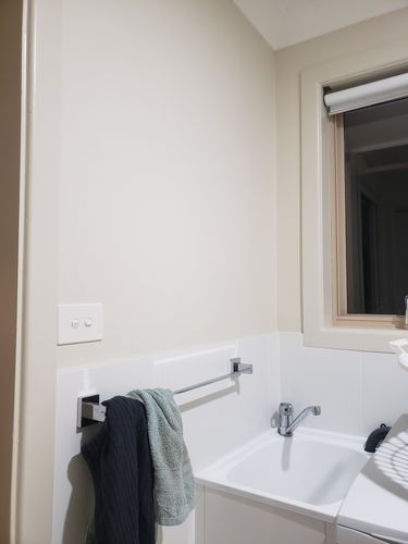

current sink and washing machine

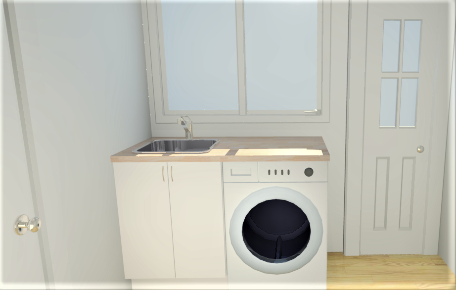

If you were to move the washing machine over you would be able to get a 600mm base cabinet in there. I can't quite see how your tap is fixed to the wall. Euro sinks normally have their tapware fixed to the bench as per the rendering below. If the tap still reached over the new sink I can't see why you could leave it where it is.
Ceramic inset basins can be quite expensive. The choice of stainless steel or ceramic really comes down to personal preference.
There are not too many places I can see shelving fitting that wouldn't be at a perfect height to bump your head on. There doesn't seem to be enough space above the sink to the left of the window and likewise, if you were to locate them on the other wall next to the door egress is going to be obstructed. If you were thinking somewhere in particular I would be happy to add them to the render so you can see for yourself.

Here's a better pic of the tap. I'm not really sure where to fit the shelves...any where that wouldn't be too problematic...we had thought of bricking in the door to change it to a window to add extra space. On the wall next to window would be best I think.

Here's another render with some shelves in the locations mentioned. You'll be able to see what I mean about them protruding out and limiting access. Your current mixer tap can be installed straight into a timber benchtop. Depending on where the plumbing work is on the wall you might be able to just simply swap the sink/tub for cabinet and euro sink.
