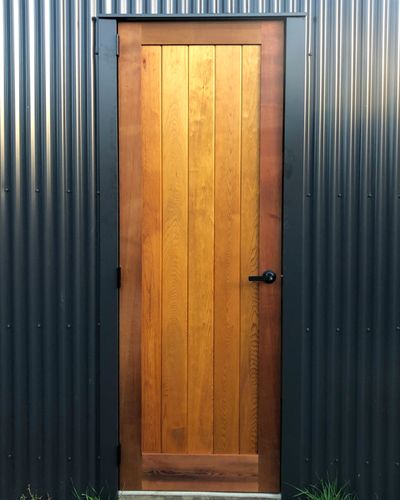

So we have a door! Isn't she pretty!?
This is the first of 4, barn style doors we are going to make for our shed and studio. This door has been a bit of trial and error but we are pretty happy with the result!
We special ordered through Bunnings 138 x 18mm Western Red Cedar VJ cladding and, DAR Western Red Cedar for the rails and stiles.
I've uploaded as many photos as we remembered to take along the way of the making process, but if you have any questions let me know. 🙂
Beautiful work @DIYgals. I love the style you're going with and happy to hear that there are more doors like this to come. It's going to look absolutely stunning.
We really appreciate the time you've taken to share the photos and details of your process. It's bound to inspire others in our community to give this a go.
Can't wait to see what you come up with next.

Love the door! Thanks for all the pics as well - great inspiration and reference!

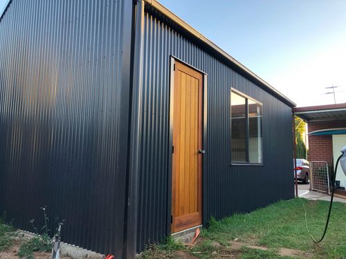

Hi, you have done a beautiful job on the door. I have a metal shed that I would love to transform into a garden studio and would love to have a door like the one you've made to replace the metal door already on it.
Can you please advise how you attached the wooden door to the metal frame. Did you have to do any modifications to the existing opening where the metal door was?

What type of frame do you currently have on your shed, and is it designed for a lightweight door? You might like to share an image with us. The frame on the @DIYgals shed looks particularly substantial and appears like it might be a direct bolt-on situation.

Most of the shed frame is build out of galvanised C-Section, however the doors and windows are framed with RHS. We didn't specifically build a frame to hold a lightweight door. We are planning to build much larger doors on the on the front of the shed. The RHS is strong enough to hold a much greater weight, however there will be 4 hinges for the door to cope with the extra weight and leverage.
Thanks @ChezzieG. This is a new shed, we have frames the doors and windows with RHS steel to have a square straight edge and used metal screws to attach the hinges to the steel frames. What frame do you currently have for the doors?

Stunningly beautiful result. The quality of the work is, as always with @DIYgals , outstanding.
