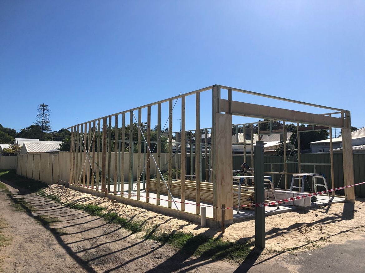

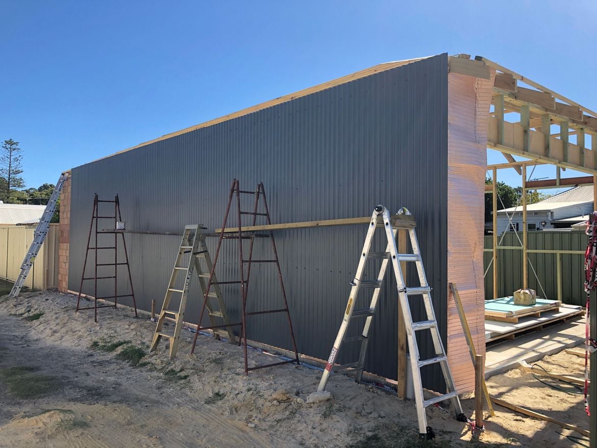

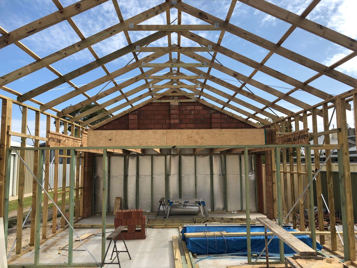

Constructing frames.

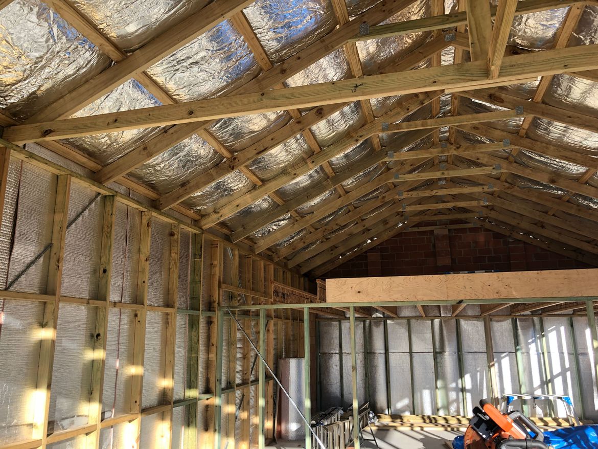

Frames up.

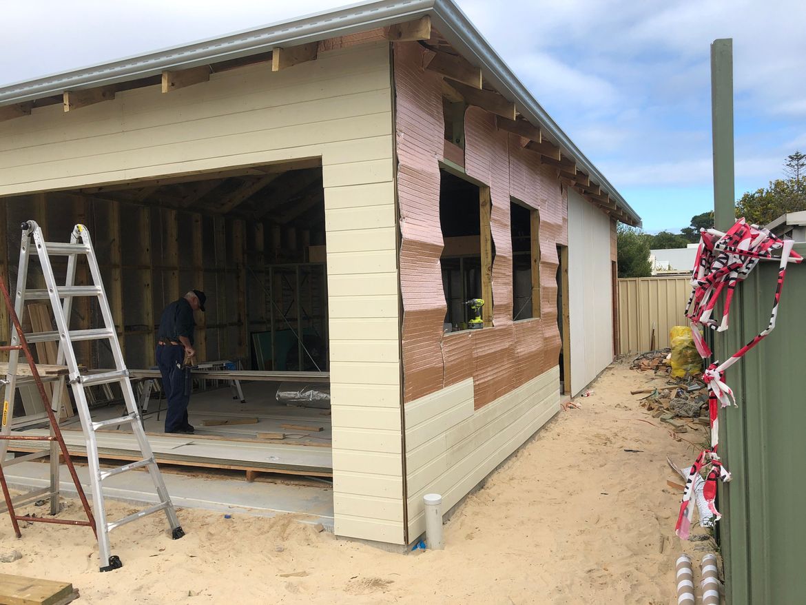

More cladding.

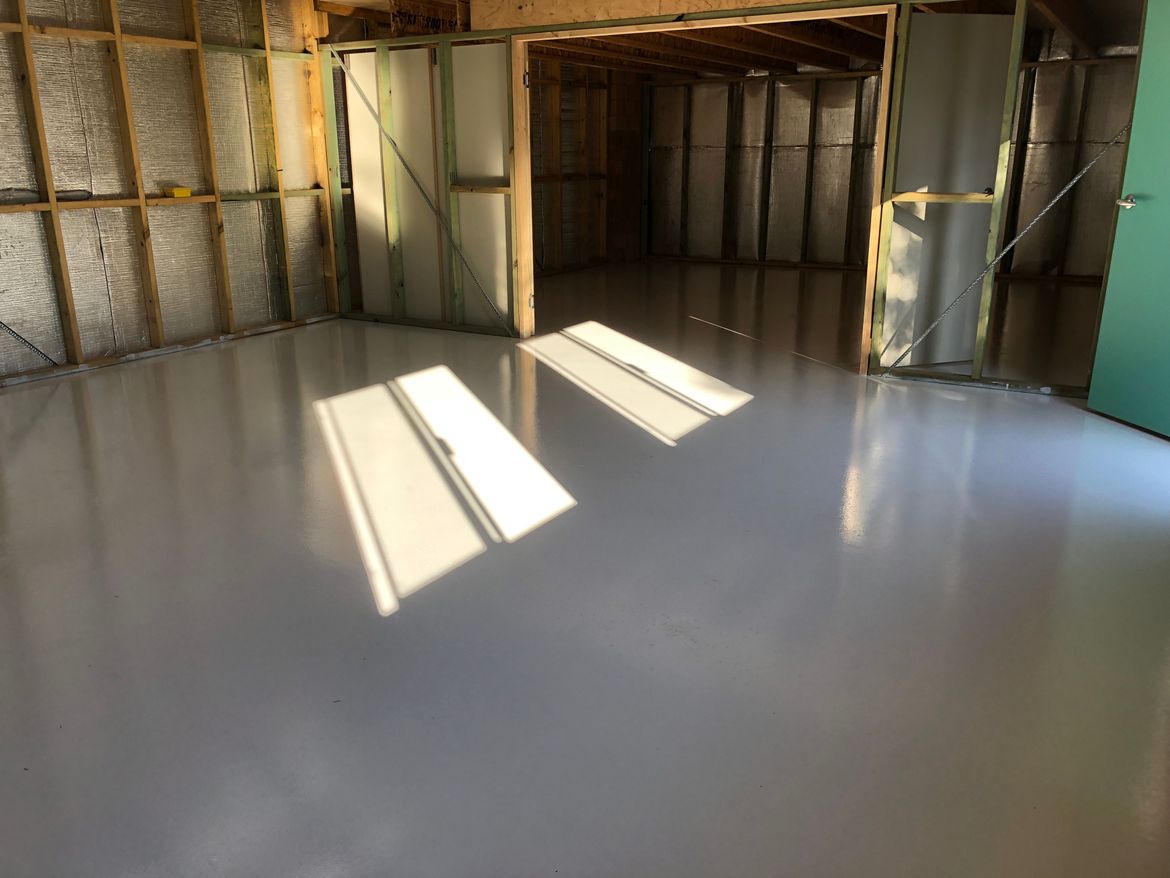

Applying epoxy.
This is how the floor looks after just one coat.

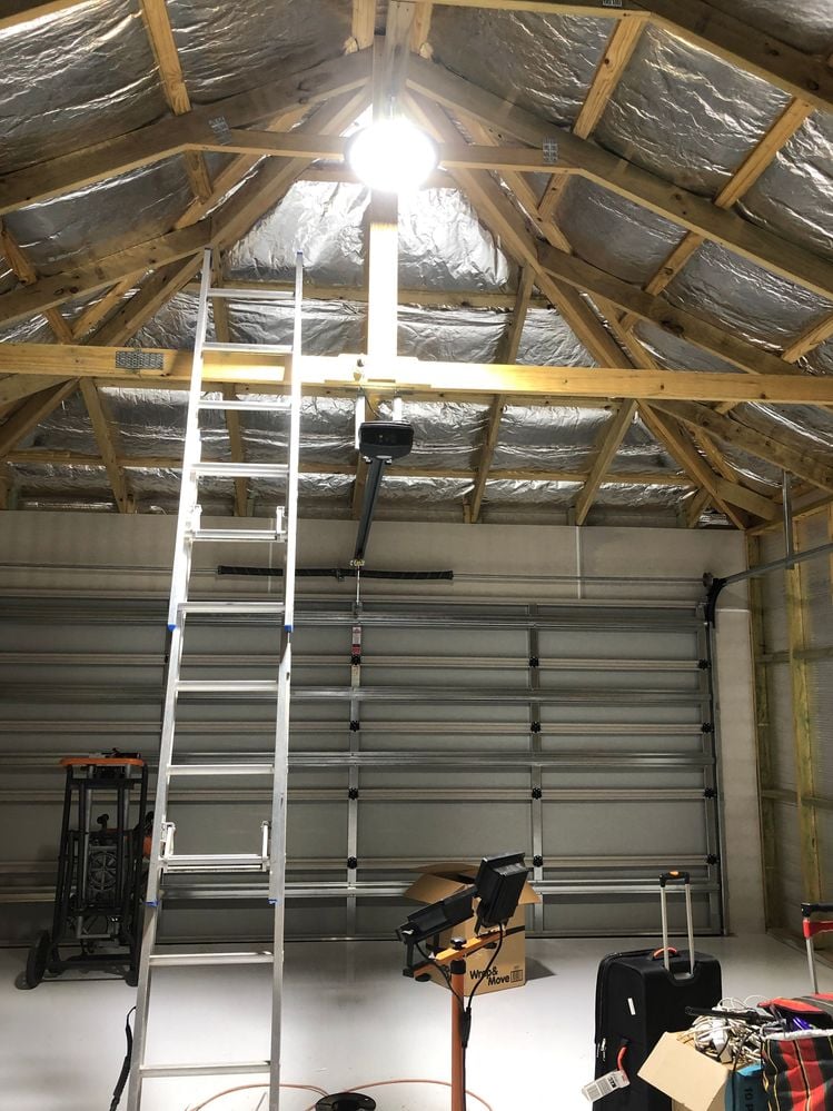

A 200w UFO Highbay LED is in, so there's lots of beautiful bright light in the main garage area. I'm waiting on some LED transformers before I can finish the workshop lighting. At the moment, the highbay in the main garage provides plenty of light in there with the help of some work lights.
The garage door opener is also wired and working, so no more extension cord hanging in the air.

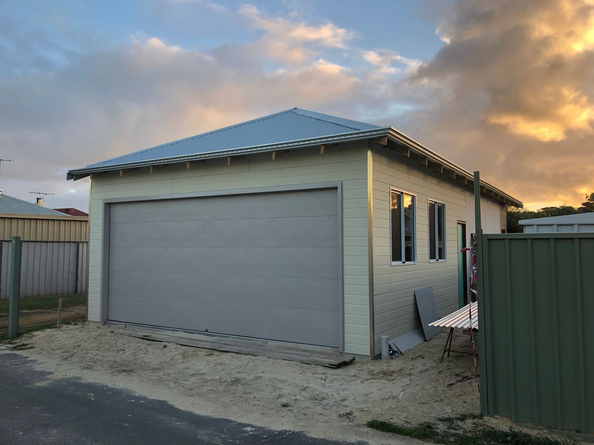

Weather seals went in on the doors and it was very timely as storms came through on the weekend here, so no more rags stuffed under the doors.

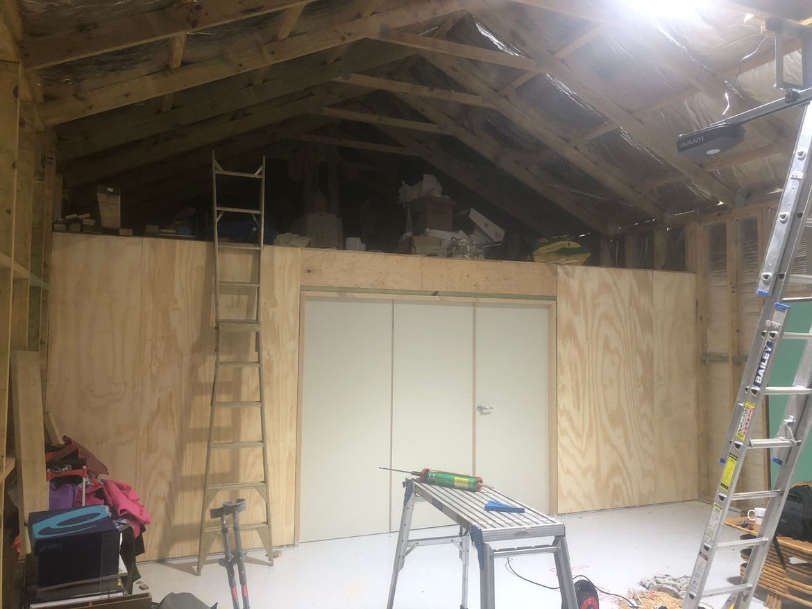

Plywood went up on the front of the workshop. The original plan was to paint it, but after going up we’ve decided to leave as is and just coat with a clear varnish to preserve the timber look and to match the rest.

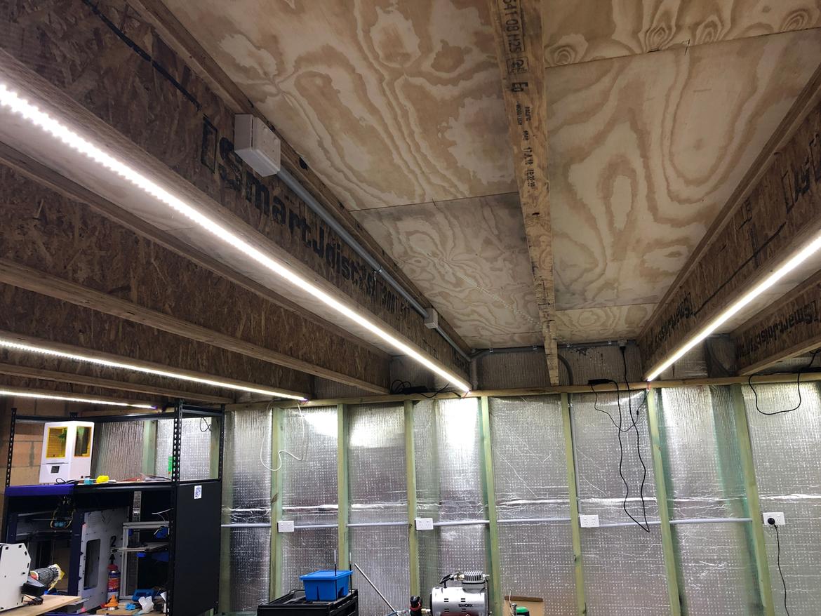

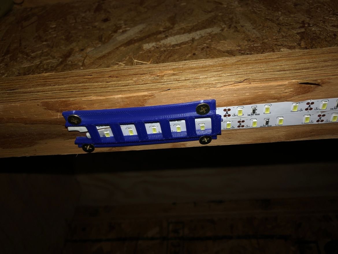

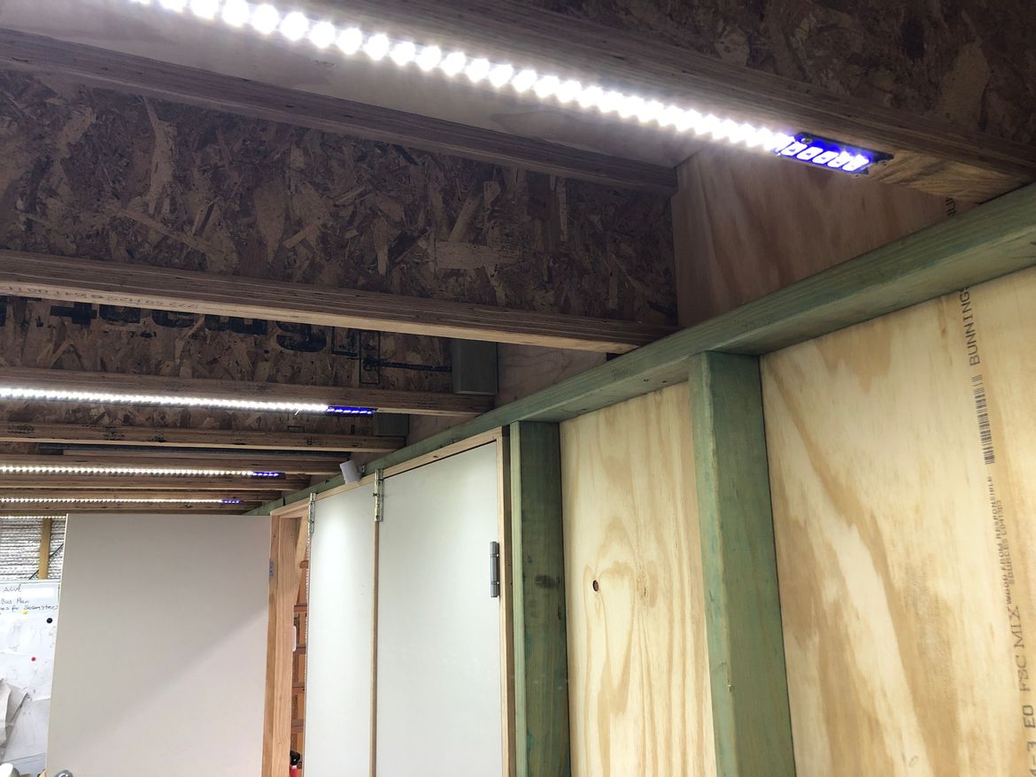

The workshop lighting is finished. I was happy with my original tests and ran 2 x 5m LED 24W strips on every second beam. I printed up some brackets on the 3D printer to stop it peeling off.
LED brackets.

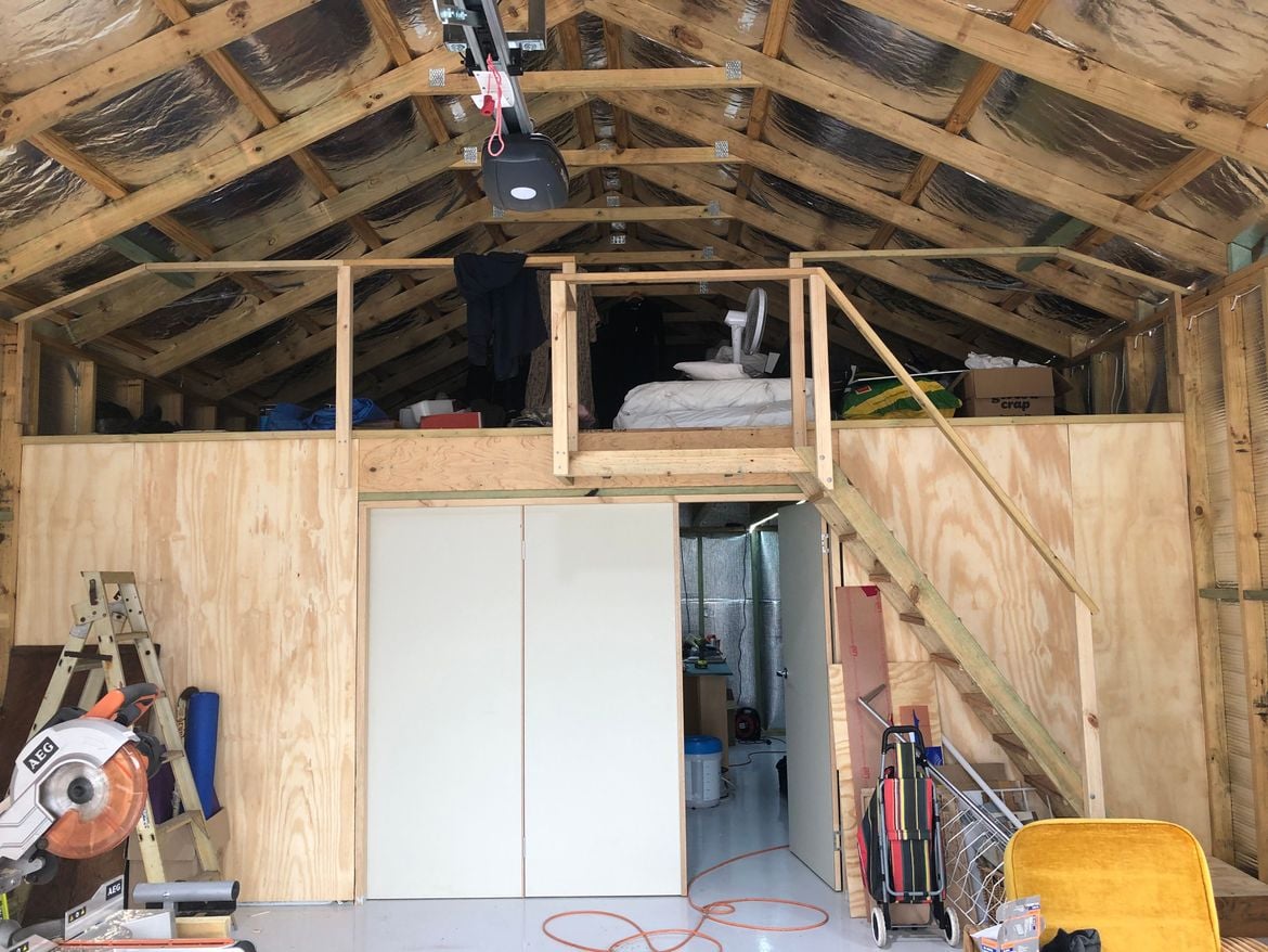

We also finished the access to the storage area with stairs and safety rails installed on the mezzanine.

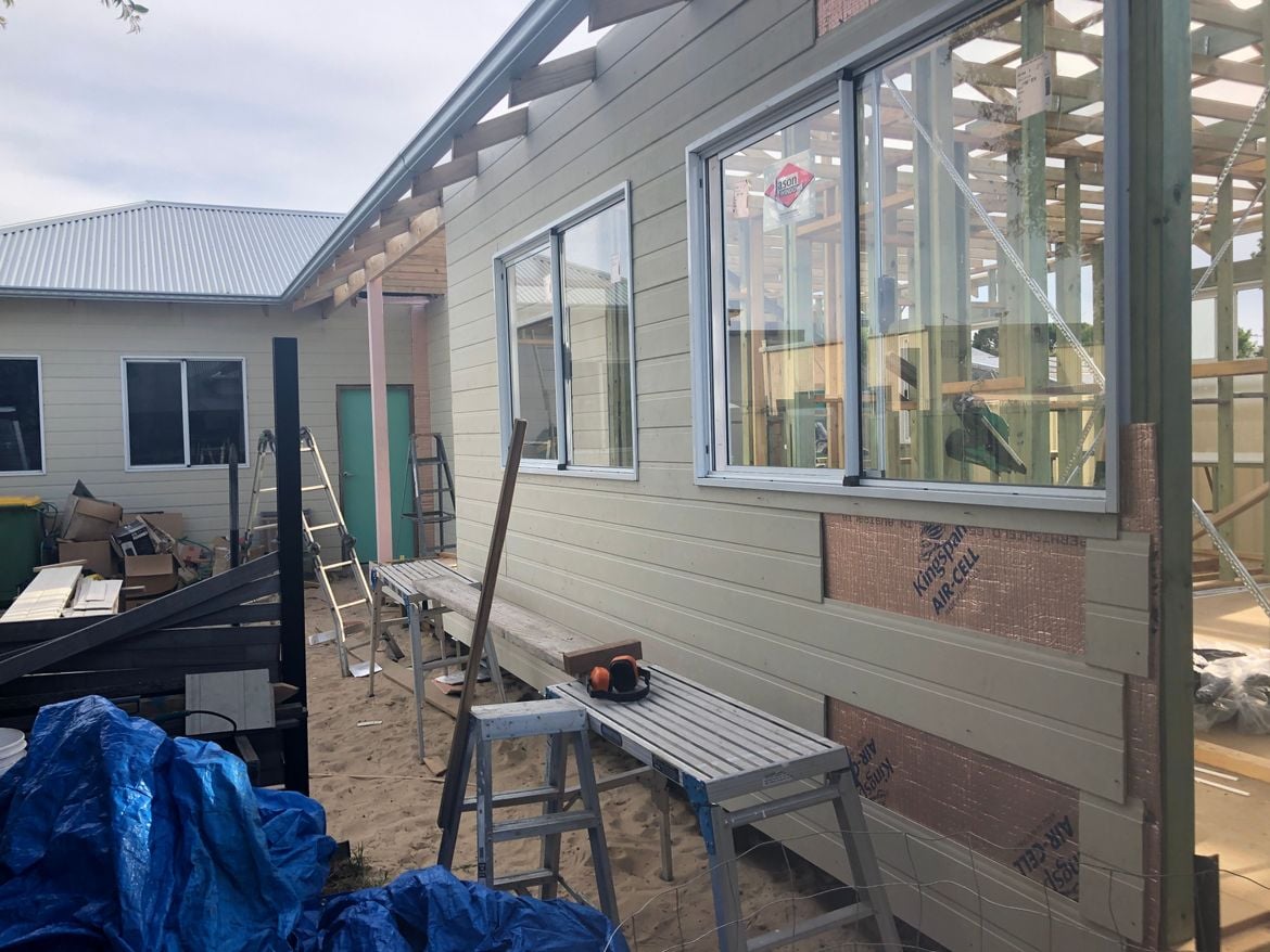

It's been a while since I’ve made any posts, but have been busy with work, study and also building stage two, which is a 2 x 1 extension joining the garage workshop to the house. I’m just finishing up the wiring before drywalling.
