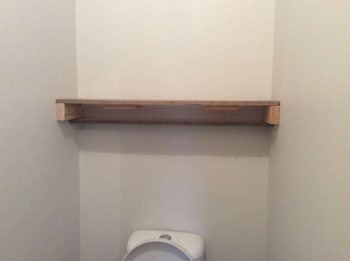

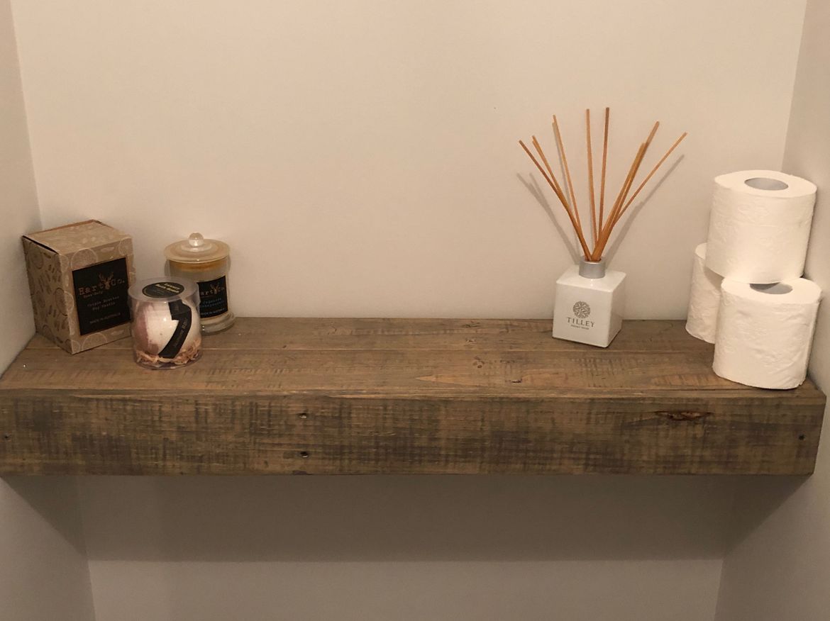

I’ve wanted to make this shelf for ages but kept putting it off. I was surprised at how easy it was.
Using my spirit level, I checked all was good to go and then attached two pieces of pallet timber on the top and bottom, then finished with one piece at the front. I prefer the floating look. Great way to add some storage and also a nice feature.
As the supports are hidden, I just used leftover cut offs – MGP10 untreated structural pine from Bunnings 90 x 45mm. I used two wooden supports and made sure I screwed them into the studs for stability. For extra support, I screwed two pieces of timber cut offs underneath the top shelf.
