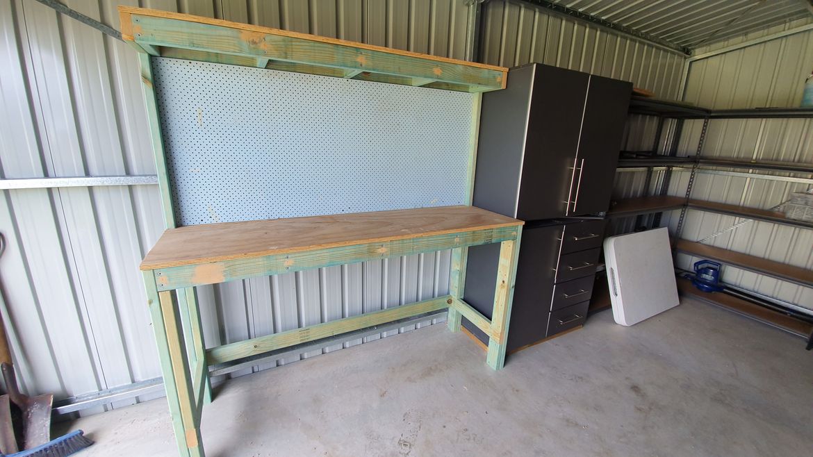

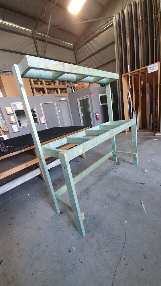

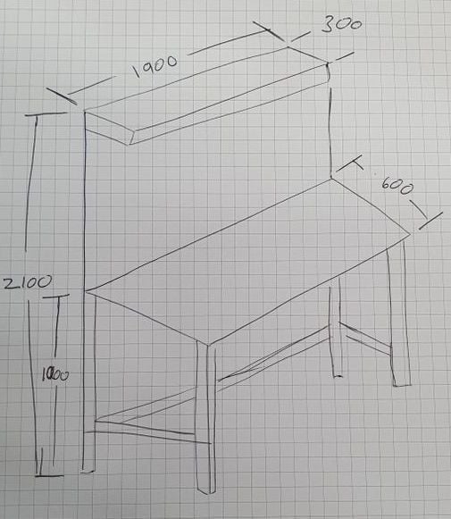

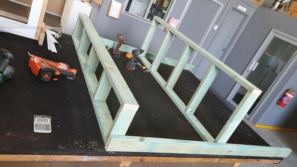

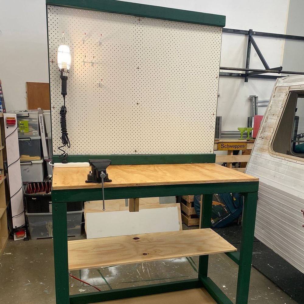

Once the shed was finished, I needed a new workbench. After a lot of searching online, I found the basic design I was after and went from there. A few sketches later, I came up with the final design.
I used 90 x 35mm Pine for the frame and 19mm ply for the tops. It was easy to put the workbench together with a Paslode nail gun and bugle screws.
It's nearly too nice to use as a workbench.

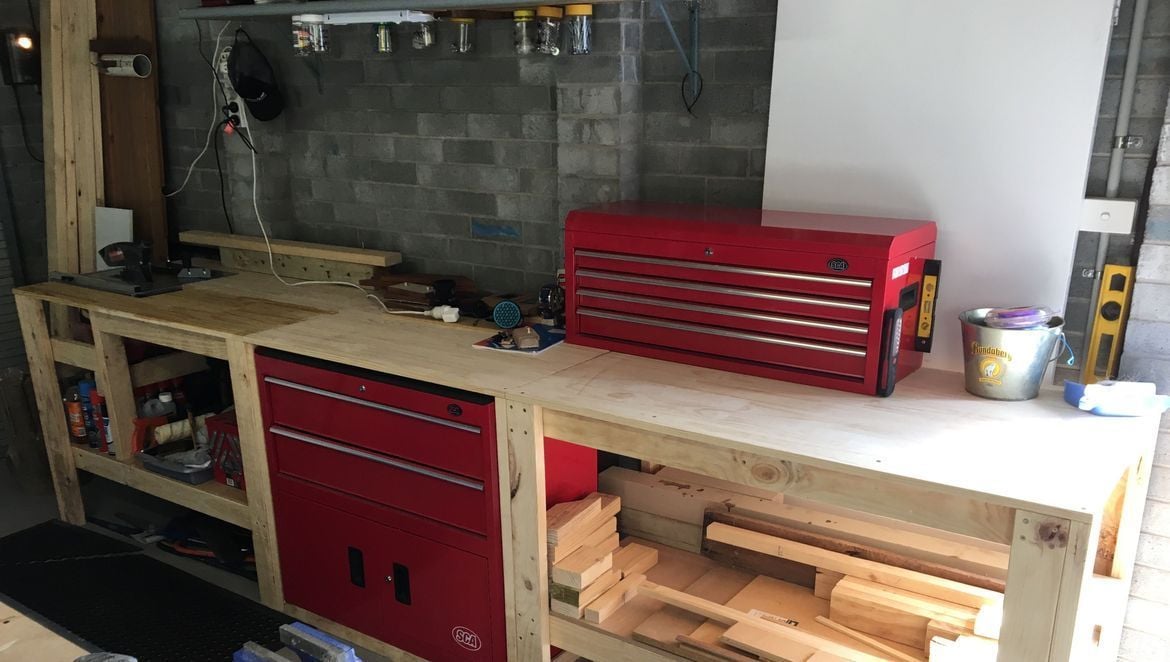

Workshop member Rodney built this custom workbench offering a huge amount of work space and loads of built-in tool storage.

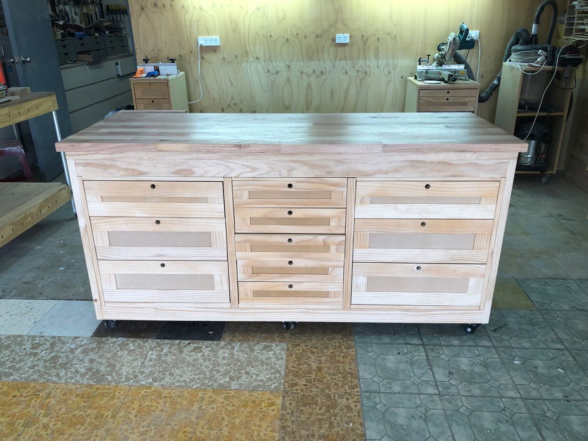

Workshop member JoeAzza took apart his existing workbench to build a frame that would accommodate wheels and added a beautiful Ash timber benchtop from Bunnings.
