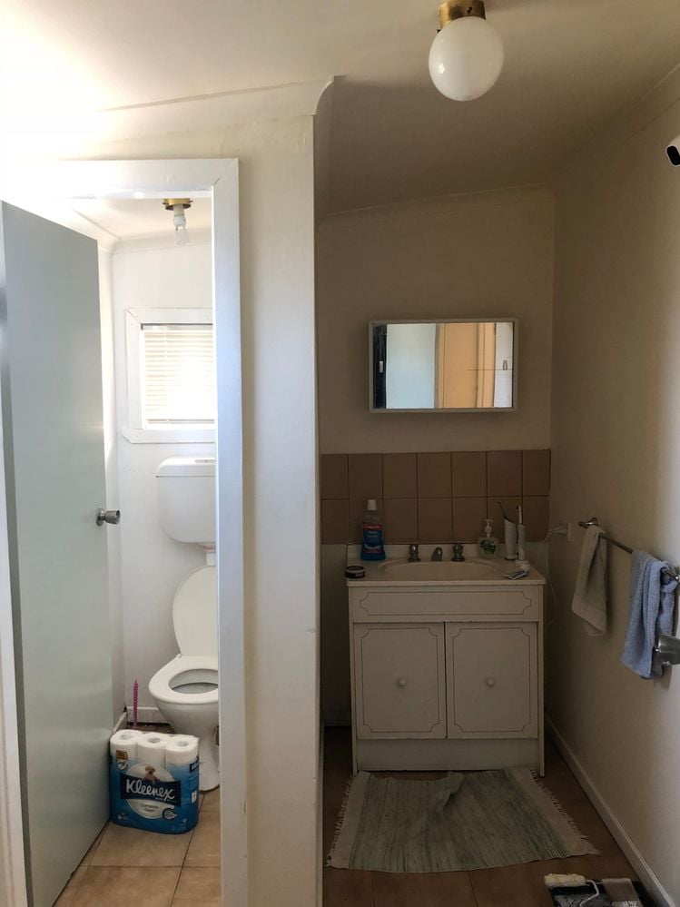

Reorienting the toilet and/or toilet wall was also a priority given that you could not close the door if sitting on the throne.

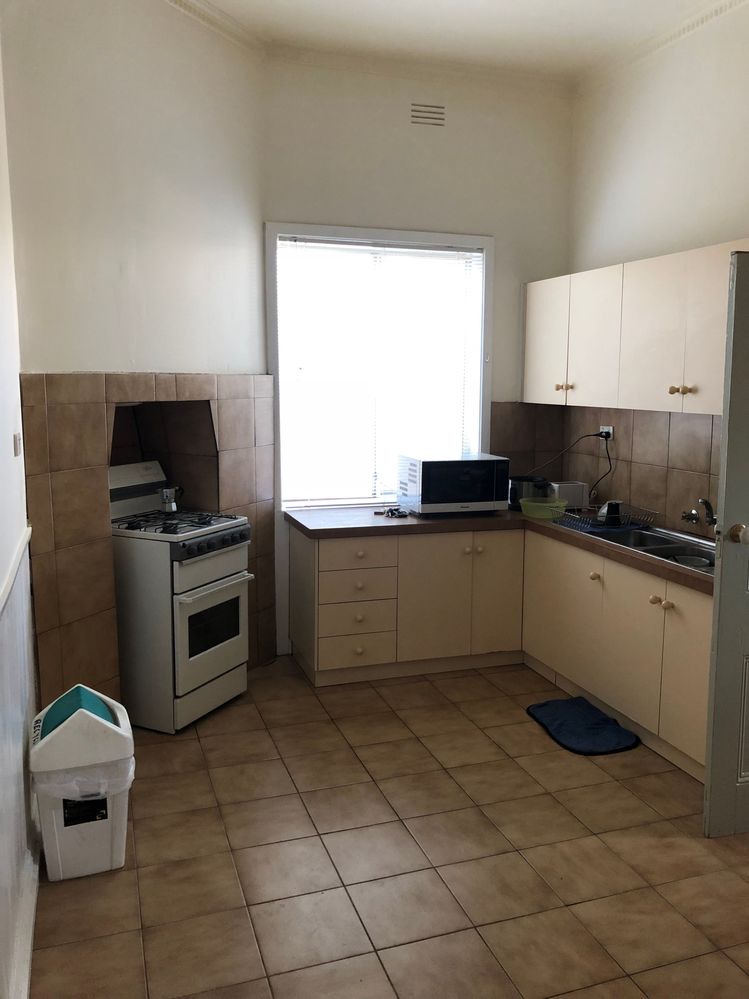

Consideration was also made to demolishing the triangular section where the kitchen stove was. "As much as I want to minimise structural work, it takes up so much room in a small kitchen, and I'd like to add more benchspace, as well as an enclosure for the fridge, microwave and space for a dishwasher," Rohan said.
"I want to add an extra benchtop along the wall where the circular table currently is. possibly just with a bracket and no cabinetry underneath as a dining bench that faces the wall to provide a dining table without taking up as much floor realestate. Just not sure where best to put the fridge/ microwave/dishwasher."

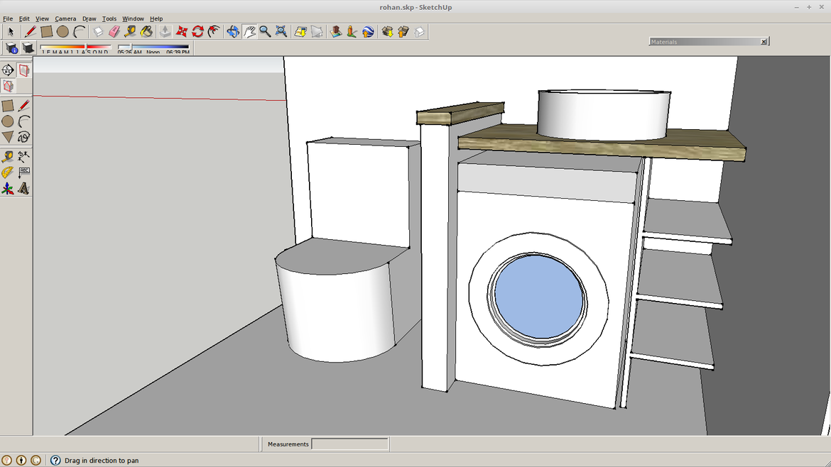

Ever-helpful Bunnings Workshop member redracer01 created 3D designs of the proposed kitchen, bathroom and laundry area for Rohan.
Tearing down the wall between the living and kitchen areas was the most dramatic suggestion, opening up the space considerably.
The microwave was placed at the same height as a standard wall cabinet and a standing oven/cooktop placed in the existing cavity with a rangehood added above.

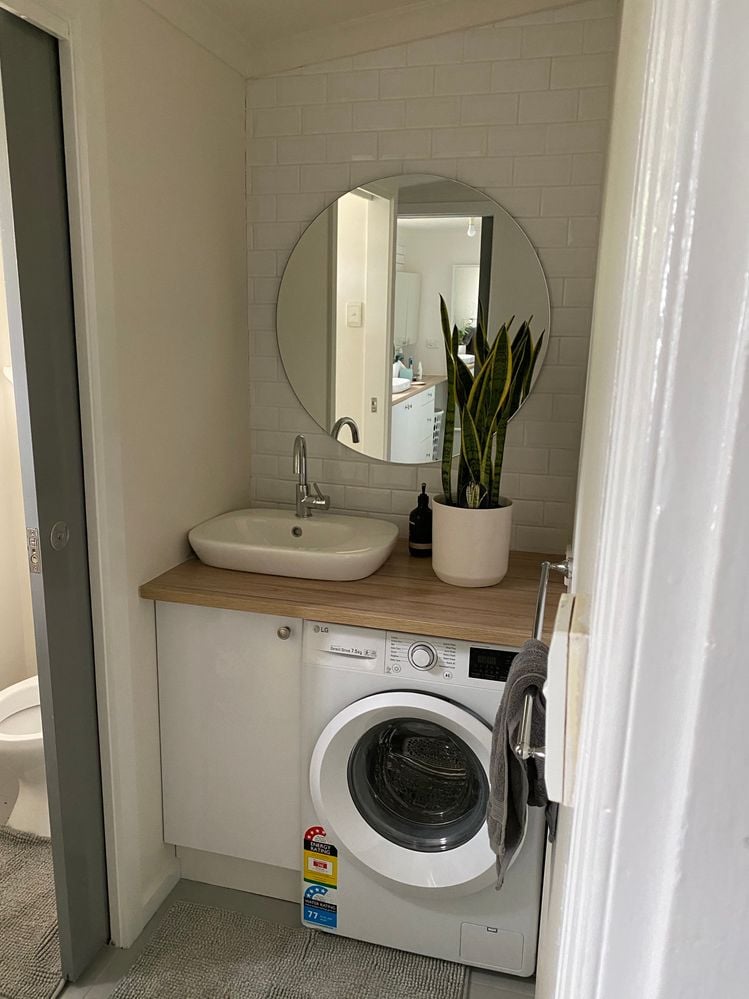

It was suggested to move the washing machine out of the bathroom to maximise bathroom storage space. This had a dramatic impact.
The washing machine was moved to under the vanity. However, consideration needed to be given to the height - standard washing machine height is 850mm and you do not want the vanity to be too tall to use comfortably. Easy access to laundry taps was also needed, and it was noted that the vanity's plumbing might prove difficult due to the washing machine.
A sliding cavity door was suggested to maximise limited space and eliminate the need for a swing area for a traditional door.

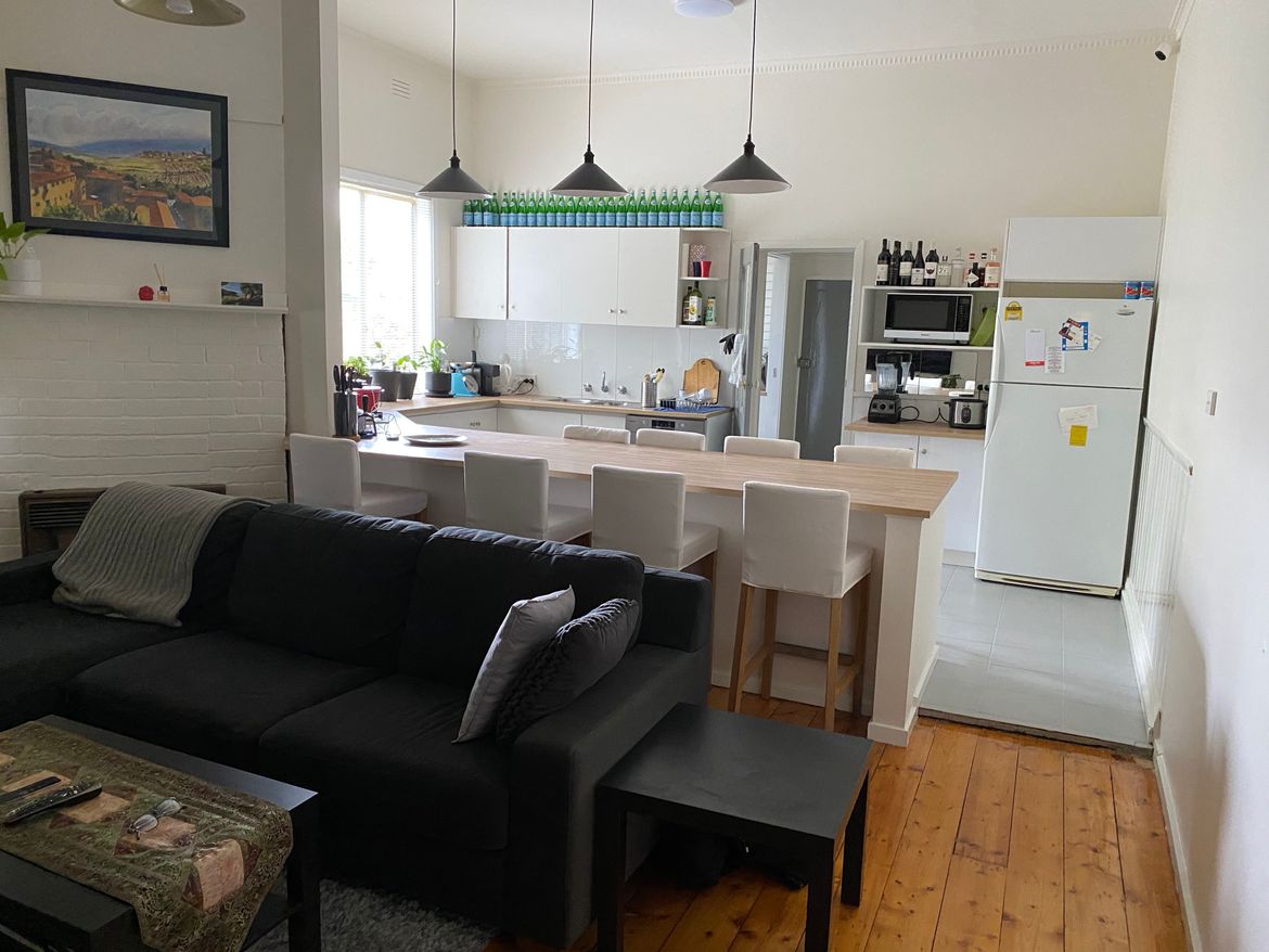

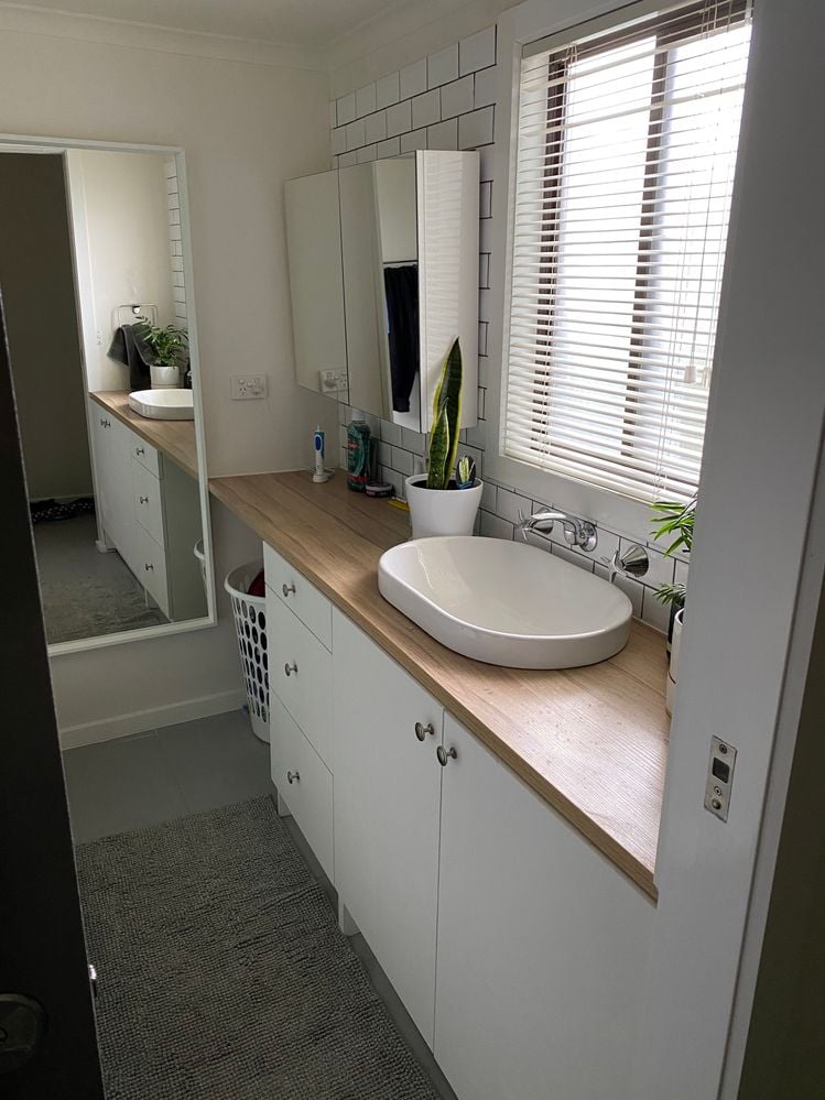

When the project was completed, Rohan returned to the Bunnings Workshop community to share photos of the renovation work and thank helpful members for their ideas and assistance.
Before and after
Kitchen/Living area:
Bathroom/Laundry Area:
Toilet area:
