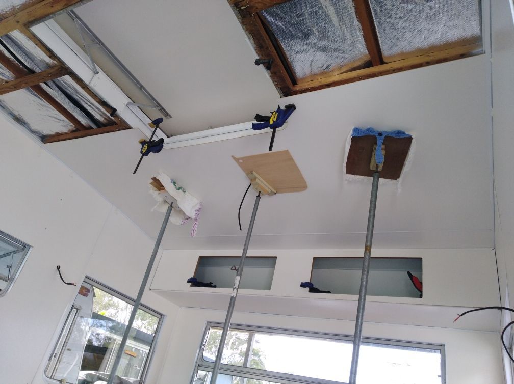

I've been working on this little 10ft York caravan for just over a year. It's been mostly just me but my husband helps with the mechanical side, and if I need a second pair of hands such as putting the ceiling up. He also rebuilt the chassis as he's a boilermaker.

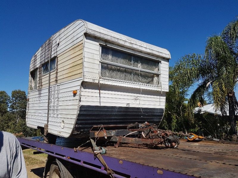

On the tilt tray coming home.

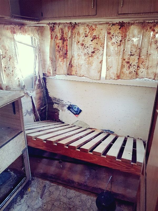

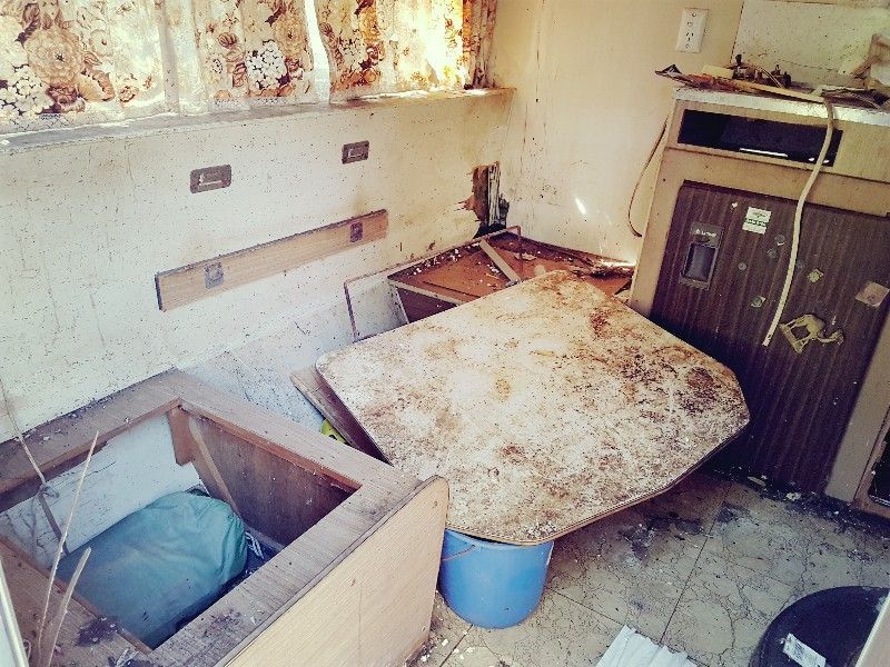

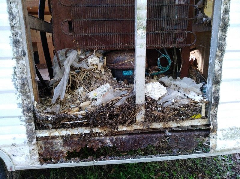

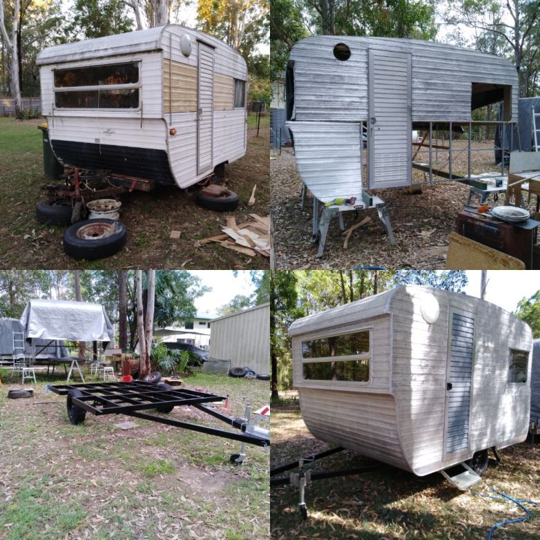

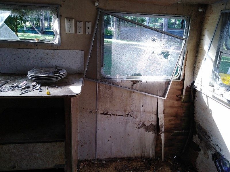

Lots of things had been living in it and the chassis had rusted out in most places.
There was no end to the rust in this – even the drawbar had broken, it was that bad.

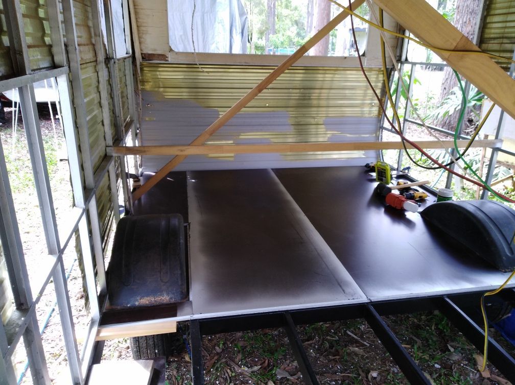

Long story short: disassembled, rebuilt the chassis, reassembled.
New floor using 12mm formply.

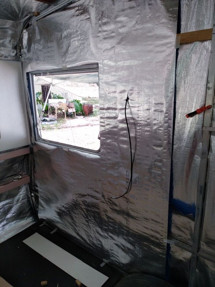

Two layers of Ametalin foil insulation with air pocket.
The interior was relined with 3mm caravan ply (poly coated, so no painting needed).

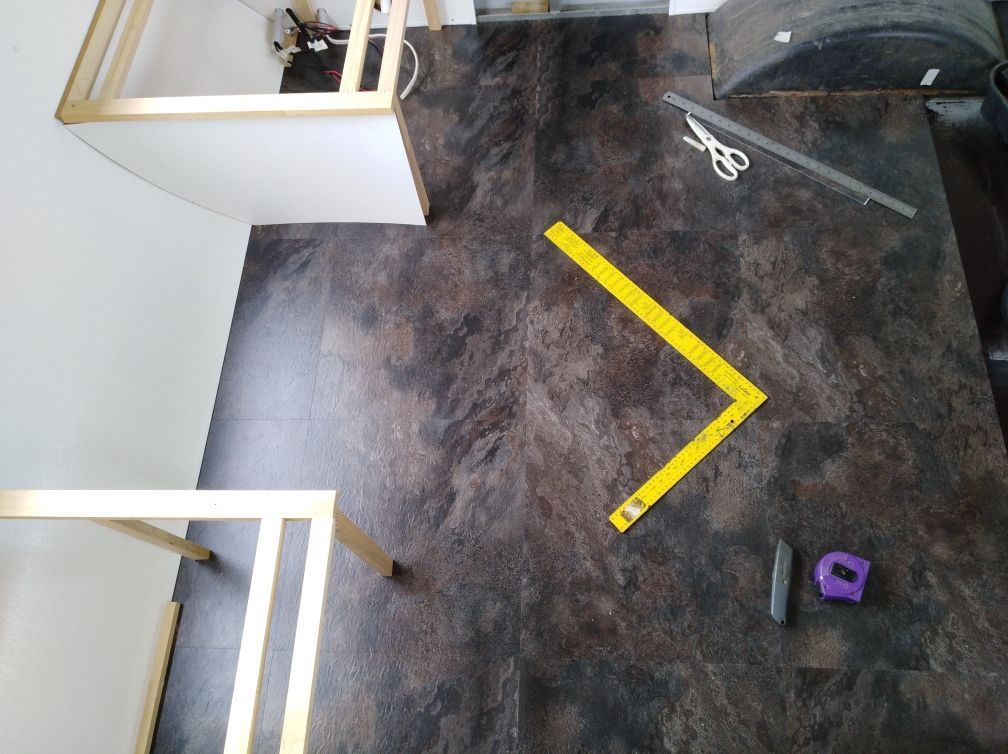

Winton floor tiles with a sanded and BondCrete-prepped floor.

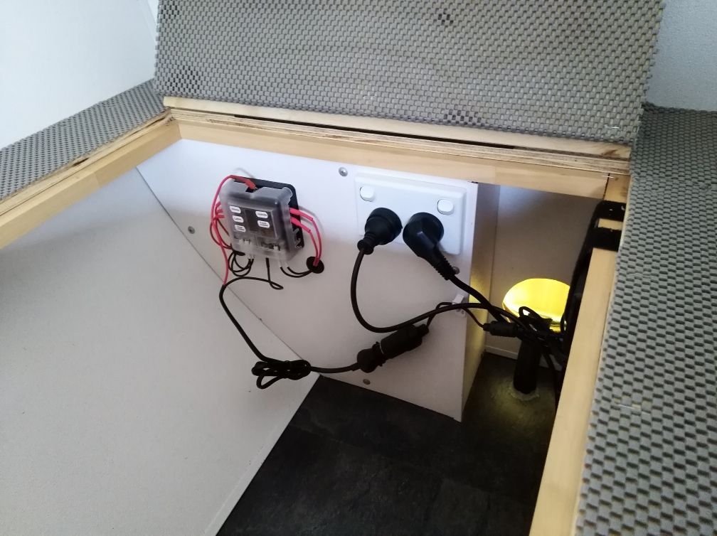

12v lights to fuse block under the front seat. I've run and connected all of the wiring for this and used LED lights.

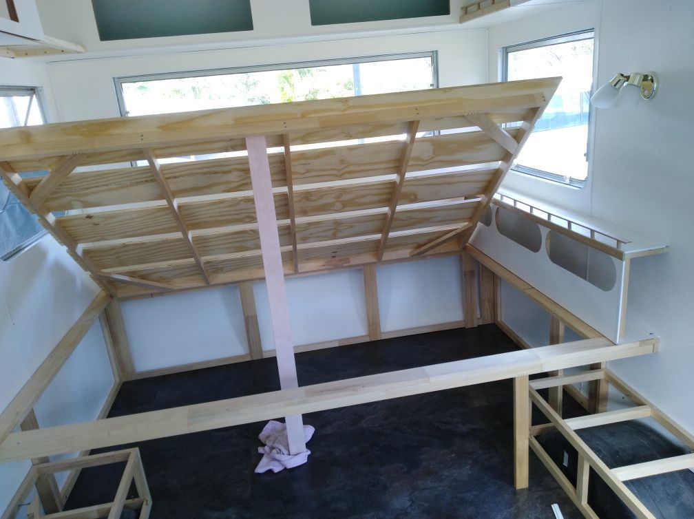

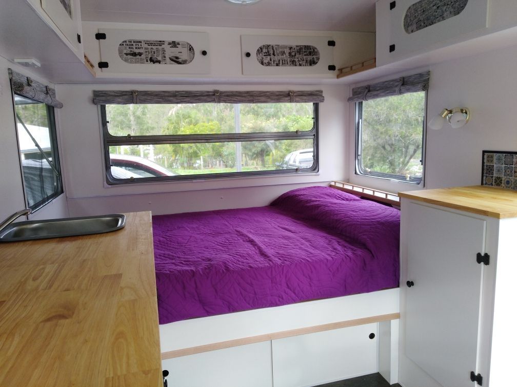

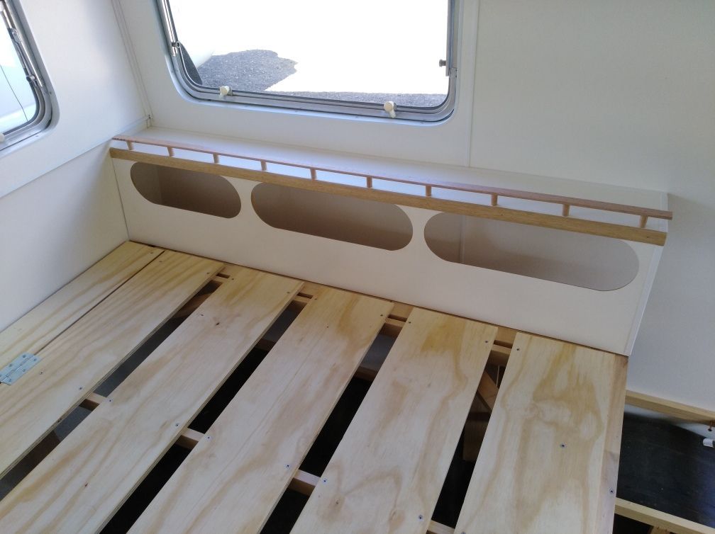

Hinged slat double bed using 12mm ply and Pine.
Bedhead storage using Tasmanian Oak railing made from dowel, cover strap and shelf lipping.

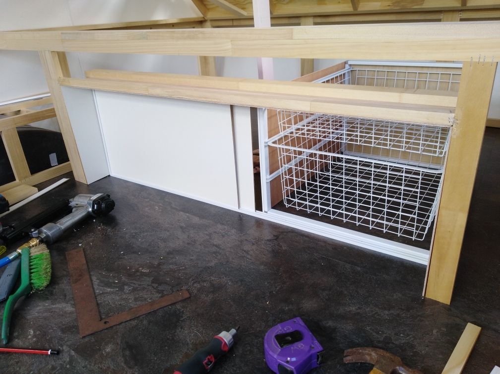

Under bed access when you don't want to lift it. Not yet fastened in place so it looks crooked. The baskets and sliding door track are from Bunnings.

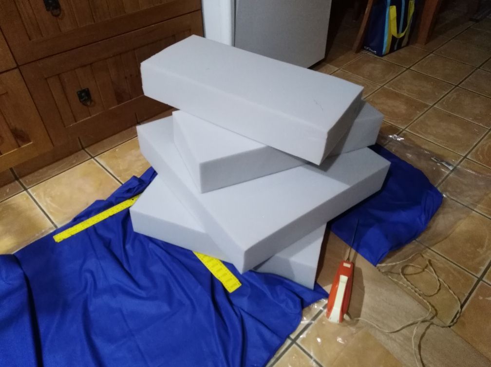

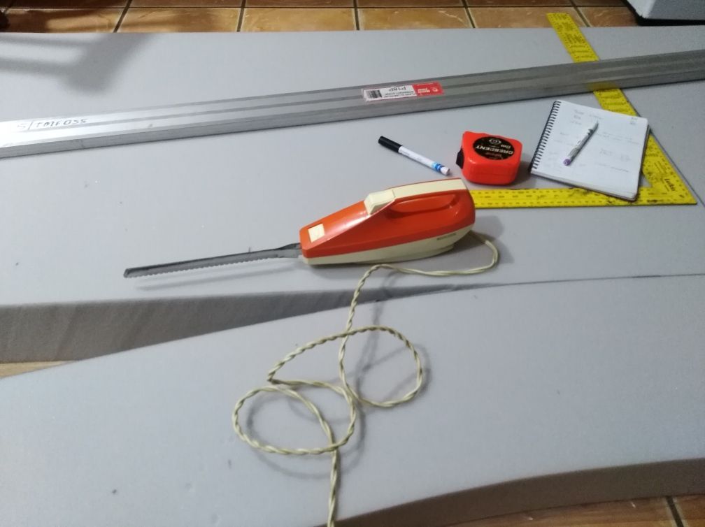

I cut the single bed mattress up to use for seat cushions with a little help from my grandmother's old electric knife.

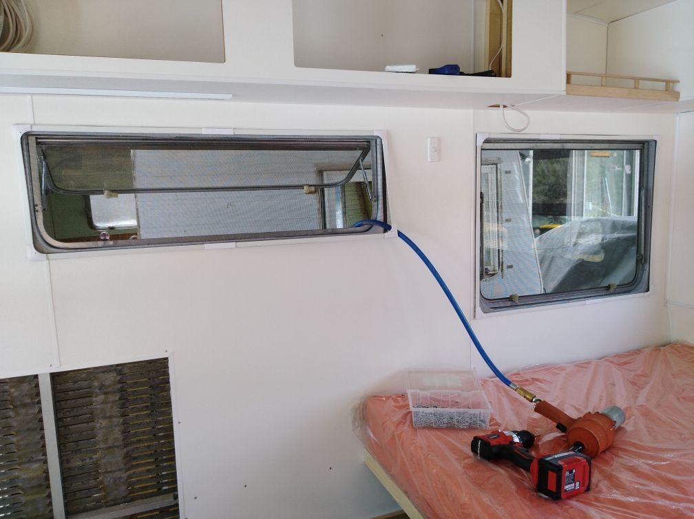

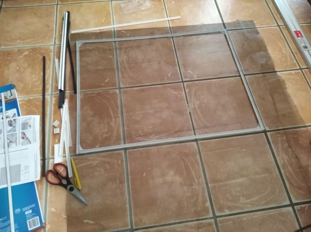

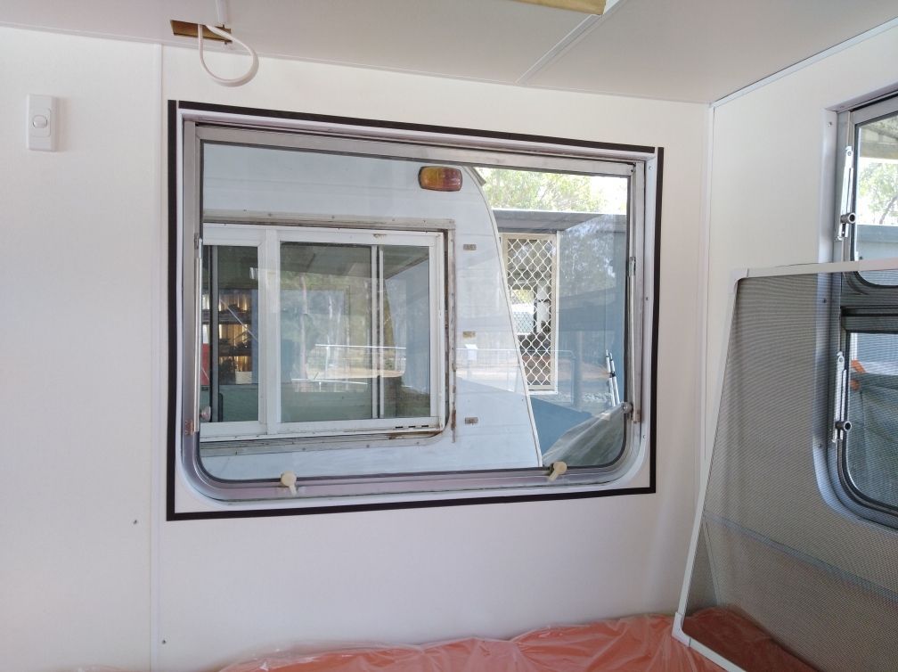

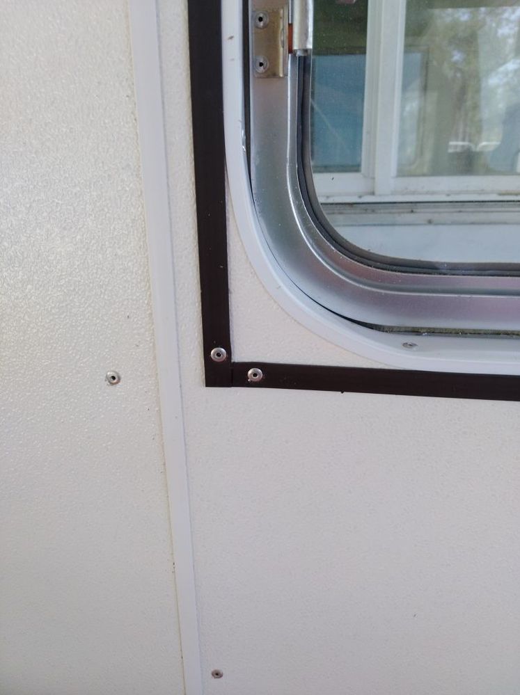

Today I've been having fun with the Permastik Magnetic Insect Screens from Bunnings. The original flyscreens had seen better days.
The grid pattern on the tiles came in handy.
Backing magnets in place with supplied self adhesive tape.
My walls aren't smooth so I didn't trust the tape to last long, hence the added security of rivets.
I'm very happy with how they are looking and they're still flexible enough to allow my air hose through.

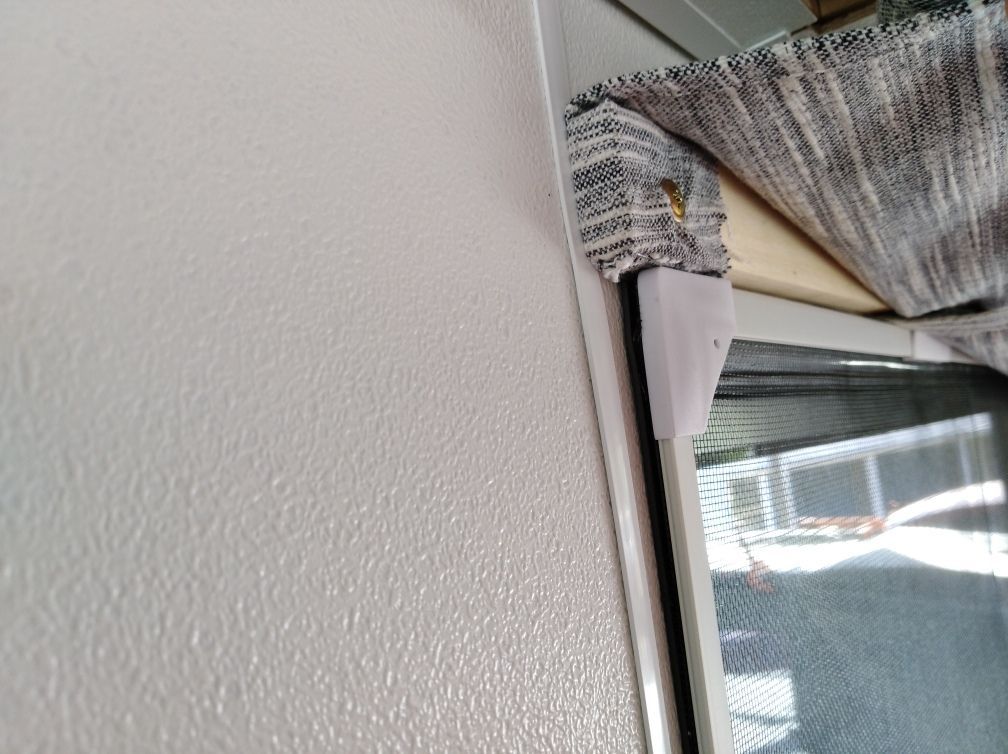

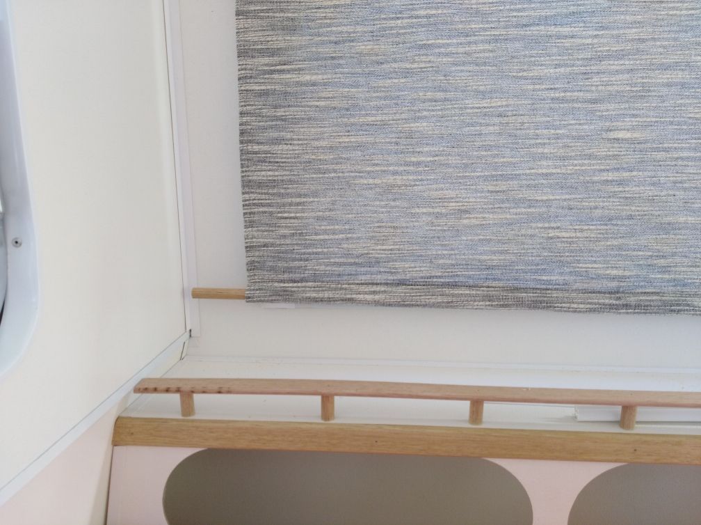

I made my own blinds using material, a piece of timber, dowel and fasteners. The material is stapled to the piece of timber, with a scrap over the end to cover, then the timber is screwed to the wall. The material hides the screws when put down.
A full length of dowel in the bottom adds weight and makes it easy to roll up.

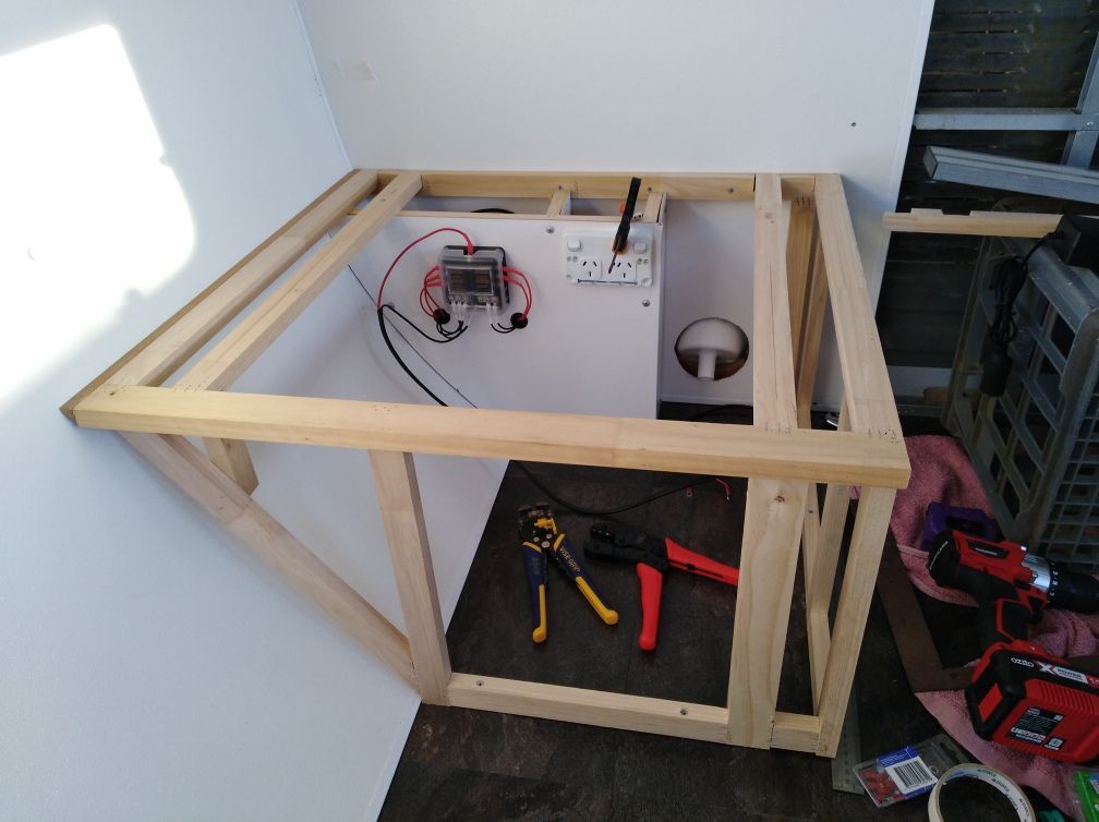

I've also built the first lower cupboard. I'll put a bench top on this once I've finished the kitchen side. I used FJ Pine stapled together with wide crown staples using the same construction methods as used during the 70s and 80s and maybe still today. I haven't pulled a newer van apart to see. I've added a few screws where I couldn't staple both sides of the pieces and I've only used glue to put the ply on, no glue in the joins.
Stick frame cabinetry is the best way to build caravan cupboards to keep everything lightweight. The enclosure on the lower side is for the fire extinguisher just inside the door.
The frame is fastened through the walls to the caravan frame and into the floor.

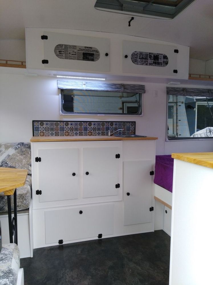

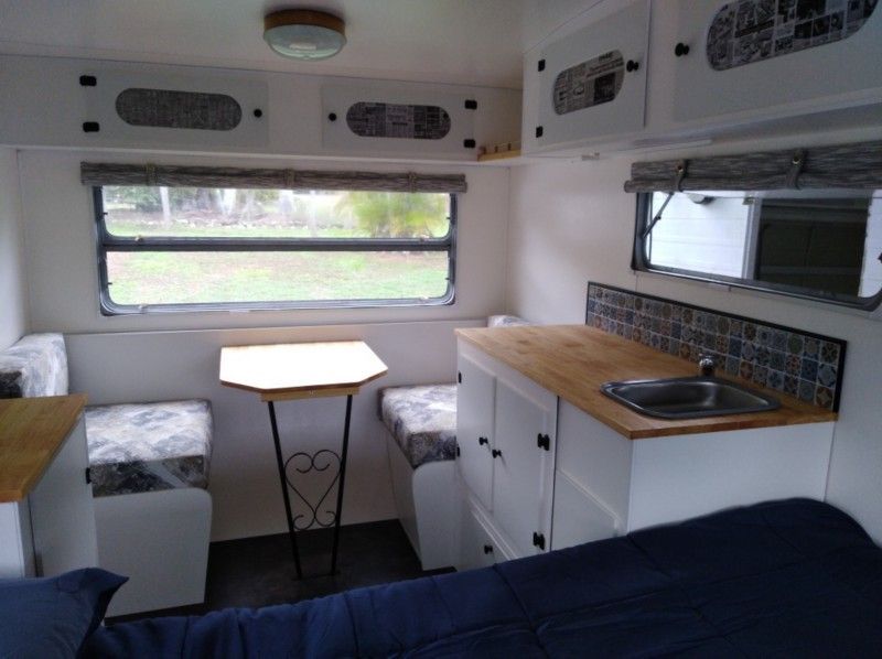

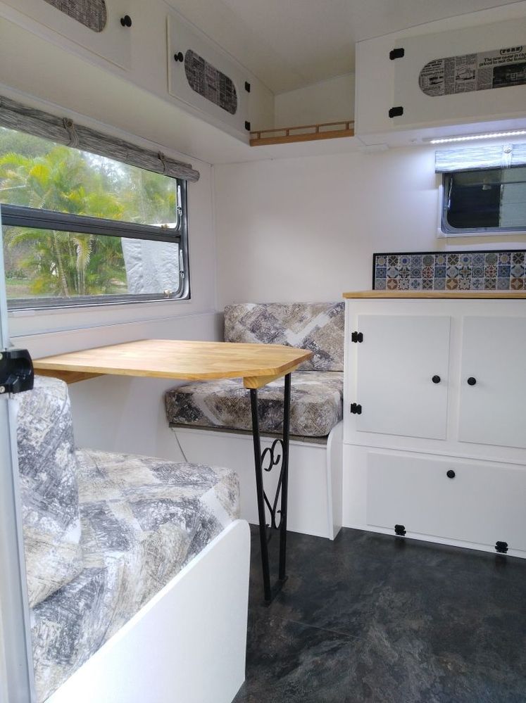

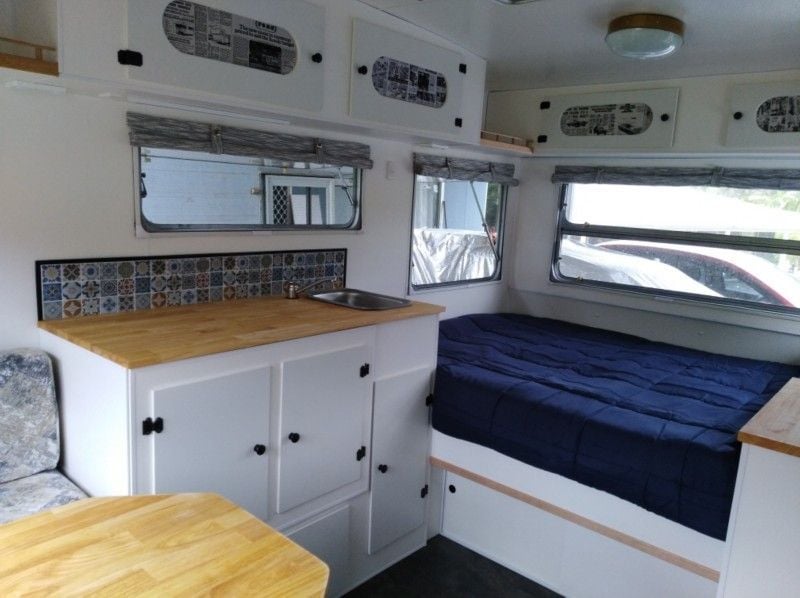

Roll down blinds, magnetic flyscreens, tic tac tiles and original table leg.

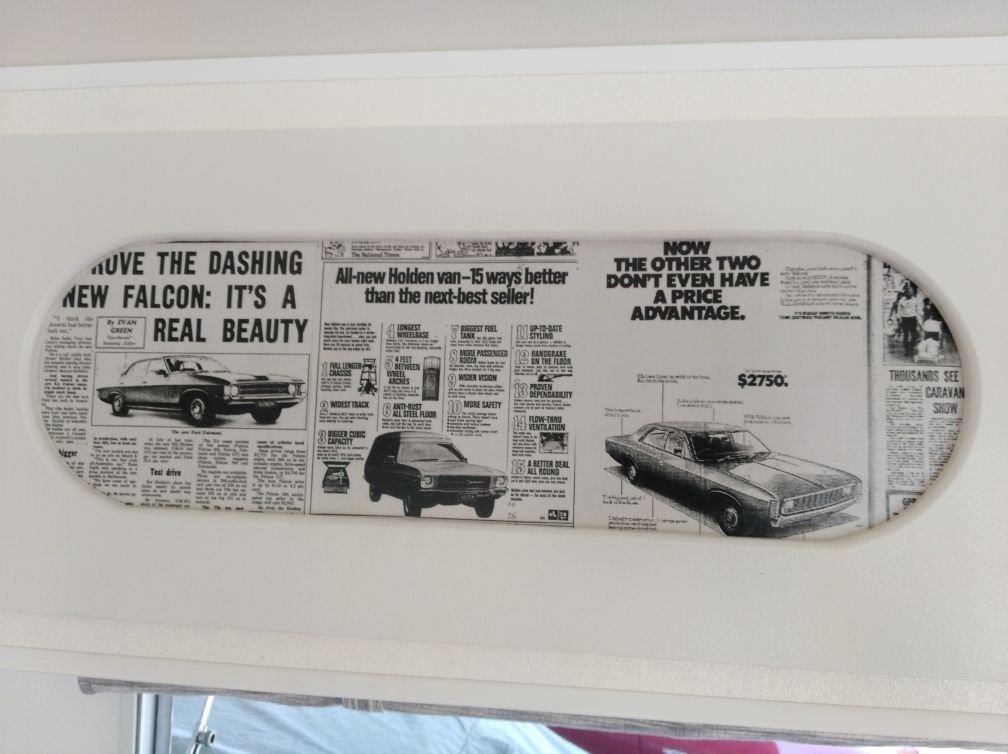

Each cupboard has a different theme from 1972 newspapers.

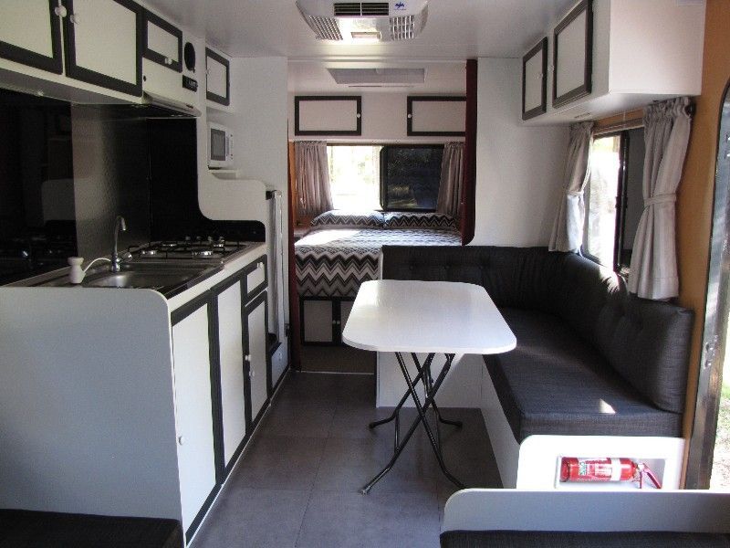

I finished the little York last month and she passed registration with no real issues, except that because of the new drawbar she's now registered as a 2020 home built, which is unfortunate but at least it's registered and road ready. She was sold a week after completion to a lovely young couple who bought it as an anniversary present for themselves.
I really wanted to be able to put this table down to make a single bed but because I brought the kitchen out, I couldn't have the full width table and still get into that seat.

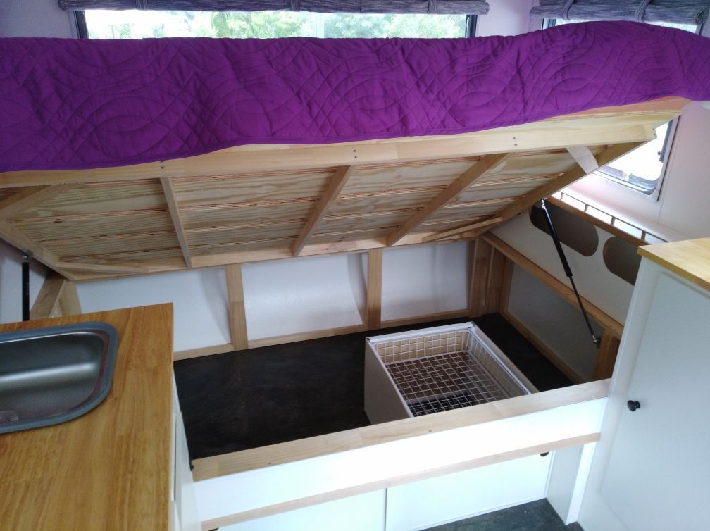

Under-bed storage with gas struts for full access and sliding doors for quick access.
240v to 12v converter to be able to run lights from battery or as a jump starter.
Slide out 35L car fridge which can be easily removed any time.

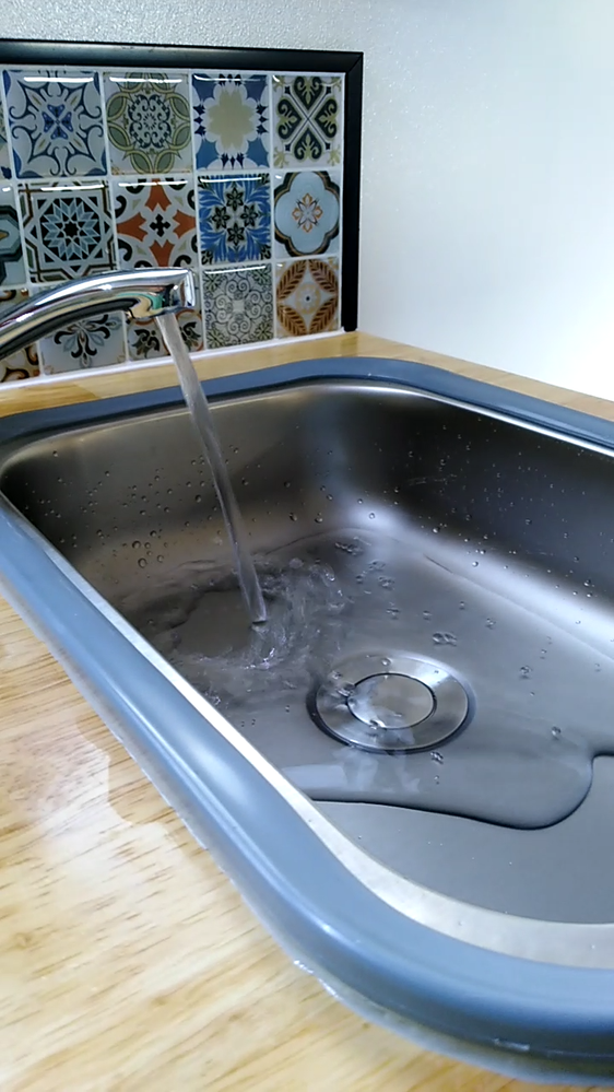

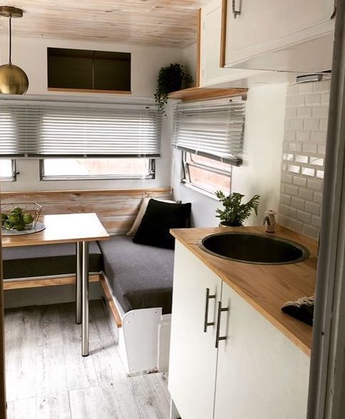

Dinky sink with swivel plug so it can't be lost. Tic Tac Tiles as the splashback.
