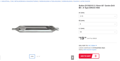

Hi @ronmcm
A centre drill might do the job, this one is 3.15mm shaft diameter, however the countersink is 60 deg not 45 deg, hope it helps. Not sure if Bunnings sell these, they are available online from other suppliers, just look up Centre drills with 3.15mm shaft size.
