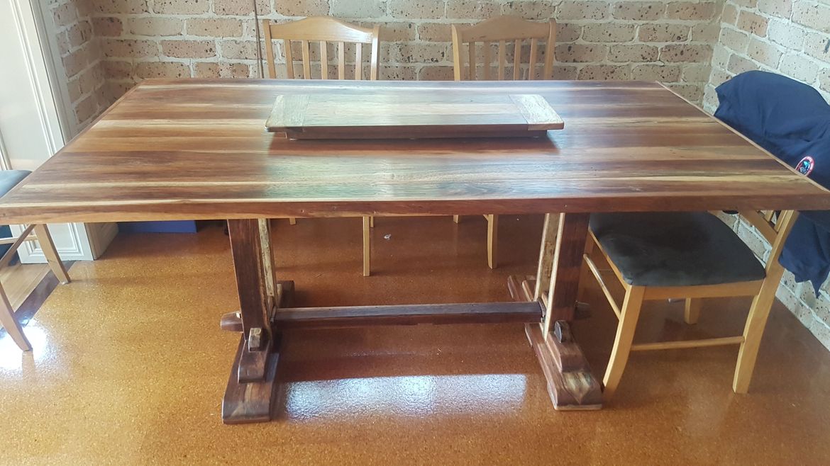

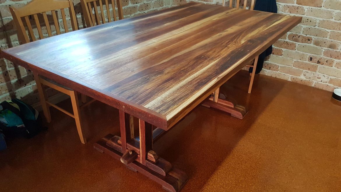

I have only been doing woodworking projects for two months now. I don't have a plan, I just start to build and work from there, staring at the wood for ideas. I built this table using pallets made of Spotted Gum. After I sanded the table back, I oiled it twice with 50:50 linseed oil and turps, while sanding in-between coats. I then finished off with a couple of coats of wax applied with steel wool. Pretty happy with the end result.
It was a sheer mix of ambition versus ability, but I managed to pull it off. I was amazed at how it came up when I oiled and waxed it all – the grain popped.

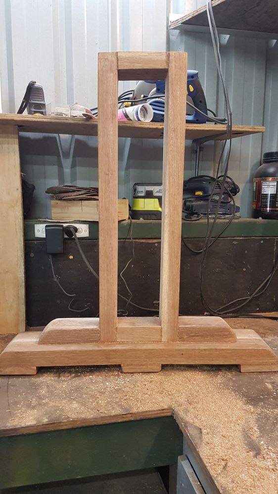

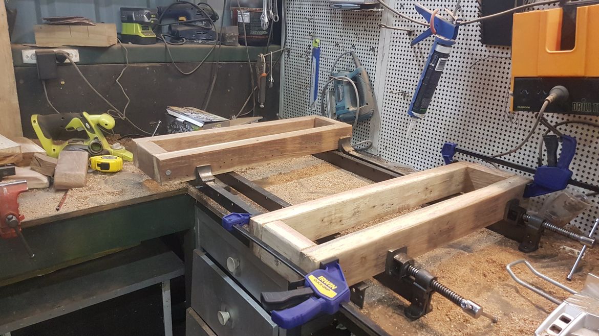

I created the legs and feet with the batons from the hardwood pallets. I first glued them together and then screwed them. I then created the extra bits to sit on top.

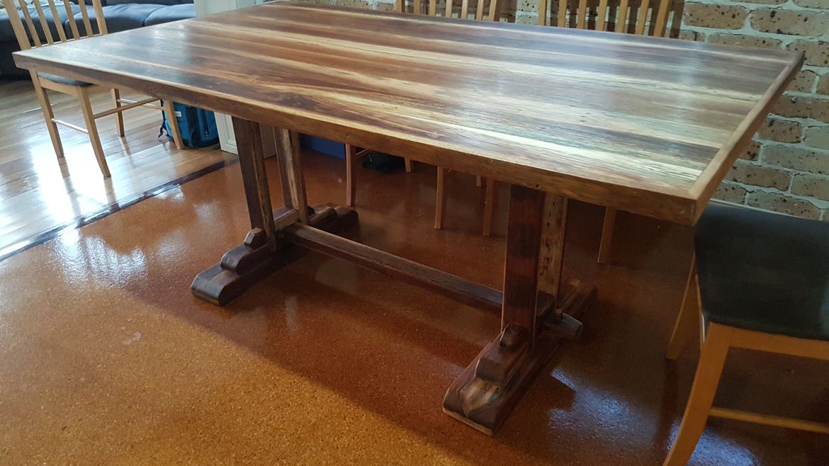

This was one of the first things I built, so I learned a lot from my mistakes. As this is hardwood from pallets, I am dealing with wood that is not straight, as you can see there is a bow in the legs. Makes it more fun.
I also added a piece on top to protect the table a bit.

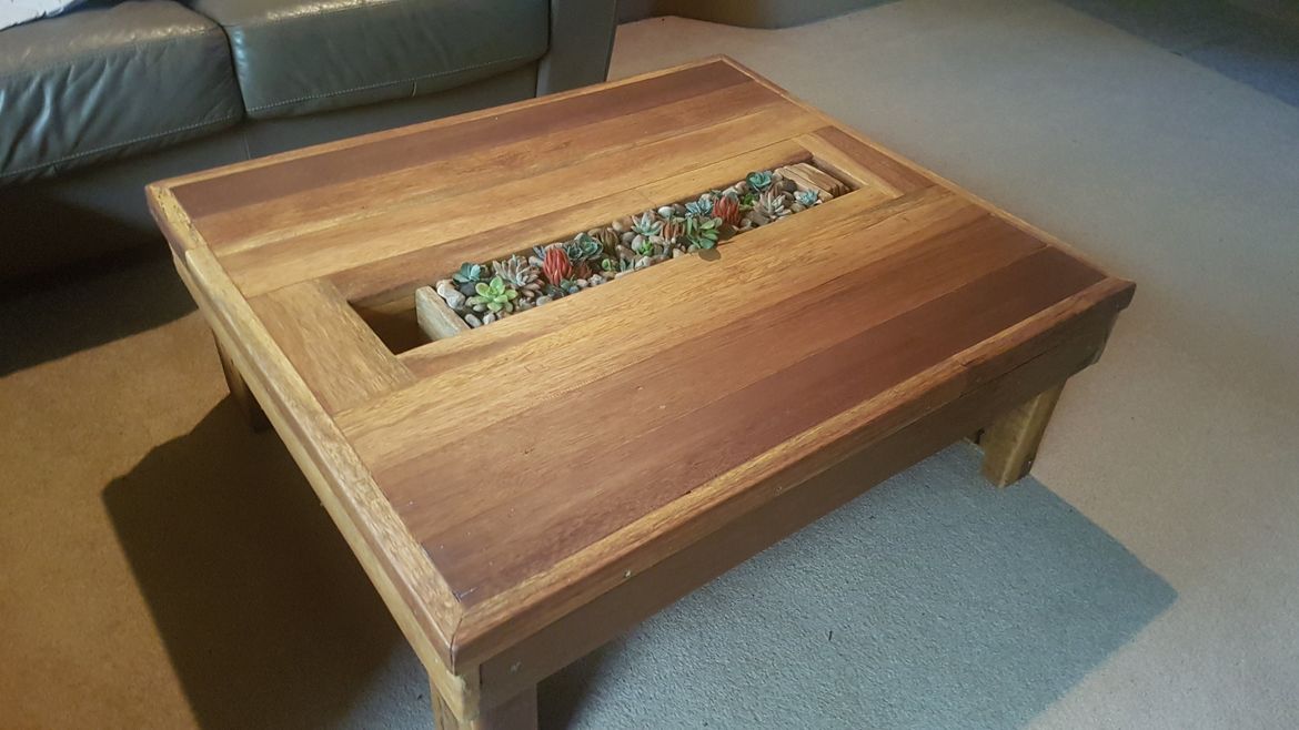

Dean built a coffee table with a built-in planter box using hardwood pallets made of Spotted Gum.
