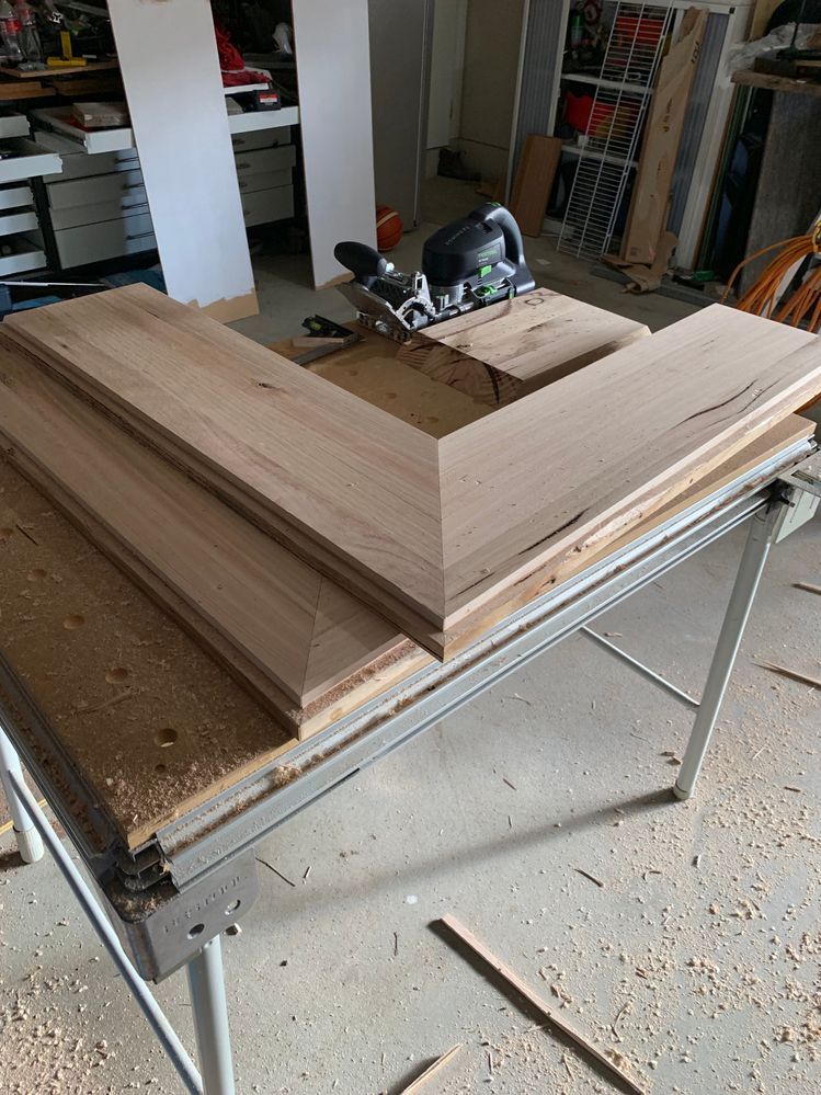

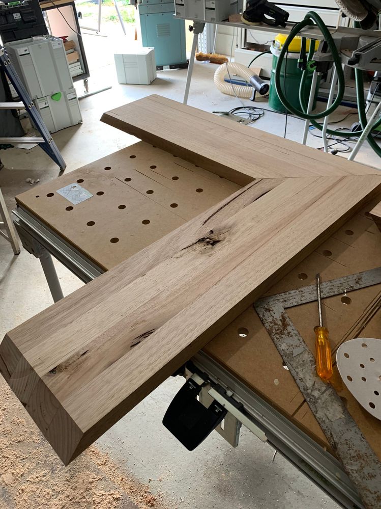

Corner joined.

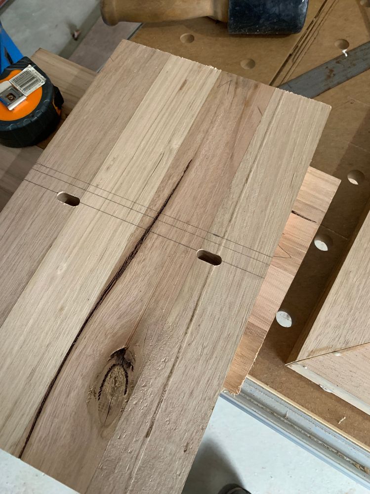

Domino holes to hold the single shelf.

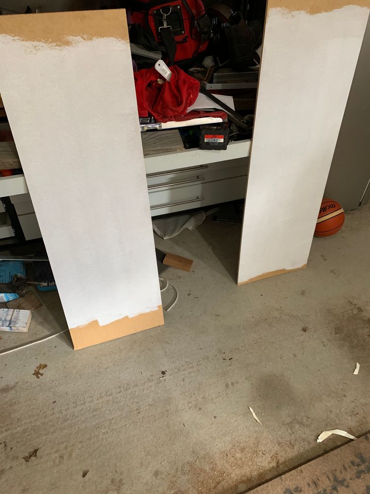

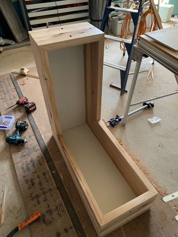

False back painted the same colour as the wall.

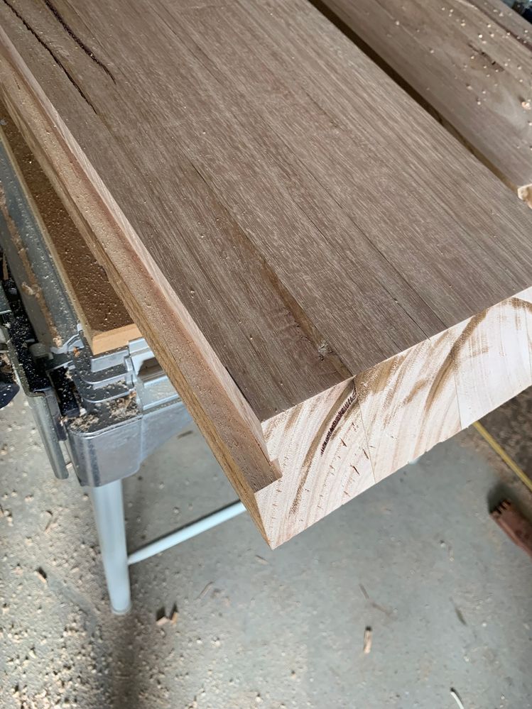

Rebates cut for false back.

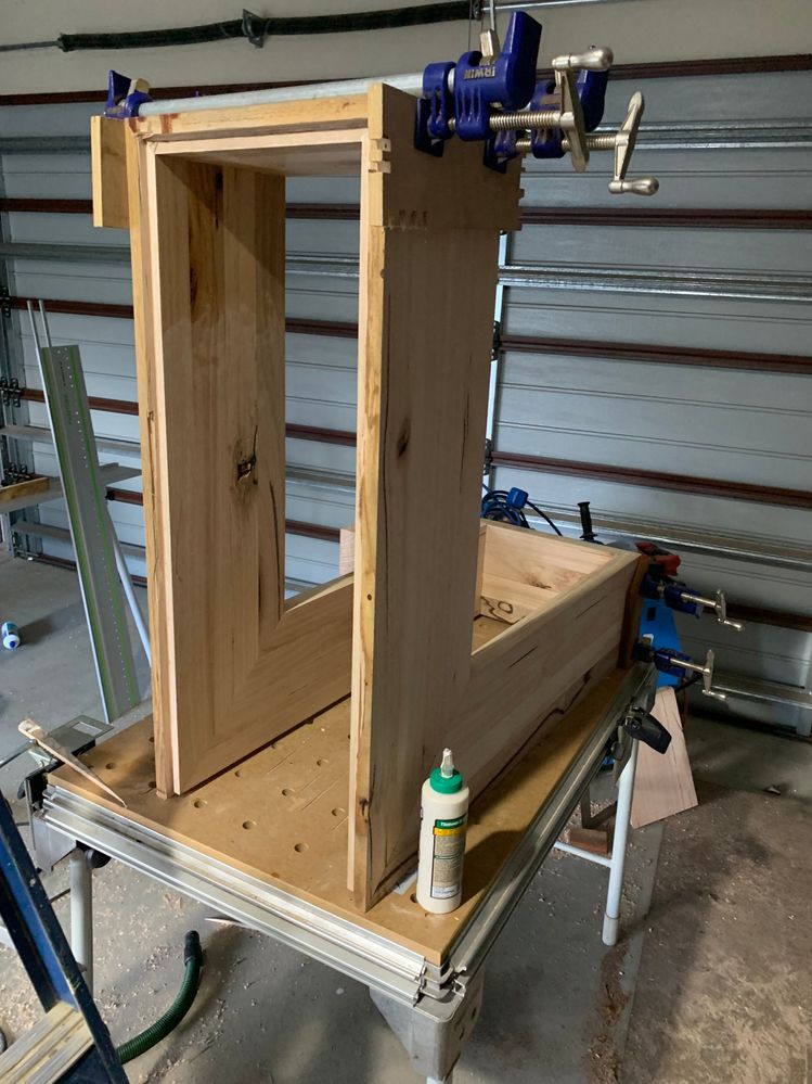

Glued and clamped.
False back attached.

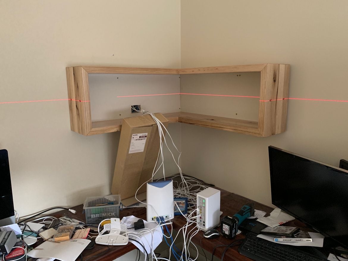

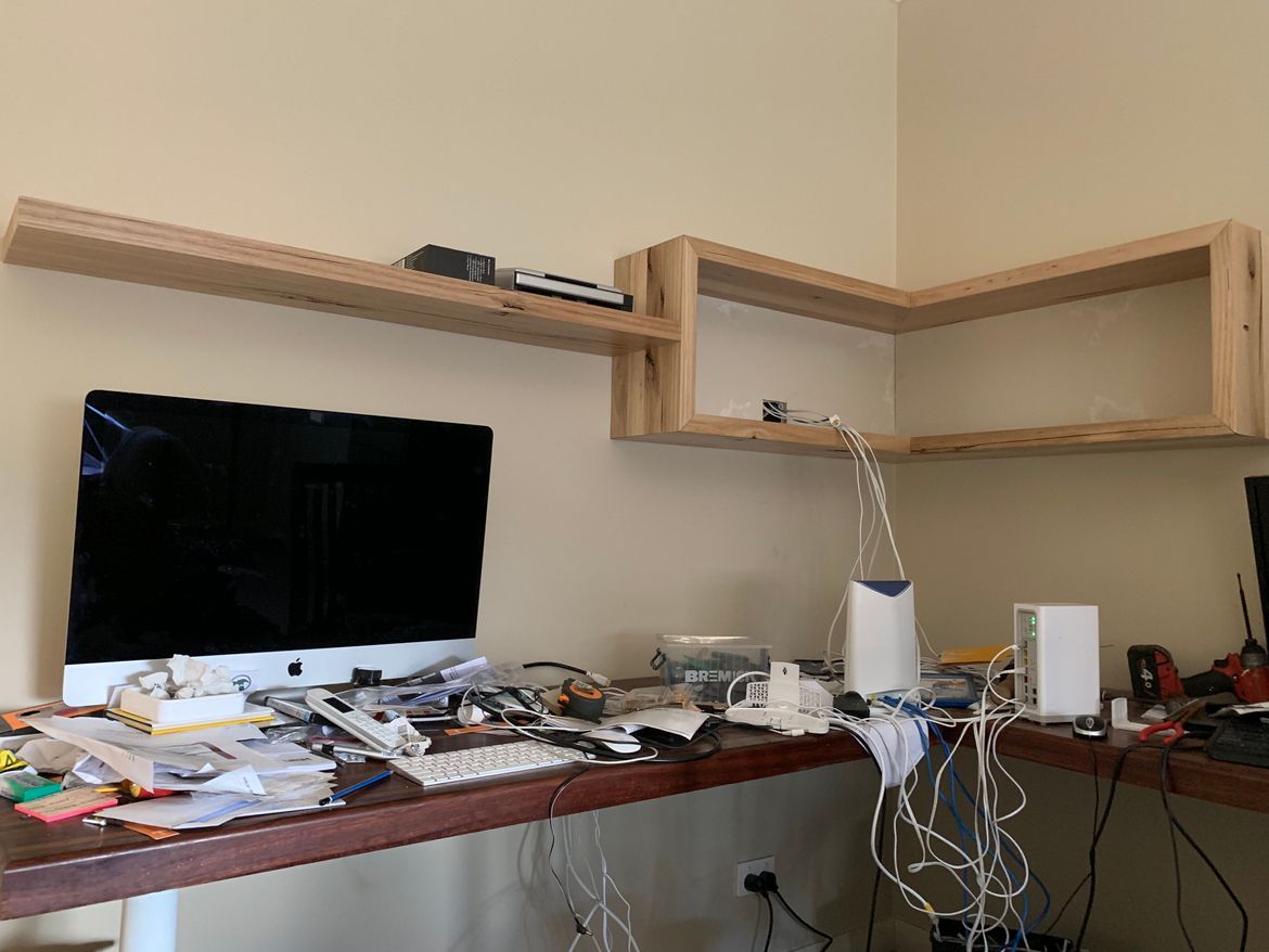

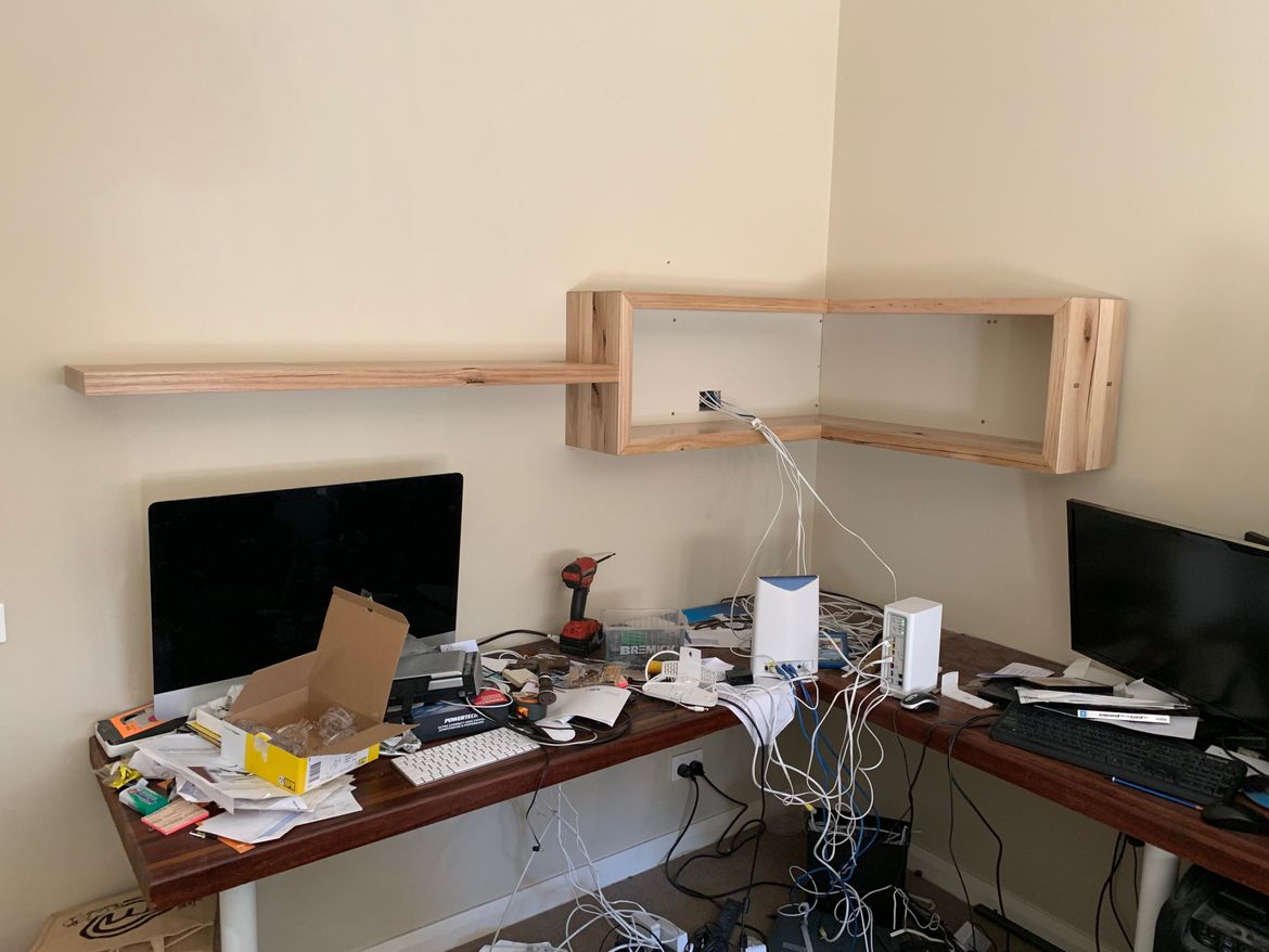

In position and level. The false back makes it easy to attach to the wall and appear to be floating.
Single shelf attached.

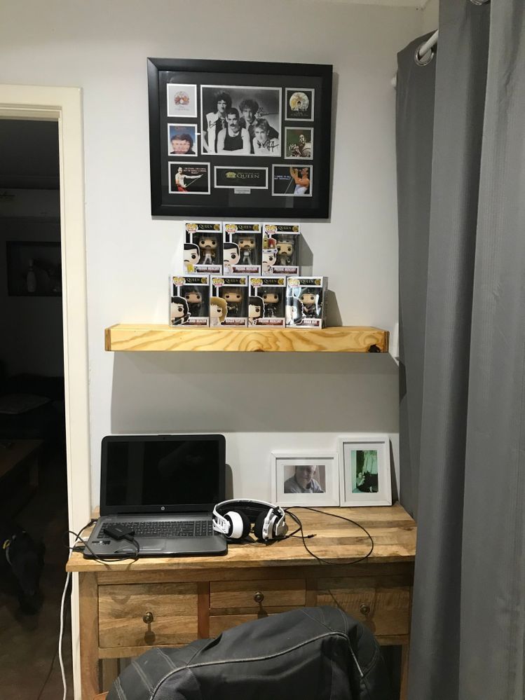

Workshop member Pete built this custom floating timber shelf for his son’s nursery that sits above an antique dresser perfectly colour matched to the wallpaper on the opposite wall.
