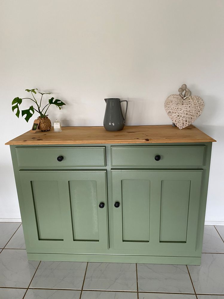

By lightly distressing fresh paint and adding vintage handles, prettyliving completely changed the look of this buffet.
