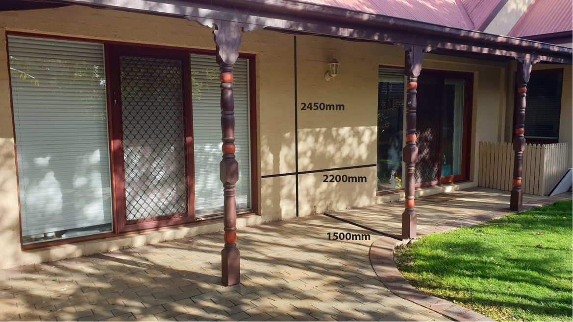

I am looking to convert this space into an outdoor BBQ/entertainment area with a built in BBQ and an outdoor drinks fridge. No sink for the moment, but might think of adding one later if necessary.

Are there any special considerations for this kind of project in this space? Particularly ventilation, moisture etc. The dimensions of the space are in the photo below.

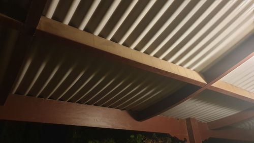

Thank you for the quick response and update. I will include the details you've mentioned in my suggested plan. I only recommend putting a rangehood in to prevent grease build-up on the bottom of the corrugated roofing. I will show it in my drawing and leave the choice up to you.

Thank you for your comments and offering to draw up a design. The layout I had in mind was pretty straightforward - similar to the picture below. I am having an external powerpoint installed a little above ground level, below the existing light.
For the base, I was thinking of building a simple cabinet with marine ply for the fridge and timber frame using this 70x35 before cladding with cement sheet and attaching the stone. This would probably cover the moisture issue?
For ventilation, is there a guideline about minimum clearance before needing to install a rangehood? Because the alfresco roof doesnt have a ceiling as such and there is a bit of a curve to it, I'm not sure if it's possible to install a rangehood in that particular space. I have attached a picture below.
