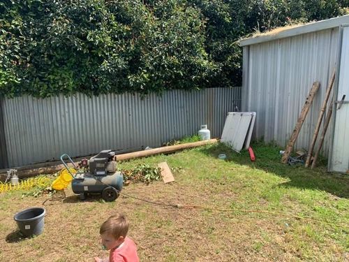

I had this empty space that I wanted to convert into a cosy corner. I also wanted a simple project so besser blocks to the rescue.

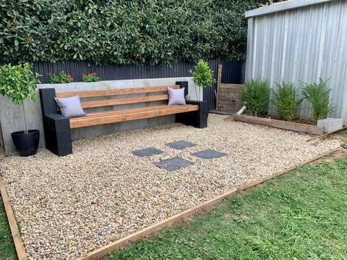

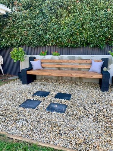

Finished result
empty backyard space

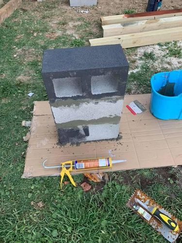

For this project I used 14 besser blocks, 7 for each side. I used liquid nails for cement and attached 3 blocks on top of each other, only exposing the top holes (shown in picture below). I repeated this for the other 3 blocks. This process was just easier for me to move by myself to get the correct position.
I did this for the opposite side of my chair, leaving only 2 blocks for the top. Once I had the correct length I wanted, I glued the middle of the blocks (3x3). The last block was also glued to the top so the holes ran in the same direction.

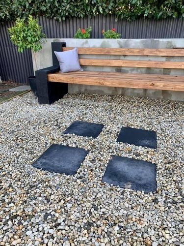

I purchased 100x100 sawn pine posts and sanded and stained. It was as easy as slotting the posts into the blocks.
The back planter was made by attaching fibre cement sheeting to a frame. This was an idea I got from Bunnings ‘how to build a concrete look bench’.
The fence and besser blocks are painted in the colour monument, added some paving slabs and stones. The side gate was made with pallet wood. Now all I need is a Fire pit!
