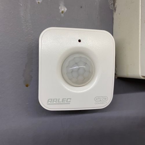

I have recently got the sensor pack from bunnings (incl. the hub, door sensor, climate sensor etc.). All works good.

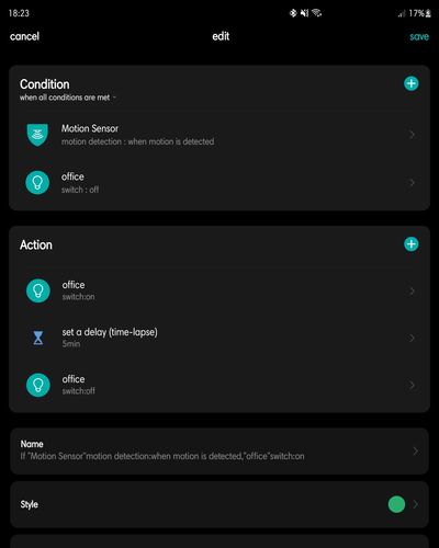

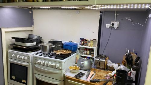

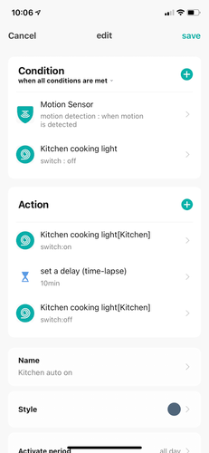

The real problem comes in with the motion sensor. We've got one to turn on an under-bench light for cooking in the kitchen. An automation then turns if off after 5 minutes after detecting no motion. The issue is if you are in the kitchen for a half an hour or so preparing dinner, it will detect multiple 'motions' (of course) but then try and turn on while it is evidently activating a no motion detection from 5 minutes ago, so turns on and off randomly in quick succession. Putting in larger delay, say 30 mins, would still be a problem as the kitchen is frequented throughout the day.
If there was an option in the Automation to 'deactivate' the motion sensor while the light is on, that would fix it (I think). Alas, that doesn't seem to exist.
