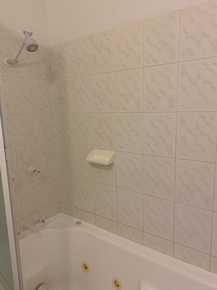

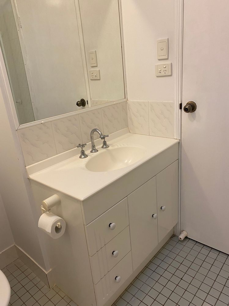

This time I used the Dulux Renovation Range, using the white colour off the shelf with no tinting. My existing tiles were an off white colour with grey marbling.
I started by cleaning the tiles with a green scourer to ensure there was no soap residue. I then used my trusty Ozito 18V Detail Sander with 120 grit, followed by a light hand sand with 400 grit.

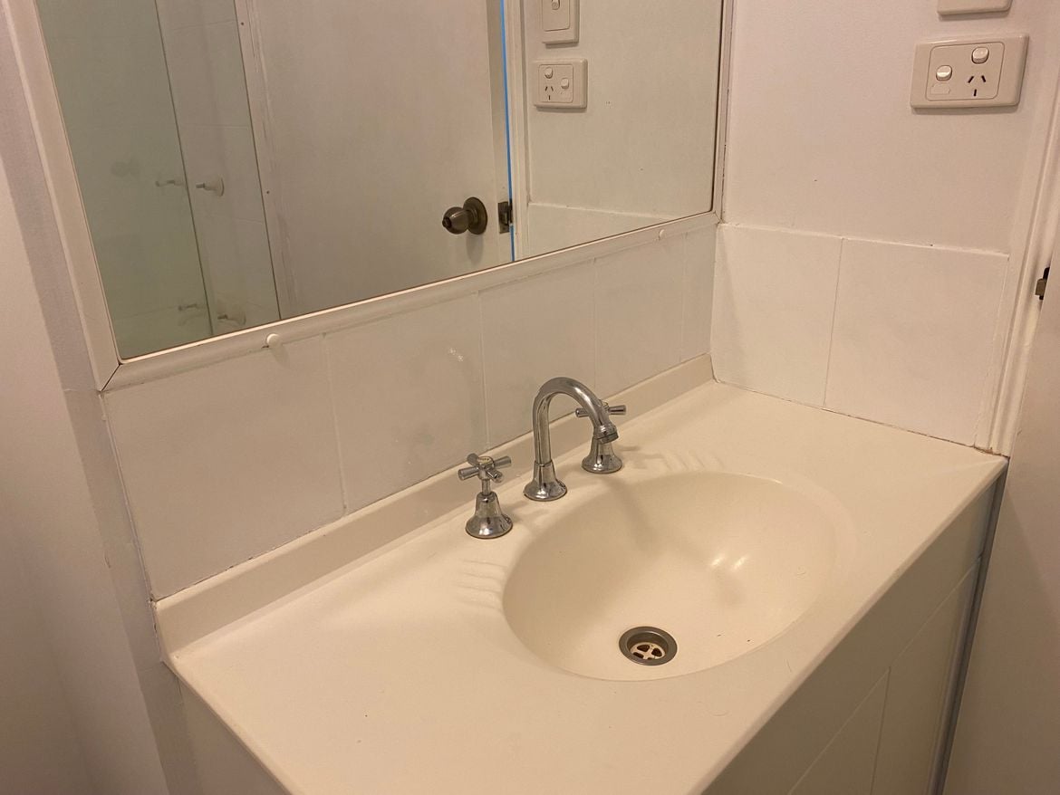

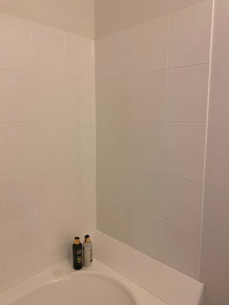

That's it! It was easy to use and easy to do. My result is not as dramatic as others as my tiles were a lightish colour anyway, but I'm ecstatic with the result which is way better than the photos show. It's a real brightener and the tiles look new.
One month on, they are still looking great and I have just done my ensuite as well. I've also added white silicone to the corners and edges, which has really added a professional finish. I use a soft sponge instead of a scourer type sponge to clean. I am quick to spot clean as I'm still keen for them to look perfect, so nothing really sets in that requires scrubbing.
