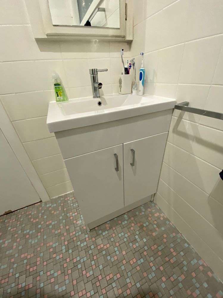

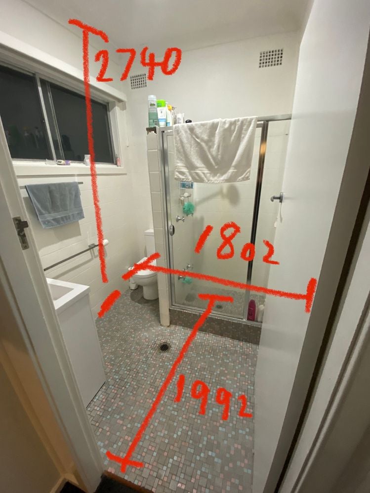

Our existing bathroom was not as old as the original 1950s house, but probably dates back to the 80s or 90s. The back portion of our house where this bathroom is used to be a granny flat and was probably constructed in the 80s, but then joined onto the main house in the 90s. The bathroom is only 1800mm x 1900mm and includes a shower, vanity basin and toilet.
The objectives for this project were:
- Retain the existing basic layout as the floor penetrations could not be changed.
- Demolish the blade wall between the shower and WC – this would provide an additional 100mm width in the shower, and also open up the room.
- Relocate the shower head and tapware to the opposite side of the shower as the existing taps were on the blade wall that was demolished.
- Improve ventilation – the previous bathroom only had a low-powered, poor quality fan.

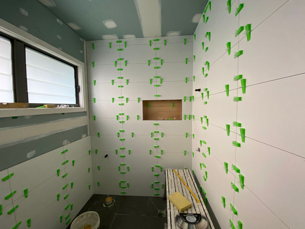

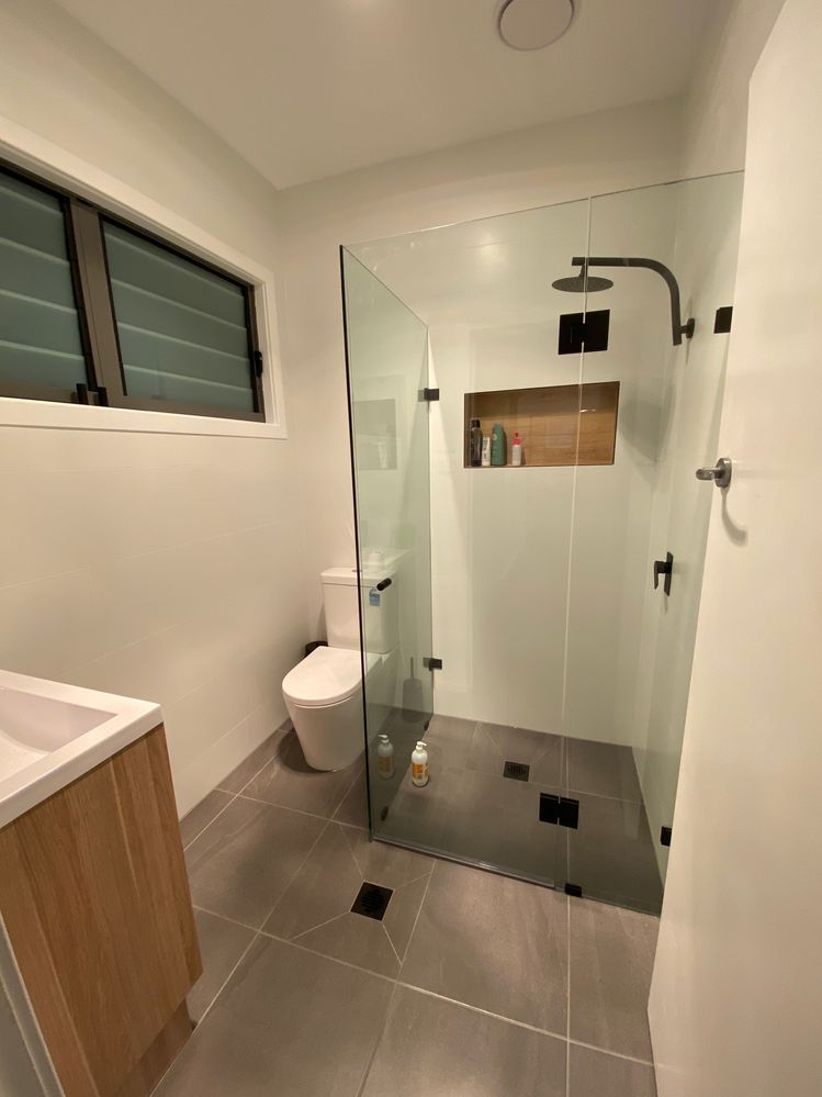

I like the timber-grain laminex look as long as its not overused. I also think that some feature tiling has a tendency to get dated fast, so I opted for plain white matte wall tiles all around, but with a tiled shower niche.
I was very lucky to find a timber-look tile that matched perfectly with a laminex natural Oak. I was satisfied that using the laminex on the vanity and the timber tile inside the shower niche would provide enough of a feature against the plan white wall tiles and grey floor tiles.

- Earp Bros Tiles White Matt 600 x 300 wall tile
- Earp Bros Tiles Minnesota Cream 1500 x 250 timber tile
- Earp Bros Tiles Alps Dark Grey 450 x 450 floor tile
- Custom made vanity and mirror shaving cabinet using natural Oak laminex
- Bunnings shower head, taps, basin mixer, toilet
- 10mm toughened frameless glass shower screen with black patch fittings
- In-line extraction fan. I opted for a separate extraction fan, not the IXL 3-in-1 with fan included -because I wanted to ensure the best possible ventilation.
- IXL (heat and light) 2-in-1
