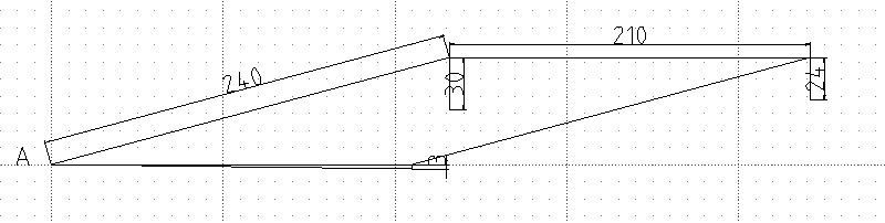

I came across this post for the preparation for the creation of a Bathhouse on a deck.
Does this rule apply for strirup posts as well?
i.e The overall size of the deck is 2400 x 2100mm
I plan to use 3 bearers with metal strirup posts at end and one in the middle
thus 9 posts.
The drop across the ground is 300mm max at one end only (sloped ground)
Plan to use double joists under the bathtub, located on one side of the flooring
and 900mm x 2400mm toungue and groove flooring
So if i used the 600mm posts, that would put it 300mm in the ground at one end.
Appreciate any feedback.

It's great that you've received excellent advice from @Brad. I totally agree with his suggestion of at least 1/2 the length or more. I subscribe to over-engineering and would probably go past the 300mm as well for safety. Would it be possible for you to post a photo of your plan? It would give us an idea of the layout and provide you with a comprehensive recommendation. It sounds like a fantastic project, any updates you can provide while building the deck would be much appreciated.
