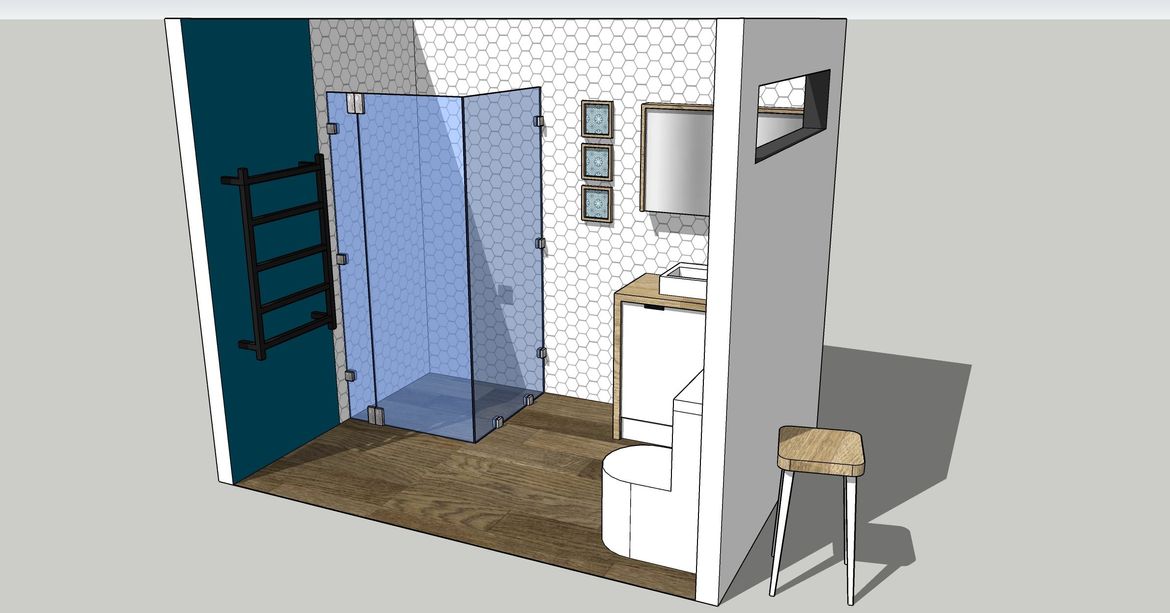

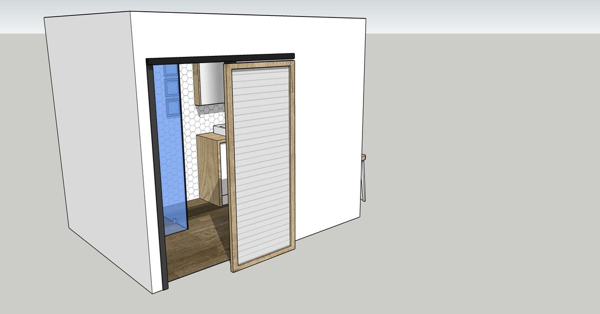

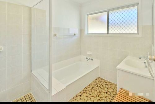

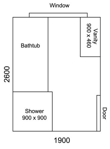

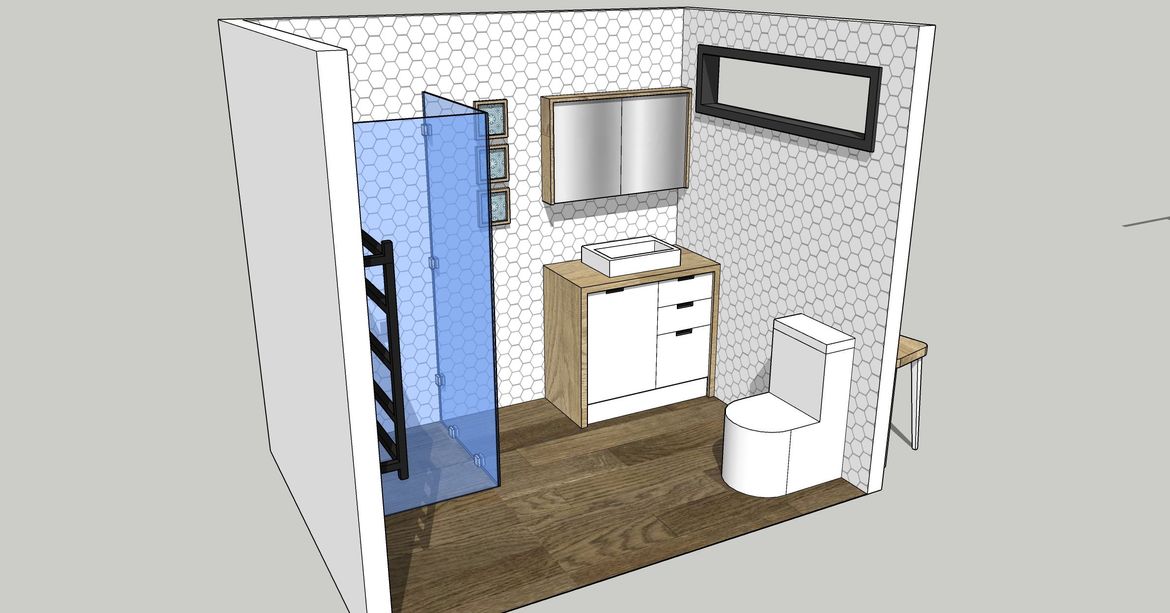

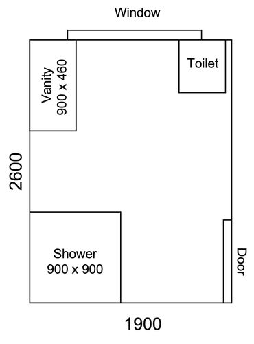

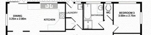

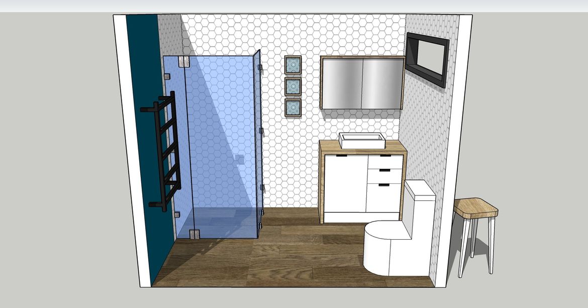

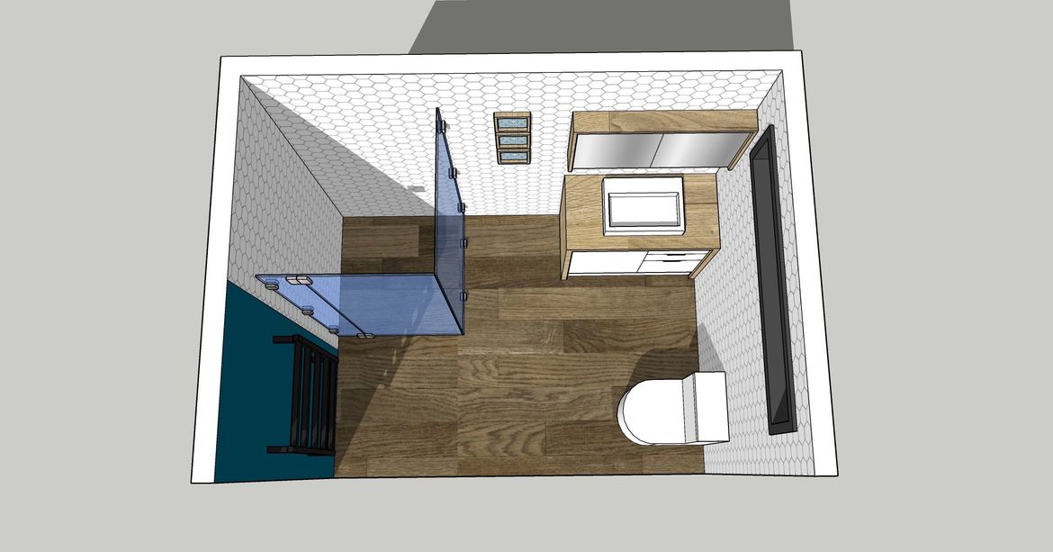

Our house is a 3 bed 1 bath place, with the toilet seperate from the bathroom. We're thinking of updating the bathroom, and at the same time remove the bathtub and replace it with a toilet. I've attached some photos of the floorplan, the current bathroom, and some diagrams of the current and possible new layouts.
We were thinking of moving the vanity across to the other wall, and put a toilet at the corner instead. A shaving cabinet from IKEA (https://www.ikea.com/au/en/p/enhet-mirror-cabinet-with-2-doors-white-s19396572/) would go above the 900mm vanity.
We'd probably replace the current shower screen with a semi-frameless one, with the door opening out towards the vanity (or sliding doors if possible). Towel rails will go between the vanity and shower screen, or possibly between the toilet and the door.
For the floor, we were thinking grey-ish tiles, with glossy white large rectangle tiles (not subway tiles) for the walls (probably all the way to the ceiling?).
How does that sound? This is the first major renovation we're going to do (technically we're just paying, getting a company in to do the actual work lol), and would appreciate any advice on anything we may have missed. Thanks!
Current:
New:
Floorplan:
Photo (from when we bought the house, there's a lot more clothes and stuff lying around now.... lol):
