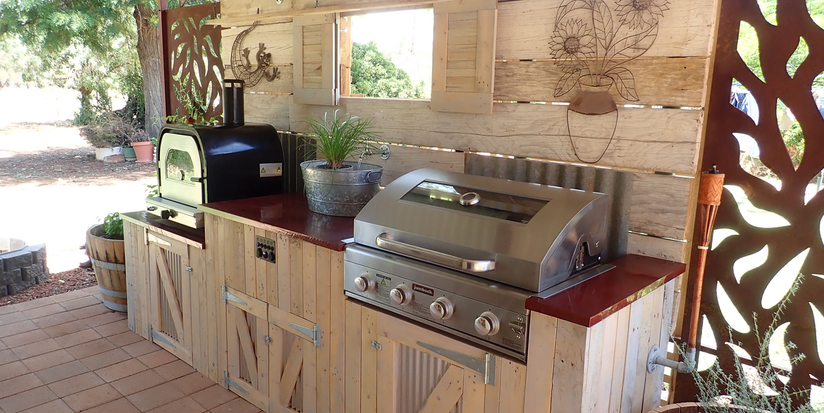

I found a lot of free timber online. The wall of the barbecue area is old scaffolding boards, and the outside of the barbecue area was made using recycled pallets. The iron sheets were already in the backyard here.
The fibre cement sheeting around the seating area wasn't great, so I made a treated Pine frame and covered it in with fence palings.
I have a couple of solar panels and batteries for camping and found a 12v bluetooth amplifier. I put a strip of Arlec 12v puck lights over the barbecue and over the table. I also installed a water feature, fairy lights and an amp for music or podcasts.

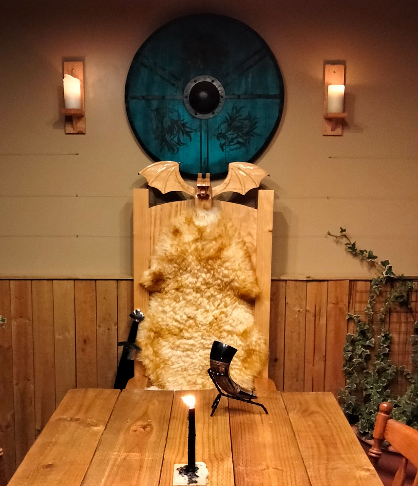

My trip to Iceland got me into Vikings, so I used pallets to make a shield and a dragon throne.
I made the dragon with a scroll saw and a Dremel, and then used pyrography tools to add colour.
