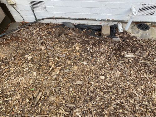

I bought this house recently. If I don’t plan to plant anything here, do I have to remove the mulch ? Will this mulch attract termites? Thank you.

Are you in a termite prone area? If not, then the mulch is just an aesthetic product for covering the soil. You might like to rejuvenate it with some new mulch as it looks reasonably aged.
If you are in a termite prone area and see no need for the mulch, you can remove it. It's never a good idea to place mulch up against a dwelling if there is a chance of termite infestation.
Hi charlotte1 . Mulch is mainly used to keep weeds down and to help garden plants by retaining moisture so the soil doesn't dry out. If you remove the mulch you might find your garden beds quickly being overtaken by weeds!
If it's the look of the mulch that bothers you, you could try a wood mulch of a different colour, or use pebbles or other small stones as mulch. Pebbles and stones create a striking effect and will not attract termites. (Pest-control experts also recommend mulches made of cypress heartwood, cedar and tea-tree, which are all said to repel termites). If you're in a termite-prone area it's worth having a pest controller set and regularly check termite bait stations around your house.
You might also want to keep an open mind about planting something in your raised garden bed. Some hardy, low-maintenance plants suitable for your area would add some nice green for you to enjoy as you look out your windows or walk past.

Hi @charlotte1 if you're not in a termite-prone area I wouldn't be too worried. The walls painted white below the vents help too as any termite 'gantries' would be visible if they tried to enter (they would look like semi-circular lines of dirt as they build tunnels on a surface).If you did want to top that mulch up use a Cypress mulch as it is considered termite repellent. Tea tree much is also said to be the same but I'm not a fan of its twiggy look.
