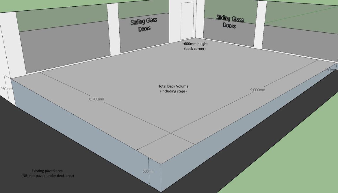

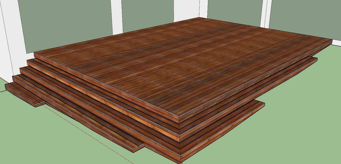

I'm wanting to do a DIY deck (about 6m x 9m) for my L-shaped brick veneer house in Canberra. I have never built a deck before. I'm wanting to design the deck in CAD before starting. I have a lot of (really) basic questions, but will start with the ledger.
Building a rectangular deck for an L-shaped house, both bearers and joists will be abutting the house. Do I put in a ledger for (a) both joists & bearers, or (b) just the joists? If the latter (b), I'm confused about how to position the posts to support the bearer ends close to the house; presumably they'd need a post right up close to the house, yes?
I was going to affix 90 x 45mm ledger(s) (or is that too small?) to the house using Ramset 100mm Galvanised AnkaScrew Masonry Anchor, with screws every 300mm.
