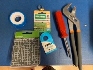

So it appears that a lot of the old products recommended in previous posts have been discontinued and when I visited bunnings I was told to cut my inlet hose but it’s barely long enough as it is. So I used my big brain and came up with the following. Aerator adapter kit (plumbing section), nylex sprinkler adapter, 2 barbed connectors, and 2 it hose clamp things (all from the gardening section) and about 15 cm of hose from my garden (photos below for reference)

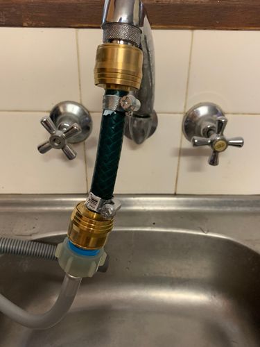

this is how I hooked mine up. Fancy it is not but functional it is. Aerator adapter and nipple to the faucet. The barbed connectors in each end of the hose with the clampy things, and the nylex sprinkler adapter screws into the machine hose.
