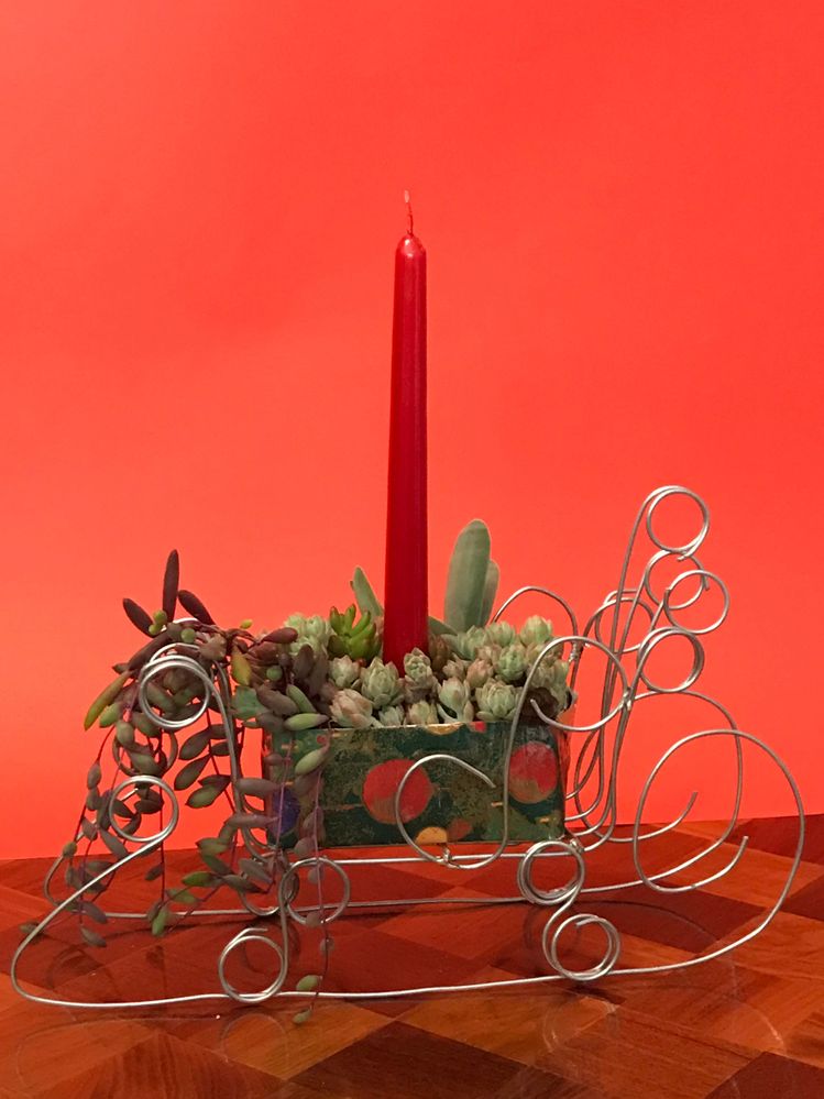

Making a sleigh from wire sold at Bunnings. Note, keep the material clear of candles, don't leave them unattended.
With succulents. The problem, is if multiple candles are used, people will bet on with candle causes the rest to catch fire first.

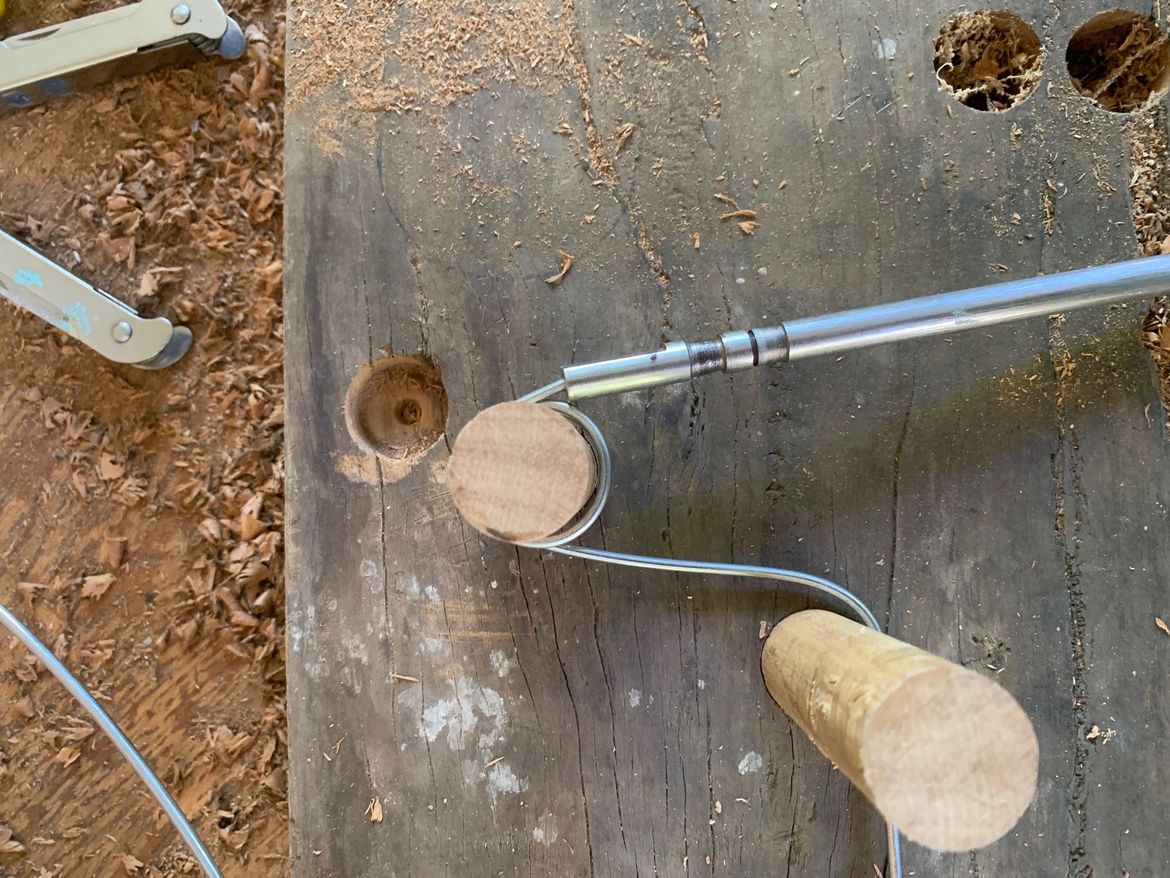

Bending the wire segments. After bending the wire with pliers, it was found that the lengths wouldn't be the same. Hence, here, 22mm holes have been drilled with a spade bit, and 22mm dowel used. The segents will be the right lengths.

It was found, that a rod with a hold drilled in the end was handy. The wire could be caught in the rod, and actively wound around the dowel.

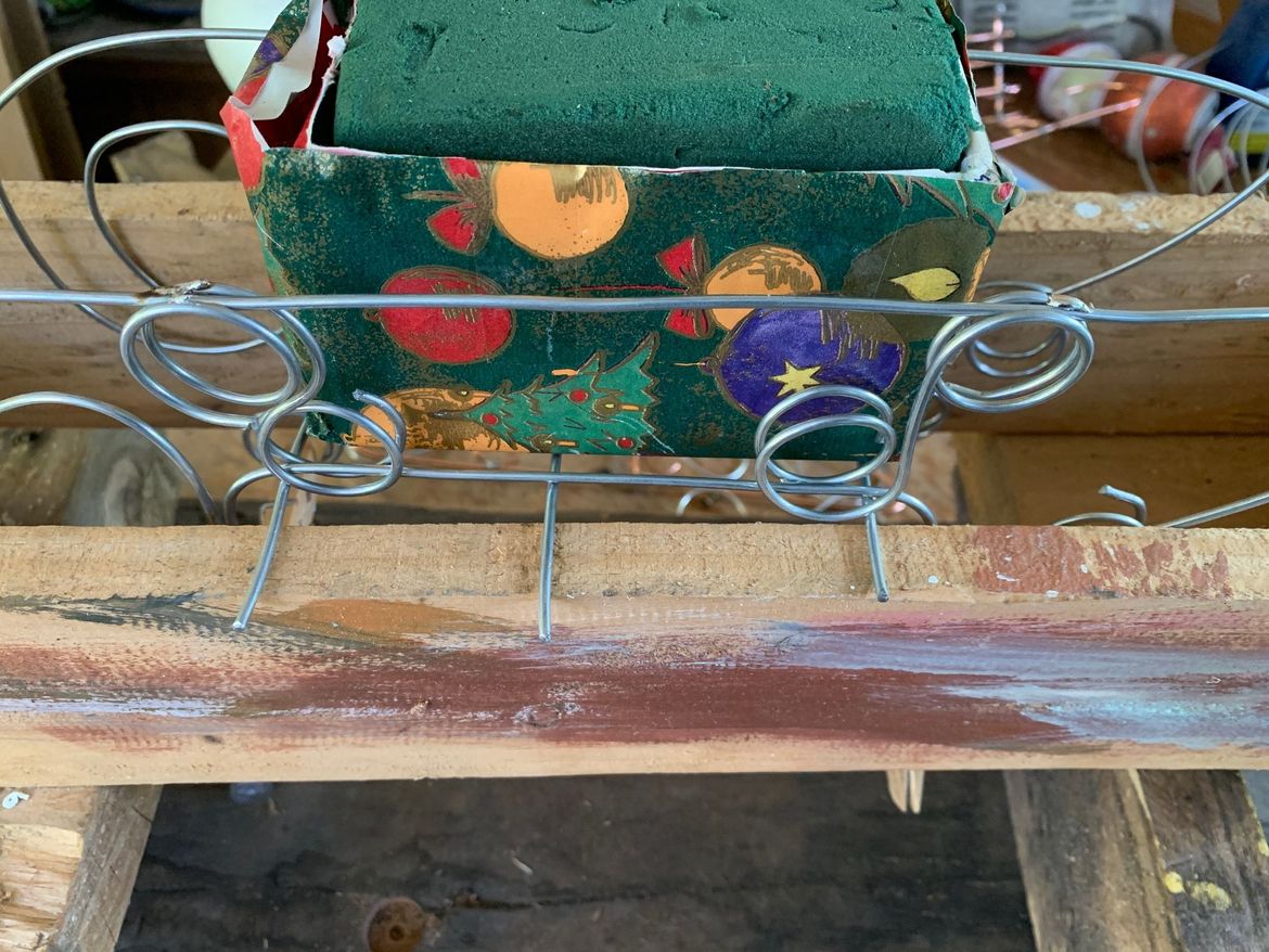

For a container, a milk drink container. Here, the width of the sleigh is adjusted to suit the container.

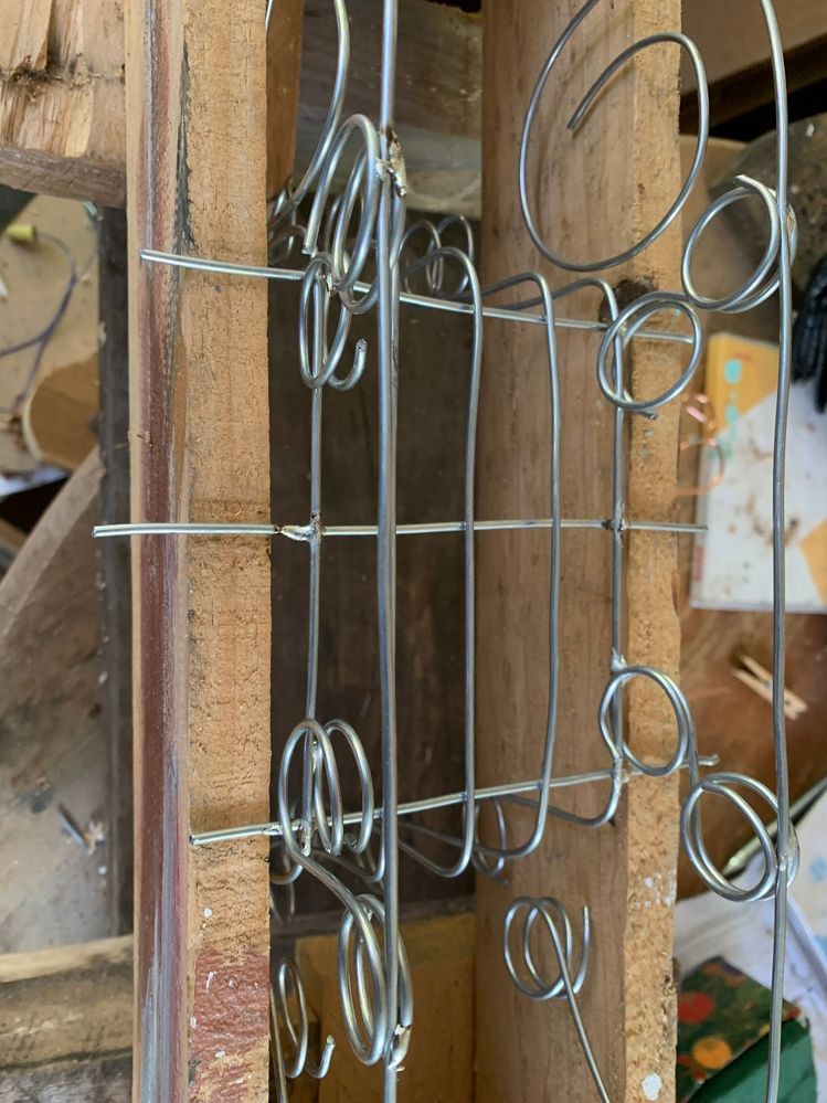

Using the end of a pallet, and hanging the items that need to sit vertically.
Another photo, if the sides don't hang perpendicular, to the cross members, pegs can be used as weights.
Now for the arrangement. If using flowers, there is floral art foam. Notice that the top of the foam is above the edge.
