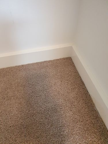

How can I remove these base boards and what tools should I need ?
I'm trying to fit shelving unit here (In wardrobe) so that it is flush to the wall

I've never tried this - but my neighbour has.
A 'super' magnet locates the nail head.
With a small chisel chip away enough wood so that a pincer can remove the nail.
With a Stanley knife - break the paint seal between the wall and wood.
The skirting board should just now come away from the wall.

It's great that you've received excellent advice from @Noyade. Unfortunately, some damage will occur despite our best efforts to not damage the plaster wall. The best thing we can do is to choose carefully where we place our Craftright 380mm Wrecking Bar. This is so that we can minimize the amount of damage we will be applying to the plaster wall. If you are trying to fit your furniture against the wall, I suggest using a Multi-tool with a Diablo 65mm Multi-Tool Plunge Blade. This will let you cut the skirting board without removing the entire length. Be careful not to plunge too deeply or you will cut the plaster as well.

Going down the pry bar path - I highly recommend the Crescent multi-position head bar. It has a long flat and narrow head good for getting behind the skirting board and by adjusting the head angle you get powerful leverage.

I had the same problem, we had to install some Ikea wardrobes, and the skirting needed to be removed. The first step was to run a retractable knife along the top edge of the skirting board. This should reduce any paint being pulled away as you remove the board. In the next step, I just used a chisel and mallet to pry an opening, then I just grabbed one end of the skirting and pull it away from the wall. There was a small hole left by the chisel and that was easily repaired. Good luck.
