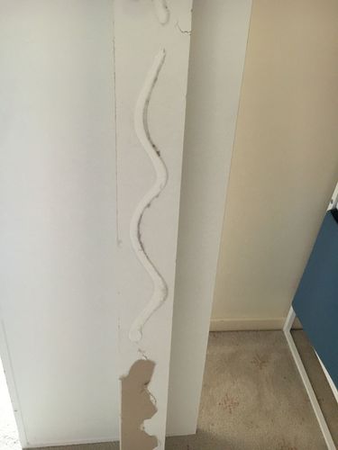

1. I removed the shelf in the first wardrobe using a pry bar and stanley knife. It turned out the shelf supports were attached to the wall by a liberal amount of construction adhesive as well as screws. As a result some paint and cardboard was ripped off the wall when the shelf was removed (see pic). What is the best product/method to repair this?
Damaged wall in wardrobe
Glue on the back of shelf support
2. I would like to avoid damaging the wall to the second wardrobe if possible when removing the shelf supports. Any suggestions for how to best do this? I read that you can slide a piece of wire between the wood and the wall to cut through the adhesive - is there any product which would be best for this?
