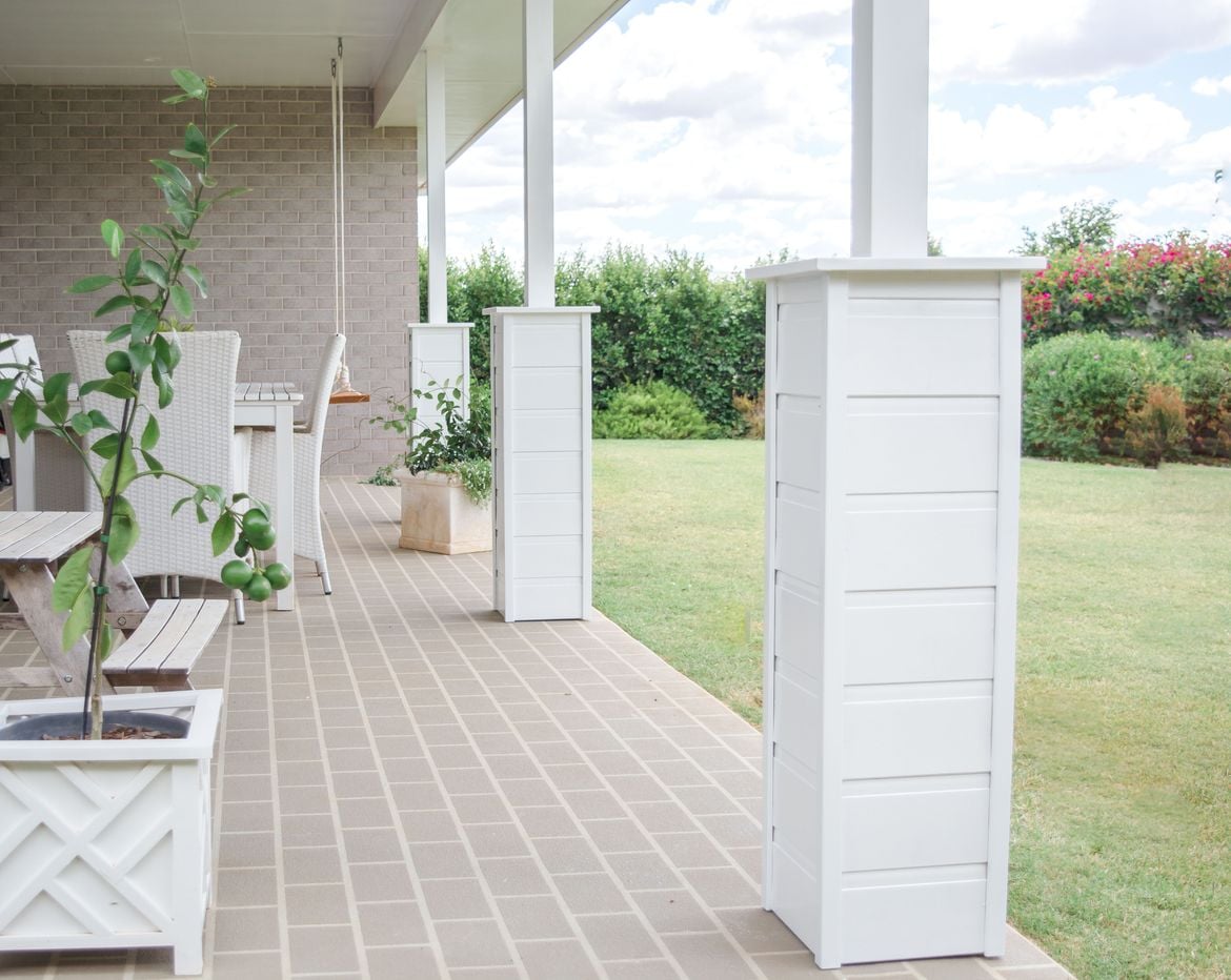

We turned our skinny verandah posts into something pretty amazing with a Hamptons look.
We have a 6–10mm gap so it allows for both ventilation and water run off. The new structure does not touch the ground and the original stirrup is still in place, which prevents termites climbing.

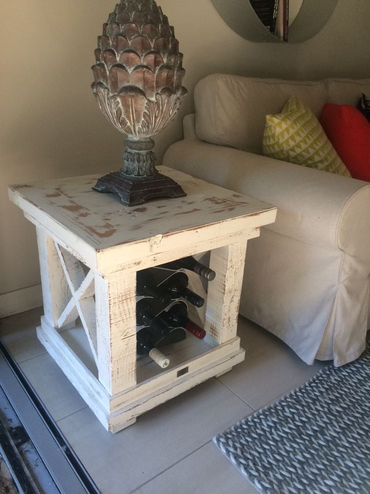

Workshop member Beachbox built this lamp table using recycled Oregon timber and painted in antique white for a Hamptons look.
