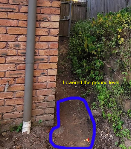

At first we thought its happens because the finished ground level of the yard is too high (higher than bedroom floor). But after we took out the soil lowering the ground level, the problem still persists.
Visually we do not see any brick wall cracks.

1) There is only a rainwater drainage downpipe near that corner. No sanitary drainage pipe. And we installed a new downpipe to make sure there wont be water spilling out from the underground pipe.

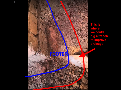

2) We understand that upgrading the drainage system can help (There is an old AG drainage system alongside the house).

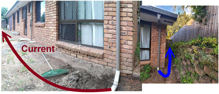

3) We regraded the side aisle of the house to make sure the water can flow away from that corner. But things only improved a little.
Isnt the first thing we need to do is directly addressing the problem : the leaking slab?
We watched youtube and some companies applied the liquid rubber to the sides of the concrete slab, like this:
It seems much more effective and on point? If there are some "hairline" crack around the corner of the slab, put something to seal them seems to make more sense.
