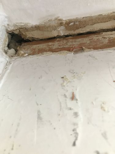

Ok, I have started removing the skirting board and it looks like I’m going to expose some concrete/brick once board and pelmet has been removed. I’ve attached photo of where I’m at now.
@TedBear , @EricL would love your advice again. Can I keep going and fill in the brick/concrete myself? I have extra paint etc and can be guided on what to use to fill the gap. Or, do I need to call a professional? Eek!
Hi @Becshouse I am curious as to @EricL 's views on this,
but zooming in on your photos it looks like you are dealing with a plaster and lathe ceiling and that the "pelmet" may be the support for this end of it, rather than being an optional addition.
I would recommend not going any further and get a ceiling expert in to assess what your best options are.
Try to find an older one, who has had experience with plaster and lathe ceilings. Otherwise you may get a "tear it all down and replace with modern plaster board" approach. (Easiest for them, expensive for you.)
Although, that may be an option that you are ok with... is there any character in the room that you want to keep?

Thanks for your comments. I will try to tap the skirting board back in place, paint over my my scratches and pop it in the too hard basket. Hopefully I haven't done any major damage and the ceiling won't fall down!
