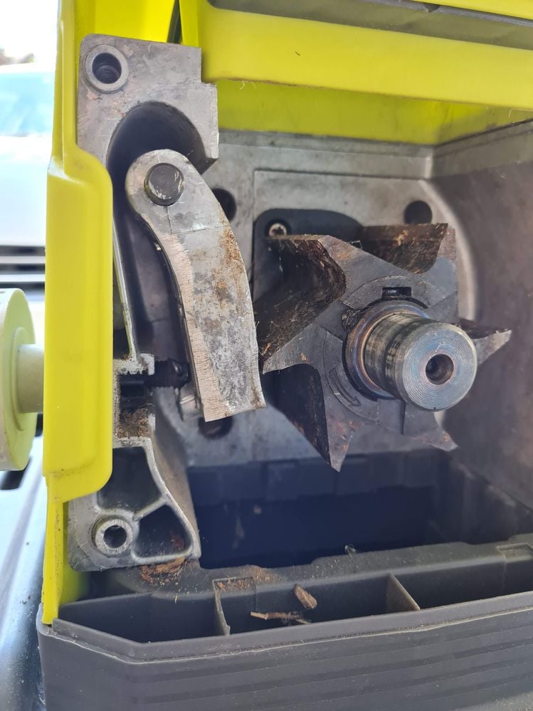

I purchased this Ryobi electric shredder 2nd hand, and it's not working as it should. The model number is RSH2445T. Apparently they are very good shredders, but mine is not cutting right through the material that goes into it.
I'm looking for help on how to proceed with getting it repaired.

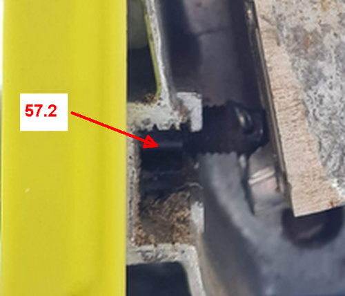

A photo of the inside of the shredder is below. The piece of thick aluminium levered up to where the blades spin is the adjustment plate. The plate should be adjusted to just touch the blades, at which point a small amount of aluminium should be shaved off and the shredder should operate beautifully from that point on. The green knob partially shown on the left side of the photo is used to push the adjustment plate in further. Once adjusted, the knob gets locked into place with a locking knob. The issue in this case is that the adjustment plate cannot be pushed any further in, as the knob is at the end of its position. If the adjustment plate was wearing thin, I'd expect it to need replacing, but it's barely been worn down, so I doubt that's the problem. Instead, I'm wondering if something has perhaps broken off the end of the bolt that pushes against the adjustment plate. The end of the bolt has a hole in it with some wire through it, and that looks like it might have been messed with or damaged.
If anyone has a similar shredder, perhaps it could help to look at how the adjustment bolt works, whether there is a part missing, etc. Ultimately, if the bolt was perhaps 10mm longer, I wouldn't have a problem, so there may be other ways to achieve something like that. Thanks in advance for any help!
