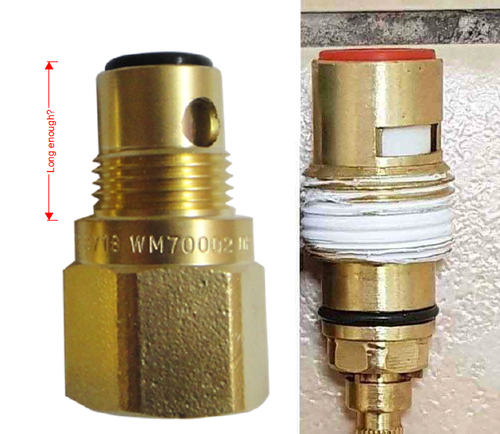

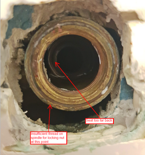

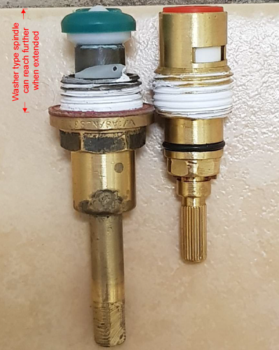

The problem I think I am having is that the existing seat is too far back. So when the base of the spindle is snug in the seat, there is insufficient threads left on the spindle for the locking nut. This did not seem to be a problem for the previous washer-type spindle as it could extend further, see diagrams/photos below.
Is anyone aware of a spindle extender that would work here? I have not been able to find a suitable one. Or is there a different approach I might be able to take? Would be great if I didn't have to revert back to handles with washer-type spindles.
